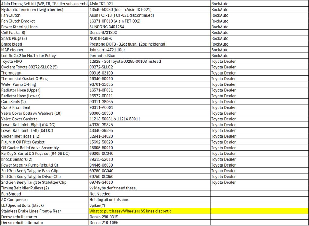

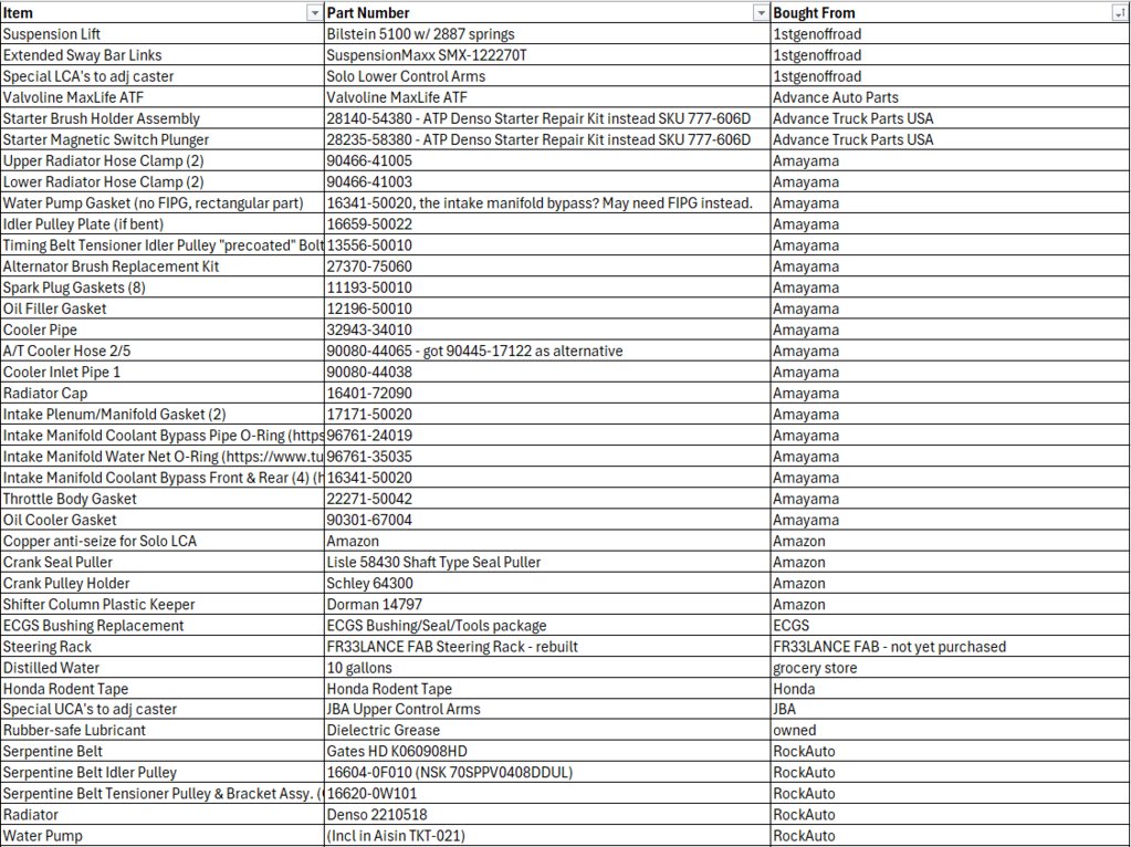

    Getting ready to do "the big job." Finally going to bite the bullet and do what I've been putting off for a looong time. Need to maximize caster on the driver side due to a collision a few years ago that bent my front sub-frame rearward forcing negative caster even with maximized alignment. Also gotta do timing belt, refresh everything else in the engine if possible. The truck will be torn down for at least a few weeks if not longer since this will take me a while, fully intending on not having it in driving-shape for a longish time. I've never done any timing belt/rad/fan/AC stuff before but am confident I can do the job, I just don't know what I don't know or what I'm missing.
    The below is the parts list I've compiled for now. Blanks are parts that I haven't figured out the part numbers for. I'm hoping this will be useful for all of the forum too.
    Do you guys see anything I'm missing? Got anything wrong? Any advice on what I also might need to change? Like do I need to replace the AC Compressor or Power Steering Pump?

    Everything will be coming from Rockauto, amayama, toyotapartsdeal, and 1stgenoffroad, no fleabay or scamazon.
    Hit me with criticism too fellas
    Edit: no toyotapartsdeal, bad reviews led me away
    Also ordered:
    - new cam bolts set from Bison Off Road.
    - a lot more stuff in the list from the dealer than expected since I couldn't find it on amayama/rockauto
    - new torque wrench that goes high enough for wheel castle nut and steering rack

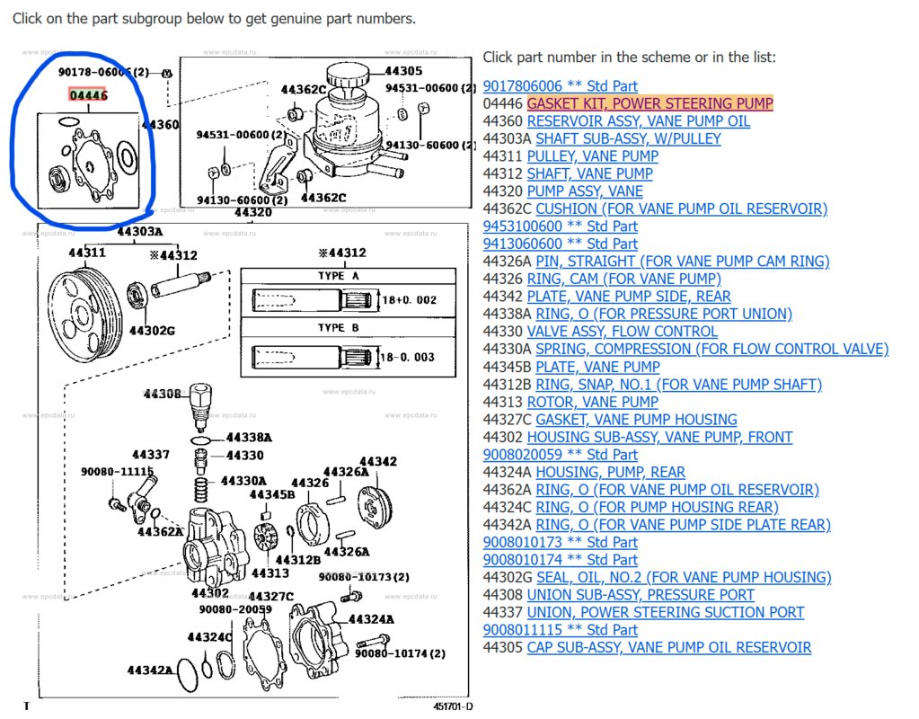

    I believe there is a "rebuild" kit for the power steering pump. It looks like it's just a bunch of seals, but the part number is 04446-06030.
    Also, there is a screen at the bottom of the PS reservoir that fills up with gunk over time. I purchased a new/used PS reservoir that only had like 40k miles on it, and a crazy amount of gunk came out of the screen. Pics HERE. I'd bet cleaning out that screen at the bottom would free up a lot of flow. I also solved my PS leaks by just replacing the hose clamps.

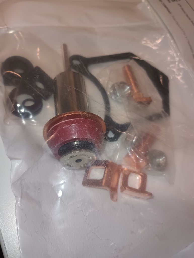

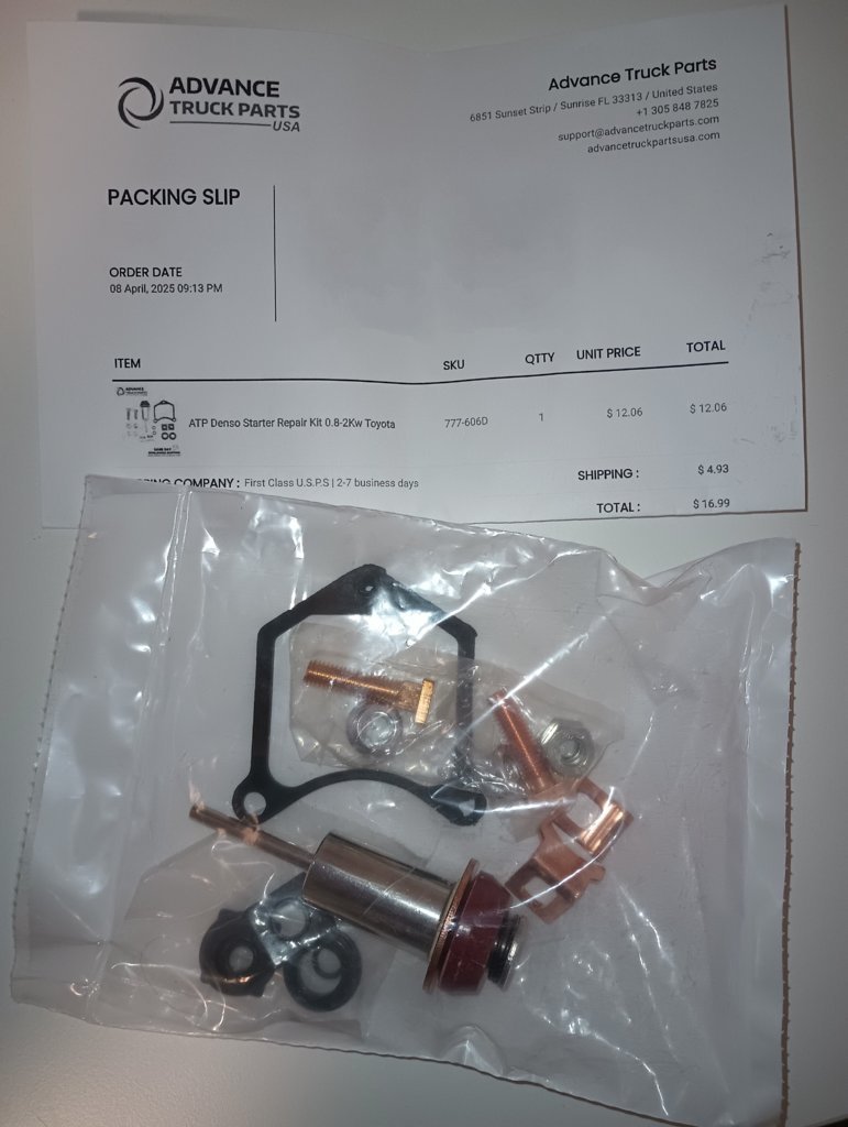

    First of the parts rolled in. Starter rebuild kit from Advance Truck Parts called ATP Denso Starter Repair Kit 0.8-2Kw Toyota. SKU 777-606D. I had trouble finding an "official" rebuild kit on the Toyota site since it's not the most clear as to exactly what I'd have ordered, and certainly couldn't find one on Denso's website either.
    @KNABORES does this look like the rebuild parts you've been using?
  27. Apr 15, 2025 at 5:28 AM
    #27
    KNABORES
    KNABORES Sarcasm incoming
    Jan 1, 2020
    #40572
    14,469
    Arkansas
    Similar parts, but I orders them ala cart from Toyota. Plunger, copper contacts with new bolts and the gasket.

    Fan Clutch Bracket → 16371-0F010 (Aisin FBT-002) → RockAuto
    Fan Shroud → Not Needed →
    Figure 8 Oil Filter Gasket → 15692-50020 → Toyota Dealer
    Honda Rodent Tape → Honda Rodent Tape → Honda
    Hydraulic Tensioner (twig n berries) → 13540-50030 (Incl in Aisin TKT-021) → RockAuto
    Idler Pulley Plate (if bent) → 16659-50022 → Amayama
    Intake Manifold Coolant Bypass Front & Rear (4) (https://www.tundras.com/threads/coolant-leak-bypass-pipe-o-ring.81275/#post-2055606) → 16341-50020 → Amayama
    Intake Manifold Coolant Bypass Pipe O-Ring (https://www.tundras.com/threads/coolant-leak-bypass-pipe-o-ring.81275/#post-2055606) → 96761-24019 → Amayama
    Intake Manifold Water Net O-Ring (https://www.tundras.com/threads/coolant-leak-bypass-pipe-o-ring.81275/#post-2055606) → 96761-35035 → Amayama
    Intake Plenum/Manifold Gasket (2) → 17171-50020 → Amayama
    Knock Sensors (2) → 89615-52010 → Toyota Dealer
    LBJ Special Bolts (black) → Spiker(?)
    Loctite 242 for No.1 Idler Pulley → Permatex Blue → RockAuto
    Lower Ball Joint (Left) (04 DC) → 43340-39595 → Toyota Dealer
    Lower Ball Joint (Right) (04 DC) → 43330-39825 → Toyota Dealer
    Lower Radiator Hose Clamp (2) → 90466-41003 → Amayama
    MAF cleaner → Johnsen's 4721 10oz → RockAuto
    Oil Cooler Gasket → 90301-67004 → Amayama
    Oil Cooler Relief Valve Assembly → 15695-50010 → Toyota Dealer
    Oil Filler Gasket → 12196-50010 → Amayama
    Power Steering LinesSUNSONG 3401254 → RockAuto
    Power Steering Pump Rebuild Kit → 04446-06030 → Toyota Dealer
    Radiator → Denso 2210518 → RockAuto
    Radiator Cap → 16401-72090 → Amayama
    Radiator Hose (Lower) → 16572-0F011 → Toyota Dealer
    Radiator Hose (Upper) → 16571-0F031 → Toyota Dealer
    Re-Key 3 Barrel & 3 Keys set (04-06 DC) → 69005-0C040 → Toyota Dealer
    Rubber-safe Lubricant → Dielectric Grease → owned
    Serpentine Belt → Gates HD K060908HD → RockAuto
    Serpentine Belt Idler Pulley → 16604-0F010 (NSK 70SPPV0408DDUL) → RockAuto
    Serpentine Belt Tensioner Pulley & Bracket Assy. (Comes w Tensioner Pulley)16620-0W101 → RockAuto
    Shifter Column Plastic KeeperDorman 14797 → Amazon
    Spark Plug Gaskets (8) → 11193-50010 → Amayama
    Spark Plugs (8) → NGK IFR6B-K → RockAuto
    Special LCA's to adj caster → Solo Lower Control Arms → 1stgenoffroad
    Special UCA's to adj caster → JBA Upper Control Arms → JBA
    Stainless Brake Lines Front & Rear → What to purchase? Wheelers SS lines discont'd
    Starter Brush Holder Assembly → 28140-54380 - ATP Denso Starter Repair Kit instead SKU 777-606D → Advance Truck Parts USA
    Starter Magnetic Switch Plunger → 28235-58380 - ATP Denso Starter Repair Kit instead SKU 777-606D → Advance Truck Parts USA
    Steering Rack → FR33LANCE FAB Steering Rack - rebuilt → FR33LANCE FAB - not yet purchased
    Suspension Lift → Bilstein 5100 w/ 2887 springs → 1stgenoffroad
    Thermostat 90916-03100 → Toyota Dealer
    Thermostat Gasket O-Ring → 16346-50010 → Toyota Dealer
    Throttle Body Gasket → 22271-50042 → Amayama
    Timing Belt Idler Pulleys (2) → ?? Maybe don't need these. I’m too ignorant to know.
    Timing Belt Tensioner Idler Pulley "precoated" Bolt → 13556-50010 → Amayama
    Toyota FIPG → 1282B - Got Toyota 00295-00103 instead → Toyota Dealer
    Upper Radiator Hose Clamp (2) → 90466-41005 → Amayama
    Valve Cover Bolts w/ Washers (18) → 90080-10330 → Toyota Dealer
    Valve Cover Gaskets → 11213-50031 & 11214-50011 → Toyota Dealer
    Valvoline MaxLife ATF → Valvoline MaxLife ATF → Advance Auto Parts
    Water Pump → (Incl in Aisin TKT-021) → RockAuto
    Water Pump Gasket (no FIPG, rectangular part) → 16341-50020, the intake manifold bypass? May need FIPG instead. → Amayama
    Water Pump O-Ring → 96761-35035 → Toyota Dealer
