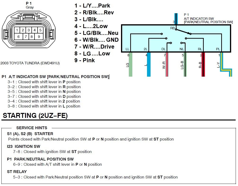

    Agree with Bryan
    May or may not help....

    Thank you so much for that diagram. I will check it out as soon as I can get it into the garage to work on it. That cold front has moved through our area and its too cold to be lying on the ground underneath the truck to troubleshoot it right now.
