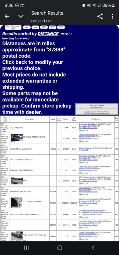

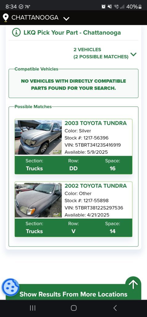

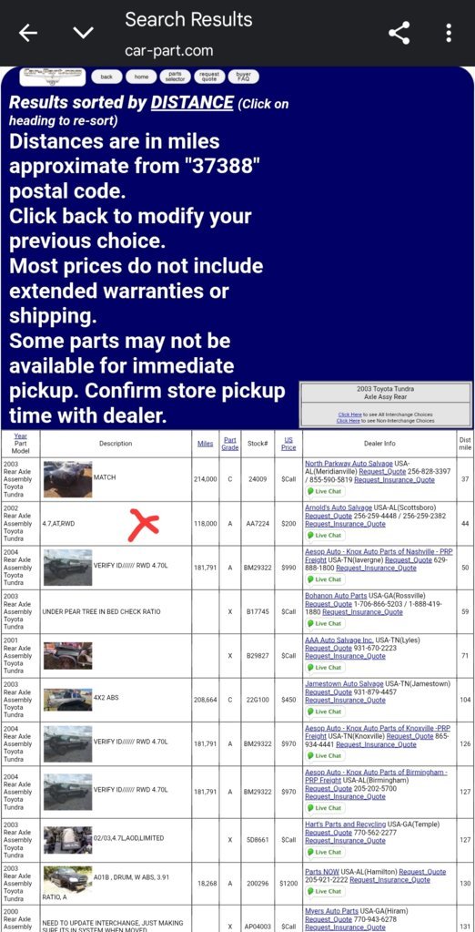

    That's what I thought on this one. I'll post some screenshot of the ones from my list that aren't that far. I'm thinking about just taking leaf springs and all when I get one as mine are so rusted anyway.
