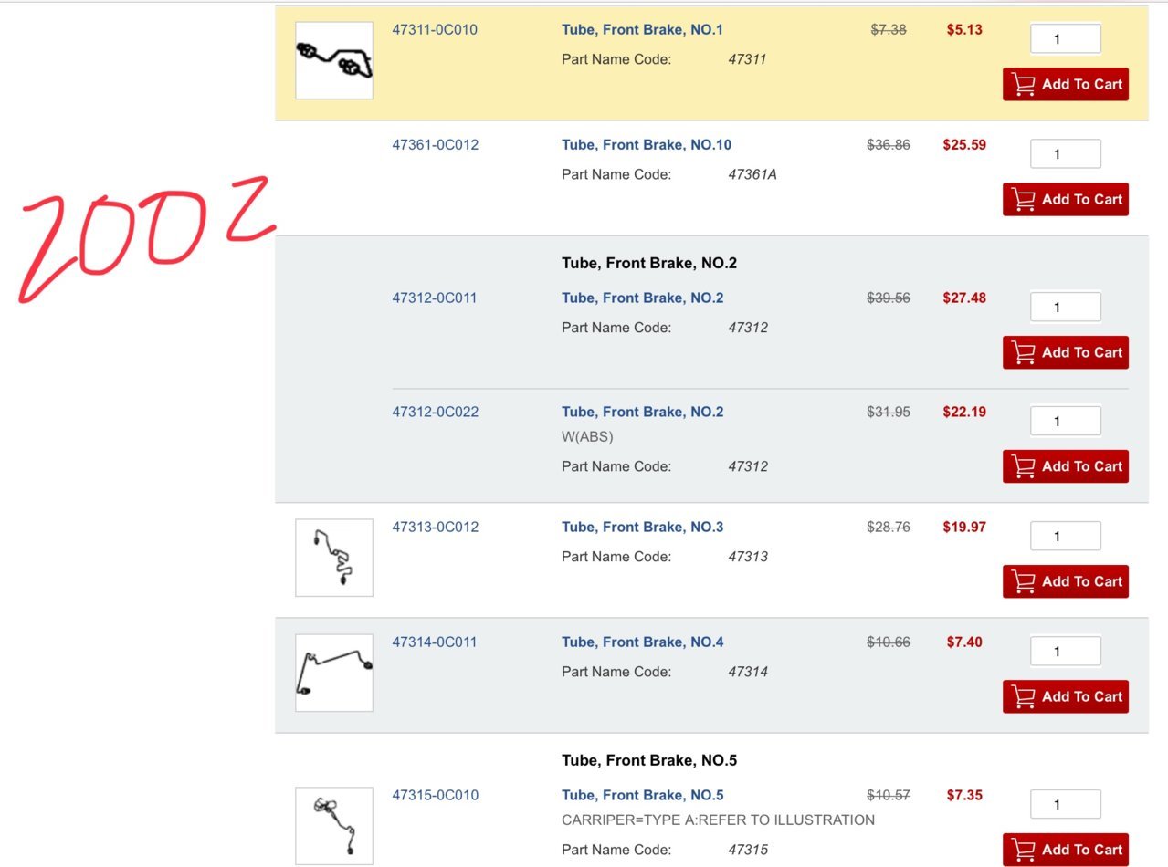

    So I was changing Calipers, Rotors, and pads on my truck. When I was transferring the old brake line from the old caliper to the new one, the brake line cracked and broke off. I haven't done the other side yet because i'm almost sure its going to happen again, they are super rusty. Does anyone know where you can get a brake line? Do you have to order it? Are they universal and can I get some at a local auto parts store? I'm not sure. Any help would be appreciated.

    They are not universal.
    Sometimes a local 4x4, hotrod or performance shop will be able to build a matching line with adapter fittings and stainless braided brake line if needed that day.
    Otherwise you'll probably have to order.

    i just changed my calipers as well and one of the hard line to caliper connections,
    would not stop leaking. went to local dealership and ordered $11. it was there the
    next morning for pickup.

    Depending on how quick you need the truck back, wheelers has a set of nice stainless lines

    Do you have a part number by chance? Can't find the part anywhere on toyotas website. Thanks in advance.

    Looks like you’ve posted Brake Hose Parts#. If that is the case for the OP, then buy some Universal Stainless Coated Front Brake Hoses from Wheelers and also do the Rear Hose over the rear axle, as well. Sounds like OP has a rust problem and the above parts/tubes/hard lines I posted should get him going in the right direction.

    Hope your fweelings aren’t hurtz. I’m no expert, but have actually done my front brakes and can say the Hose (you posted) probably won’t break but the hard line will (if rusted like our other member suggested above in post #3). Was making a clarification for clarity sake.

    Drivers side, hard line to caliper is 47318-0C010.
    Passenger side, hard line to caliper is 47315-0C010
    i should add, that even though i gave the parts counter my VIN,
    he asked me if i had the shorter or longer brake pads. i have the
    shorter and apparently there is a difference in hard line part numbers.
    hope this helps.

    Now if you really want to know why I made the Clarification? It was for Clarification Sake like I already said. There are a couple of hoses/lines/tubes upfront going into the Caliper. OP has some options to choose from based on Clarity. The Wheelers are a nice flexible hose upgrade if needed. The Toyota Tubes
    (if needed) are a perfect OEM fit.

    If you're talking the hose section you can pick those up at the parts store.
    If it's the hard line and you need it today take the old one to Napa and have them make a copper/nickel line for you with the proper fittings and bend it into place.
