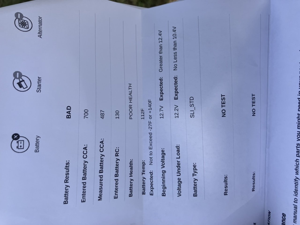

    I’ll prob try it later today, still letting the car run for a while to let the alternator do the work, pretty sure she still got a ton of life left in her.
    if what your saying doesn’t work then I guess my next project will be diagnosing why that feature is broken

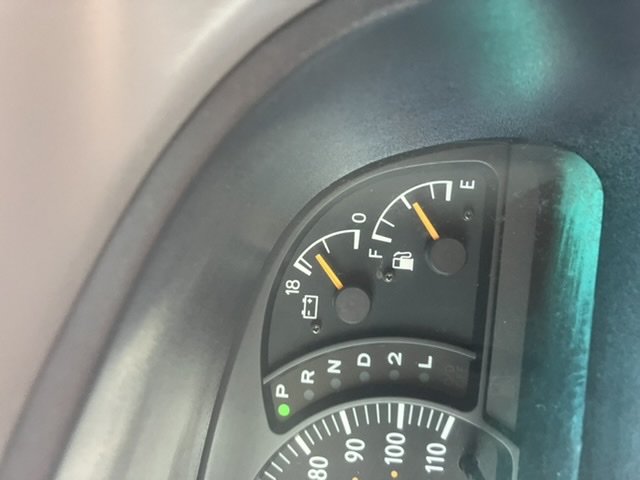

    @shifty` Confirmed this year does have the feature via owners manual..
    On second thought, I’m maybe thinking it’s time for a new battery as per my manual my gauge might be at the brink of acceptable limits…. unless it’s one of those things where for majority of tundras it falls closer to the bottom limit, can anyone show me where theirs sits?
    this is mine now with engine on, no lights, nothing plugged in, and in idle.

    Your batt gauge looks normal to me.
    meanwhile does the interior light turn on when you open the driver door?

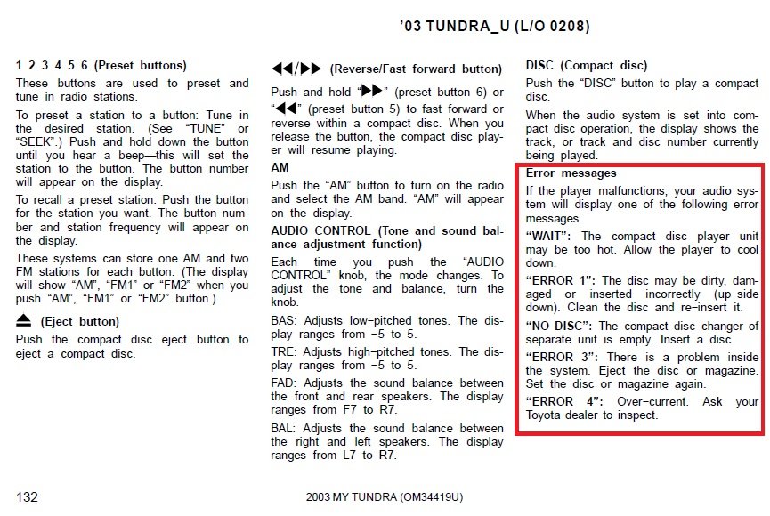

    guessing the radio didn’t like the dead battery, now is making a series of clicking sounds like it’s trying to load something after restarting the car.. idk much about electronics tho, does this thing have a reset button?
    Edit. Def the radio, I can replicate the noise when trying to “eject” a cd and the display shows “ ERR 3”. Also the lights def turn off when I turn off the car regardless of position 2 or 3 so idk what caused the drain.

    Ugh ERR 3 sucks. My 6-disc OEM changer threw that when it quit being able to process more than one disc. I remember initially trying to find a solution, didn't find one; there is a place online that resells our OEM stereos (if you're a purist/masochist), could try seeing if they will take yours off your hands for $50 bucks, they never answered me.

    whats the err 3 mean? I’m mean everything is else works as I only use it for radio. Just trying to get rid of the annoying whirring clicking sounds I get every start up now

    I forget, @atomicnugget, I don't have my serial no. handy but I essentially googled that and "ERR 3" and got a bunch of results. It's some kind of error in the tray lifting/lowering mechanism. You have the 6-disc, too? We have the same truck so maybe you do. DON'T put a CD in there, you might not get it back. RIP, burned copy of Coldplay X&Y I had since college.

    That is also in the 2003 Owners Manual. If you need the pdf version, it's in that thread shifty is always posting or....here

    Also thinking my battery is shot, after testing the lights auto shut off function several times with success, thats the only explaination I have for my battery dying in a matter of the morning hours.

    @shifty` well it’s definitely the battery LMAO or an aftermath of what happened, either way I think it’s time to retire the shitty gold craft
