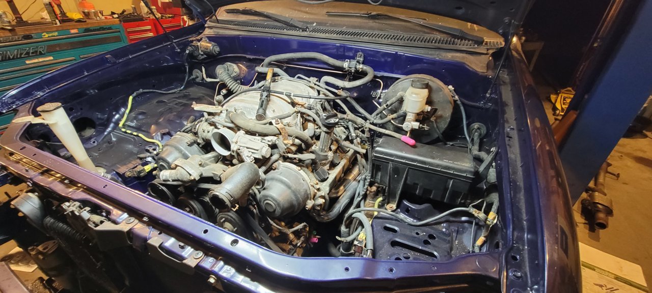

    cob
    cob [OP] New Member
    Aug 15, 2020
    #50830
    92
    Bob
    few 1st gen tundras
    used these gaskets that where recommed by someone in the tread

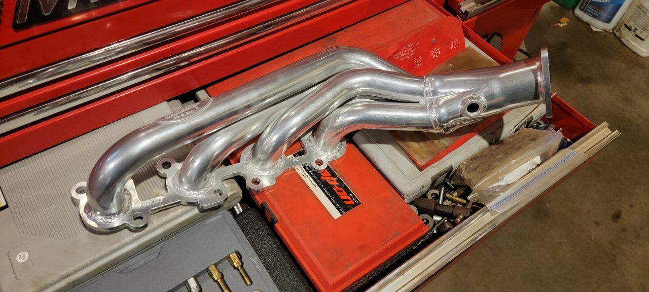

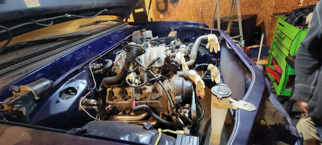

    Stage 8 makes a manifold bolt kit. That’s what I’ll probably be using when I get headers

    cob
    cob [OP] New Member
    Aug 15, 2020
    #50830
    92
    Bob
    few 1st gen tundras

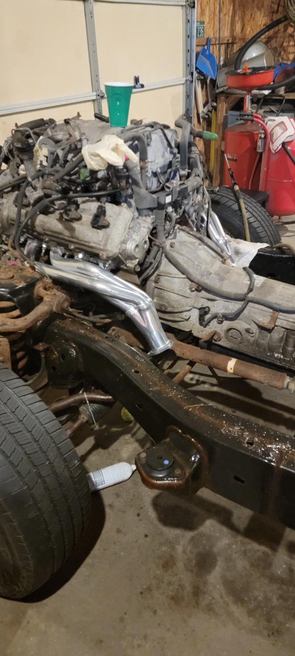

    manifolds installed all new oem body mounts

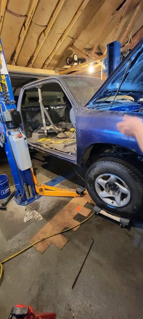

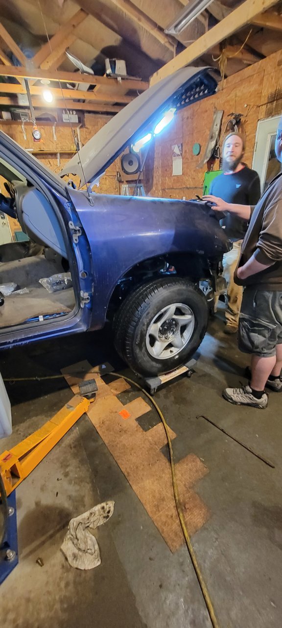

    i used these moving dollys to hold the chassis while lowering the cab worked great pushing it on the weight limits but i was happy with 50 dollars for 4 of them

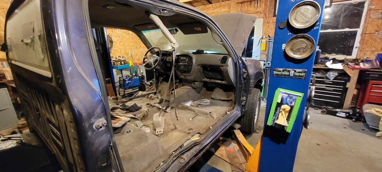

    installed the most of the interior stuff the wiring went pretty fast i would not wanna change the heater core

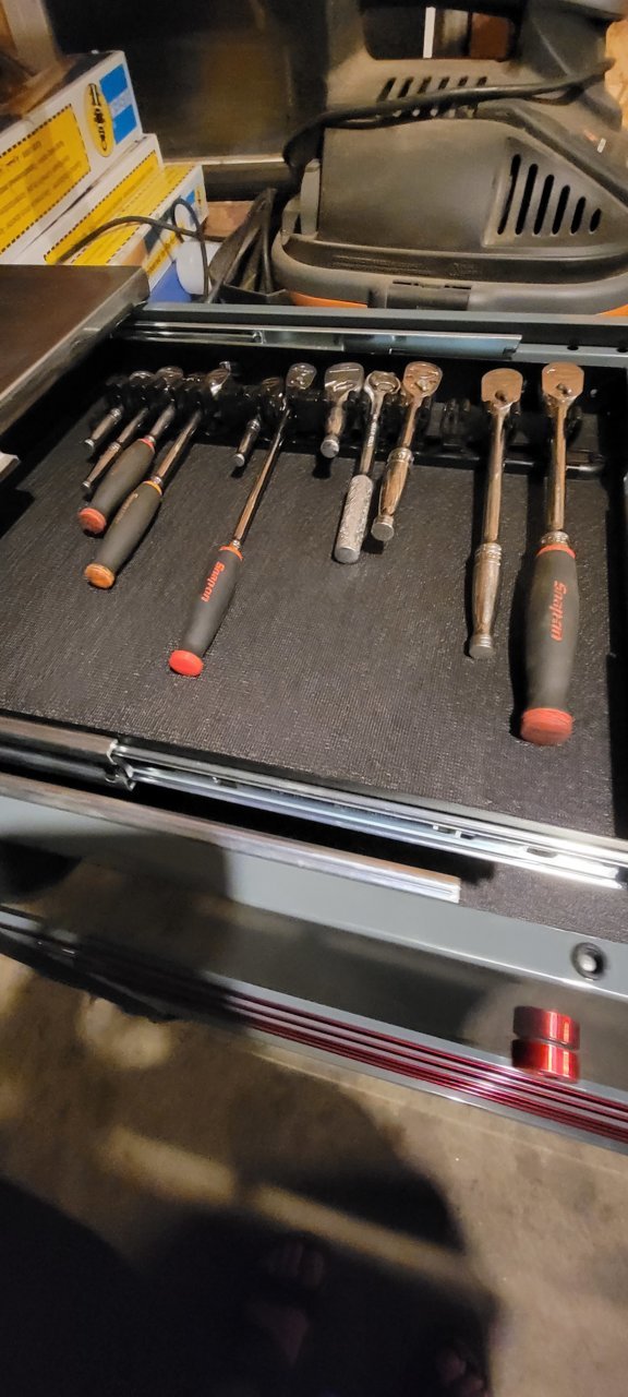

    i scored a deal on a newish tool cart :)
