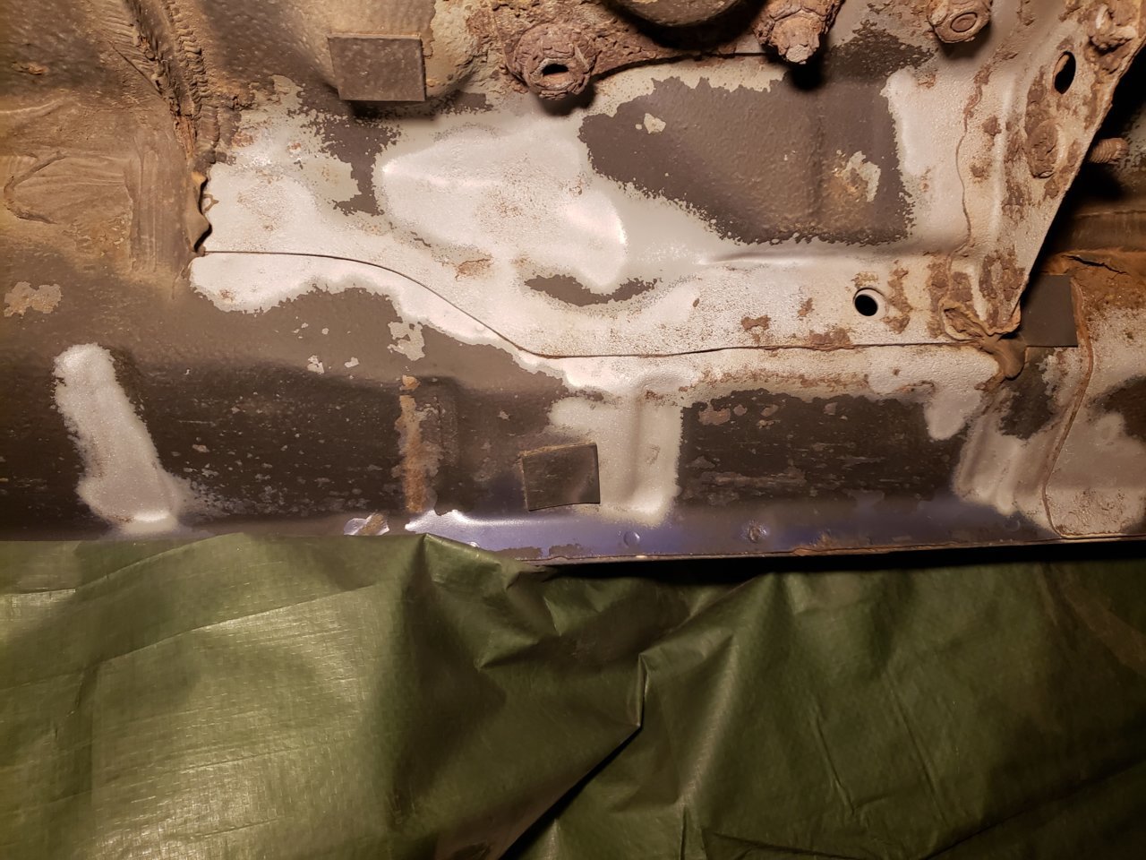

    started to clean up the rusty spots on the underside of the cab .... looking pretty good
    N84434, Darkness and speedtre like this.

    piece of advice with the rocker holes. remove those stupid stickers and find some rubber plugs..
  8. Nov 10, 2020 at 4:17 AM
    #38
    Professional Hand Model
    #14878
    14,993
    Fred
    Hand Protectors
    Should make it quieter in the cab, as well. A couple of mine were loose and peeling back and so I caulked all of them down around the perimeter with FuzeIt.

    not much to see today just sand blasting the underside of the cab super tedious
    N84434 and torino69 like this.

    still cleaning up rust spots on the cab should be setting some primer down today this has been the biggest time sink but hopefully we will be all setup tonight for some paint over the weekend

    What device set up are you using for the rust removal?
  22. Nov 13, 2020 at 6:44 AM
    #52
    cob
    cob [OP] New Member
    Aug 15, 2020
    #50830
    92
    Bob
    few 1st gen tundras
    a sand blaster for most of it. used a die grinder with cookie wheels and wire wheels on a 4.5 inch grinder

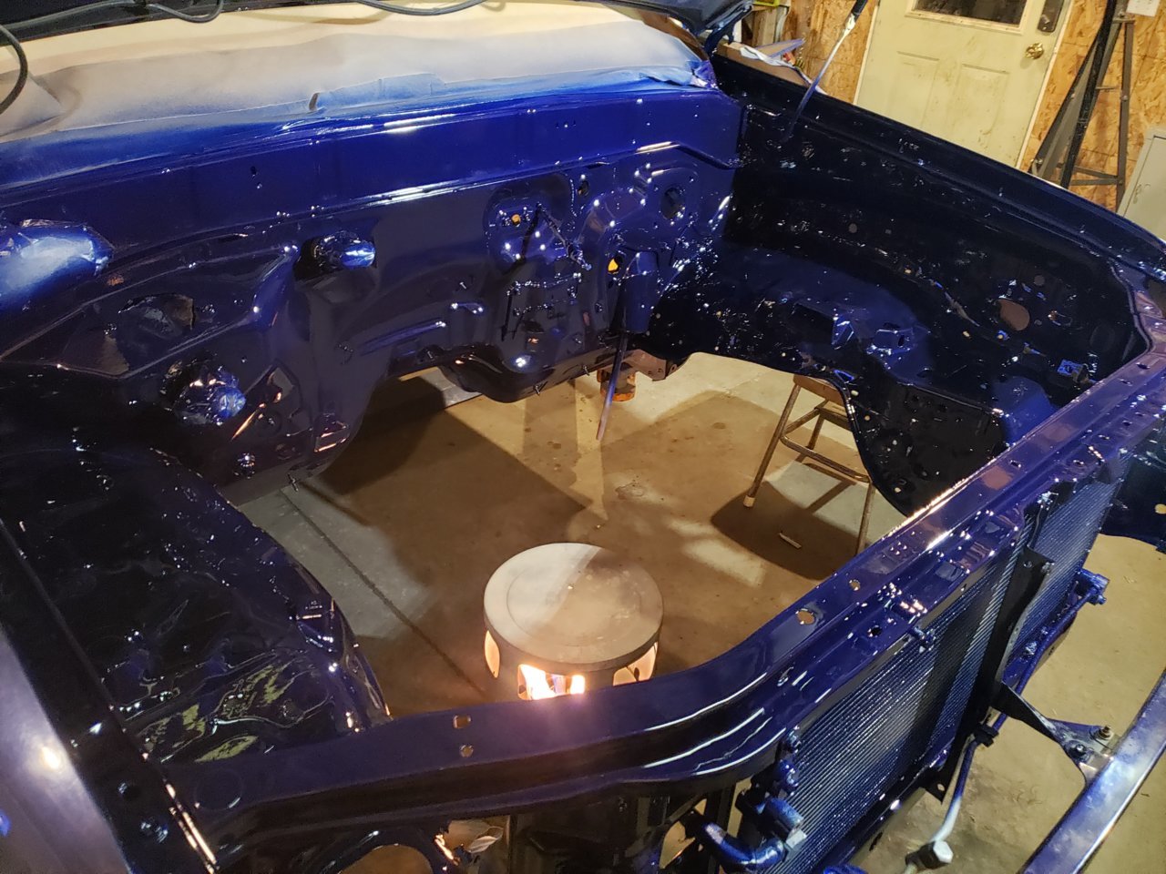

  29. Nov 16, 2020 at 5:18 PM
    #59
    cob
    cob [OP] New Member
    Aug 15, 2020
    #50830
    92
    Bob
    few 1st gen tundras
    some color in the engine bay and some undercoating on bottom
    MS22, speedtre, bmf4069 and 5 others like this.
