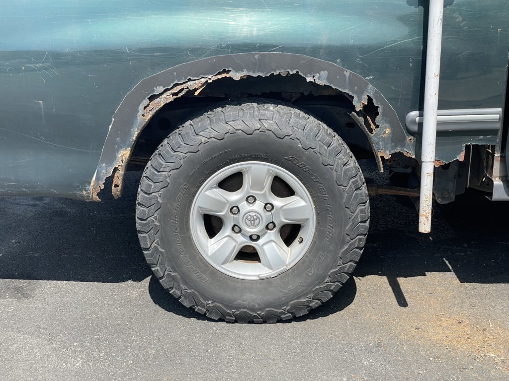

    Just scored some KO2’s from an ‘06 Doublecab for $650. For my intended purposes, slightly used KO2’s are perfect. I’m not a huge fan of chunky tires, but I think these look good. Just need to find a set of steelies…

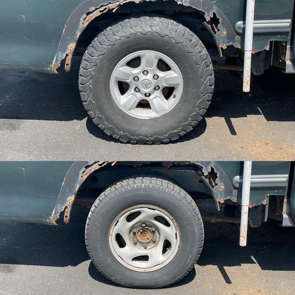

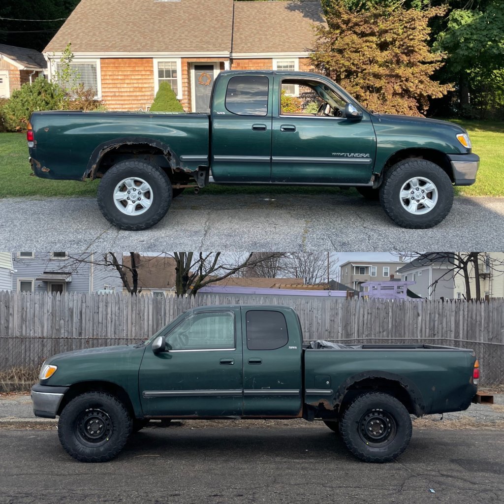

    It's been quite some time since I last updated, you know how life can get in the way of things. Even if I've been lax in posting, that doesn't mean work on the Tundra hasn't progressed!
    Looking back on my last post, it seems like I had just picked up some gentle used KO2's and had tossed them on with the wheels they came with. I've since had them remounted on black steelies (I don't know why I prefer that look, I just do!) and they look pretty damn awesome, even if I do say so myself.

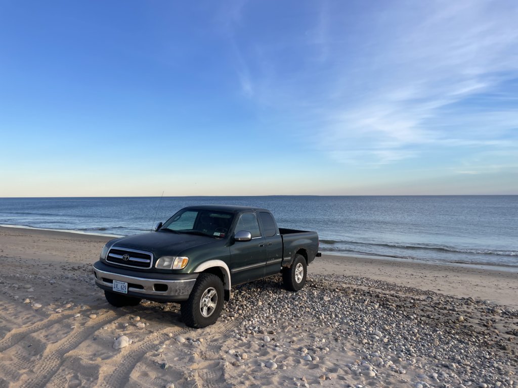

    I also scored some front fender flares (the bed from Alabama has a set on them). I plan on painting them (or Rhino-Lining, or something else to protect them) so I didn't care what color they were. Unfortunately, during a particularly heavy rain/wind storm one day while driving home, they both came off never to be seen again. Oh, well. At least I had the chance to take the Tundra out on the beach several times in the fall!

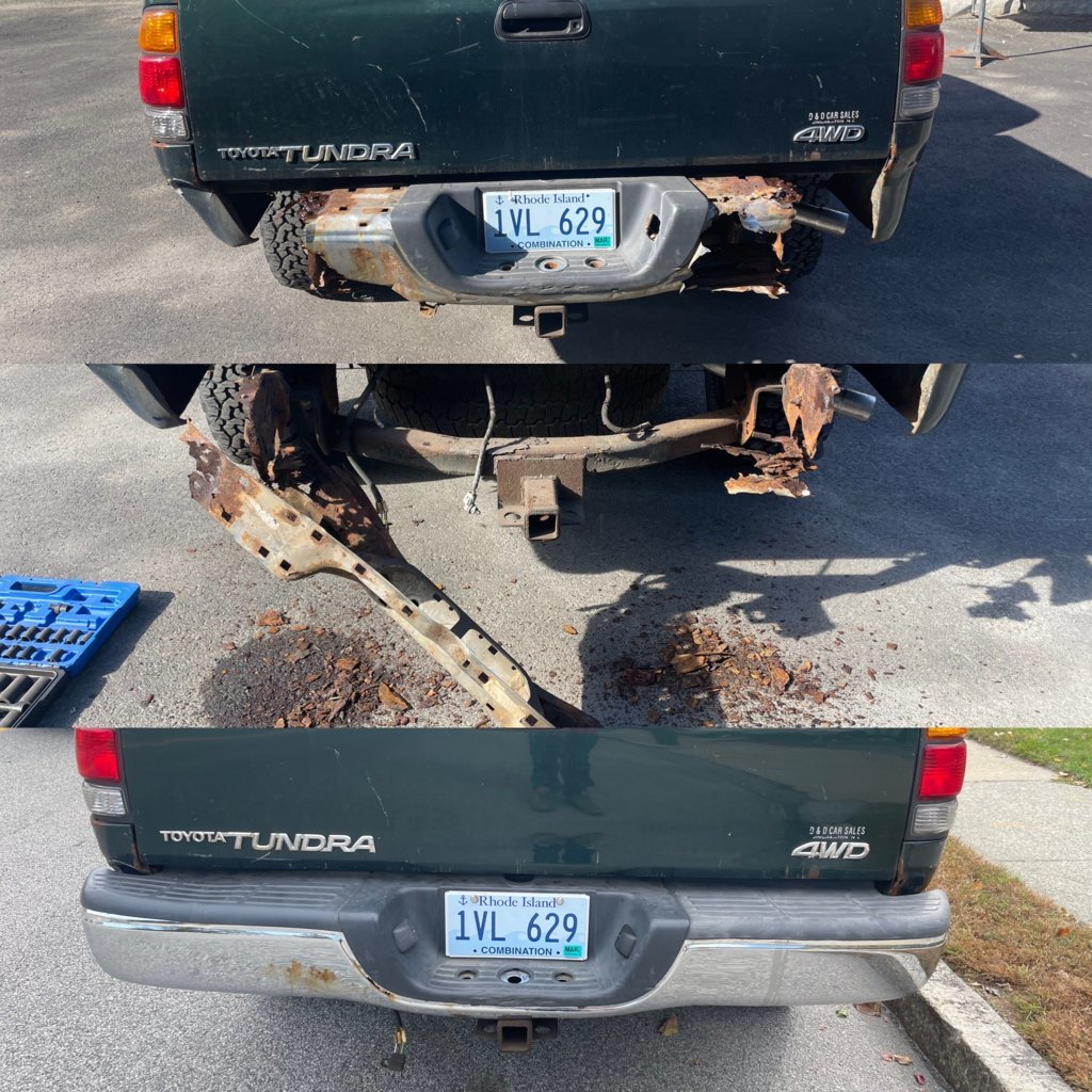

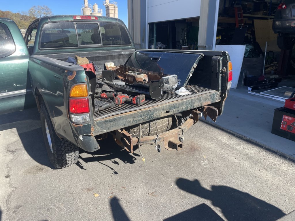

    One day last fall I decided to take a closer look at the rear bumper. Oh, brother, it was worse than I had feared. I sourced a solid replacement rear bumper (well, as solid as I was going to find for $50 in New England), but I knew I was going to need something more substantial for my plans. The replacement bumper at least helped me pass inspection The $50 also came with a brand new rear mounting frame which I thought I need, but alas I don't. If anyone out there wants it, hit me up.
    In a few of the photos above you can see the square-tube rear bumper my welder fabricated for me. I don't have any photos of that process, but you'll see more of it as I make additions and adjustments.
