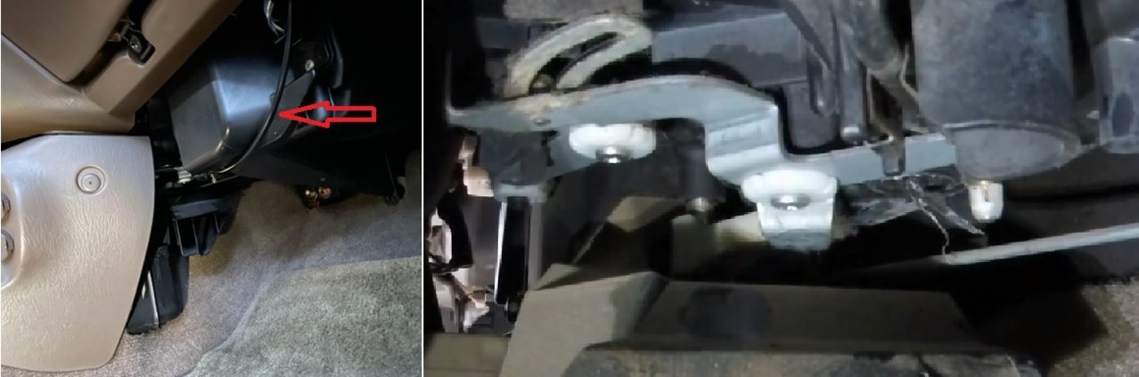

    As @shifty` mentioned it's on the passenger side.
    The below is from passenger side of my 2004 looking straight in from opened pass door(red arrow pointing to cable). You can then position yourself further in that area and rotate center knob as you observe the action of that cable.

    So, I've been under the passenger side of the dash and found that the damper door is very difficult to slide open and closed. Any ideas where to look for a video on how to take that apart and get it moving freely?
