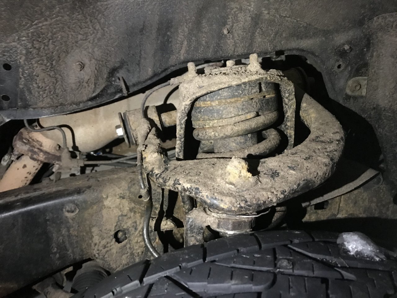

    Yes, I spent some time under it before I bought it, very little rust. Not pitting or holes or anything. Just a little surface rust in a few spots.
    This is my front shock tower, is that a stock spacer, or (spacers?) or was it lifted? Don't mind the mud, its MT in winter.IMG_2461.jpg

    Thats an aftermarket spacer lift. Probably 2" so it sits level with no rake.

    So are both rubber sections the lift or just the top one?
    Or in other words....what do I remove to bring this back down where it needs to be.

    Just the top one. Once you take out the coilover you will see how its bolted on. Just take it off and put the coilover back in.
