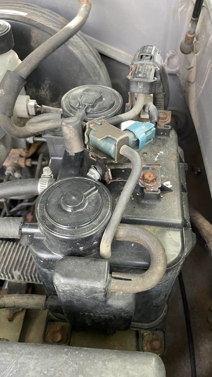

    So I'm still preoccupied with the boat stuff, so I won't be able to diagnose or fix this right now, but I want to get the discussion started.
    The same P0441 and P0446 codes have been coming up at seemingly random times since 2014. We've had it diagnosed three or four times, each time with a different diagnosis. Never officially fixed, just diagnosed. It's popped up a few times during my ownership, and I've simply cleared the codes and It's been fine.
    A few weeks ago, the same codes came back, so this time I purchased a new gas cap as well. Since the fuel door was broken for so long, the old one was in really rough condition. I assumed this was the problem and forgot about it. Last week, same codes. Cleared. And of course, they're back again today. The light is already driving me nuts.
    What should my first move be? Since the initial issue in 2014, we've had it diagnosed as the fuel filler, charcoal canister (engine bay), and a vacuum line. I replaced the vacuum line myself but I have no way of knowing if that was the problem. I've done a visual check of all the hoses and vacuum lines. The canister looks pretty rough but I want to rule everything else out before I go to that.
    I'm thinking it might be best just to send it to the mechanic and have him do a smoke test.

    I would either build or rent a smoke leak detector, attach it to the hose at the intake and start looking for where the smoke may be leaking out. Could be something as simple as the Charcoal Cannister being filled with fuel and causing problems as well.
    This is one problem I haven't had to deal with on mine.

    I'm not as familiar with EVAP system on our trucks. Smoke test is a great next step, but most systems have a purge/vent valve somewhere in the EVAP system, and those two codes together make me think your purge/vent valve may be periodically misbheaving, or maybe a critter got into it and nested, or some other obstruction or corrosion is preventing the vent from operating correctly.
    EVAP is pretty simple, in theory. You have a sealed, pressurized system that can hold and relase vacuum running between the fuel tank and the fuel rail. There's always a pressure sensor somewhere on that line (a lot of times at the tank, or on the pump housing depending on the vehicle) to monitor for hi/lo pressure. If pressure is too high or too low, the ECU can command the purge/vent solenoid (valve) to open, to bring the pressure/vacuum in the system to an acceptable range.
    Naturally, when the fuel pump is pushing fuel to the rail for consumption, that creates vacuum inside the tank, and there is an overflow return line as well, which can stabilize. Again, I don't know exactly how Toyota works. I also don't know if the gas cap is a one-way or two-way valve, but fuel caps on EFI vehicles usually have a one-way valve so when you reach a certain PSI (either high pressure or low) the cap will let air in or out, in the event the purge/vent valve isn't working right.
    Because it's intermittent, smoking it may or may not do anything for you. It's why I'd suggest finding, pulling, and inspecting the purge/vent valve first, and consider replacing if you have a JY nearby with a spare.

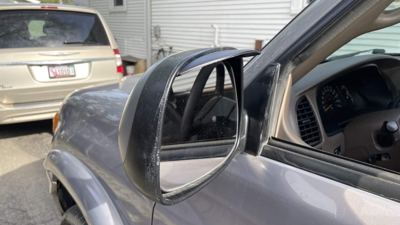

    I also added these mirror visor things. I’ve seen these on a few cars before, and I always chalked them up to being a useless gimmick. However, I drove my friends car with them a couple weeks ago in the rain, and they’re awesome. Ordered them right away. I like these, they’re subtle and they actually work.

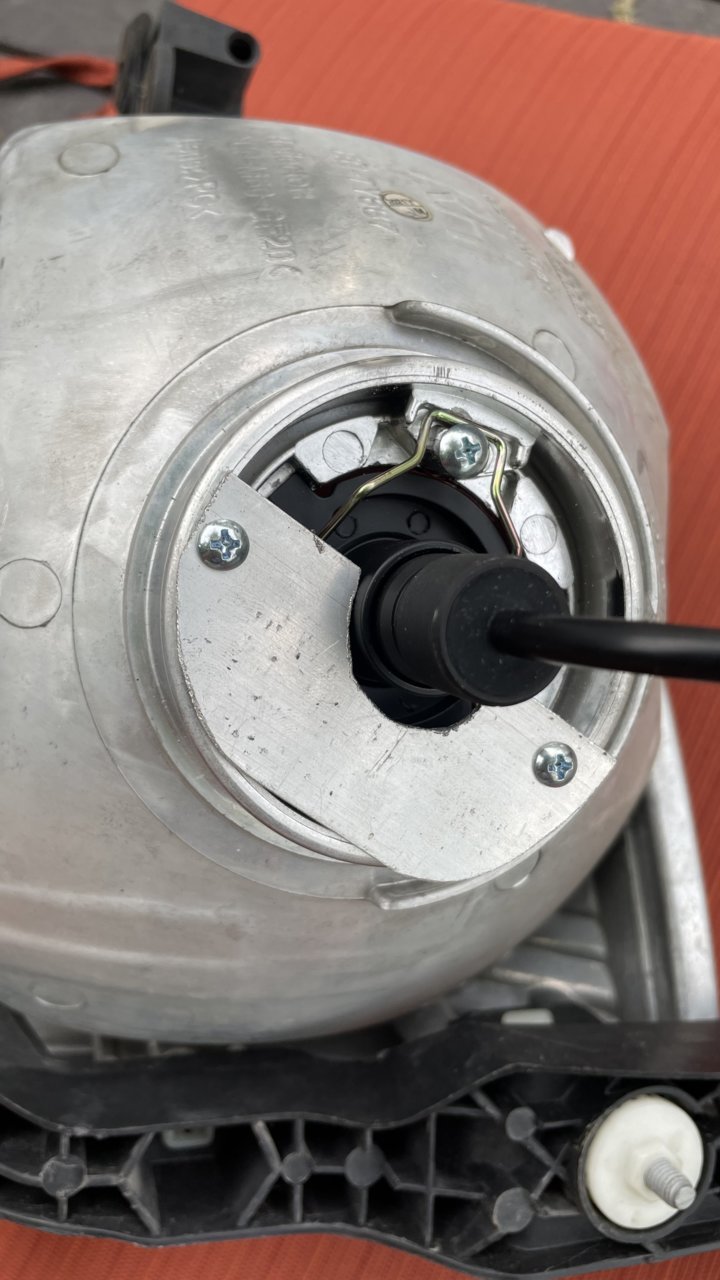

    I also just installed the BraveWay projector bulbs, they’re awesome. Super super bright, and installing them wasn’t too bad. I snapped off the plastic tabs that hold the wire clips down, so I built two little plates out of some aluminum strip to hold the bulbs in place. Worked great.
    Very little light scatter, (at least compared to before) and the beams are plenty wide for me. This photo isn’t a great representation, as the truck is parked between a white house, white garage, and white fence, so a lot of light is being thrown around.
    The high beam indicator and fog lights no longer work, but I think those functions will come right back when I buy ballasts. I’m not worried about it anyway. These are a massive improvement, I’m pumped.

    Not ballast. They already came with drivers. You likely just need a single resistor on the circuit somewhere. If you contact the manuf'er (or, uh, seller, since these are basically same as CO bulbs) via scAmazon they may send you one. Braveway offered to send me one at least, if I needed it.
    Guys on here were curious about night time driving shots, if you happen to take some, I know @FirstGenVol would probably be interested, maybe some of the TX crew too.

    The only other thing with the EVAP system and replacing the gas cap, in my experience, the Stant and aftermarket brands are crap. If you can get an OE cap, that might help as well.
    FiatRunner[OP] likes this.

    Ah. I’ll talk to the seller, see if they’ll send me a resistor. If not, no big deal. I’m plenty satisfied with it. Is it possible to get one that just plugs into the wiring? I’m pretty clueless when it comes to lighting stuff.

    Gas cap was replaced with OE, I was really hoping it was the issue, but of course! It was not.

    Yep it's plug and play, and you can probably get away with just one, passenger side has more room I think, so I'd drop it over there.
    I started a conversation with them via Amazon, by clicking on my order, then clicking the "Ask Product Question" button.
    Basically this is the thing I mentioned, but you may want to mention "I think I need a resistor for my application, because XYZ is not working, but everything else is!"
    I saw someone else say in the comments BraveWay sent them a resistor for free.

    Just to keep in mind, the resistor box gets super hot so you'll have to mount it somewhere either with bolts or epoxy (@Tundra2 did this), you don't really want it flopping around.
    There was a non resistor plug and play harness but on some trucks it would burn up the integration relay box so it's no longer in production.
    Work in what sense? Keep the rain off the mirror
    I assume these are the projector type bulbs where you remove the inner reflector shroud correct? Never saw a pic with the bulb installed.

    Thanks for letting me know that they get hot… I’ll make sure to mount them properly.
    For the mirror visors, yeah, they keep rain off of them when the truck is sitting, and I think they’re going to be very helpful in the winter when it starts snowing.
    And you’re right, they’re the projector bulbs. After driving around with them for a few days, I can confidently say that they’re awesome.
