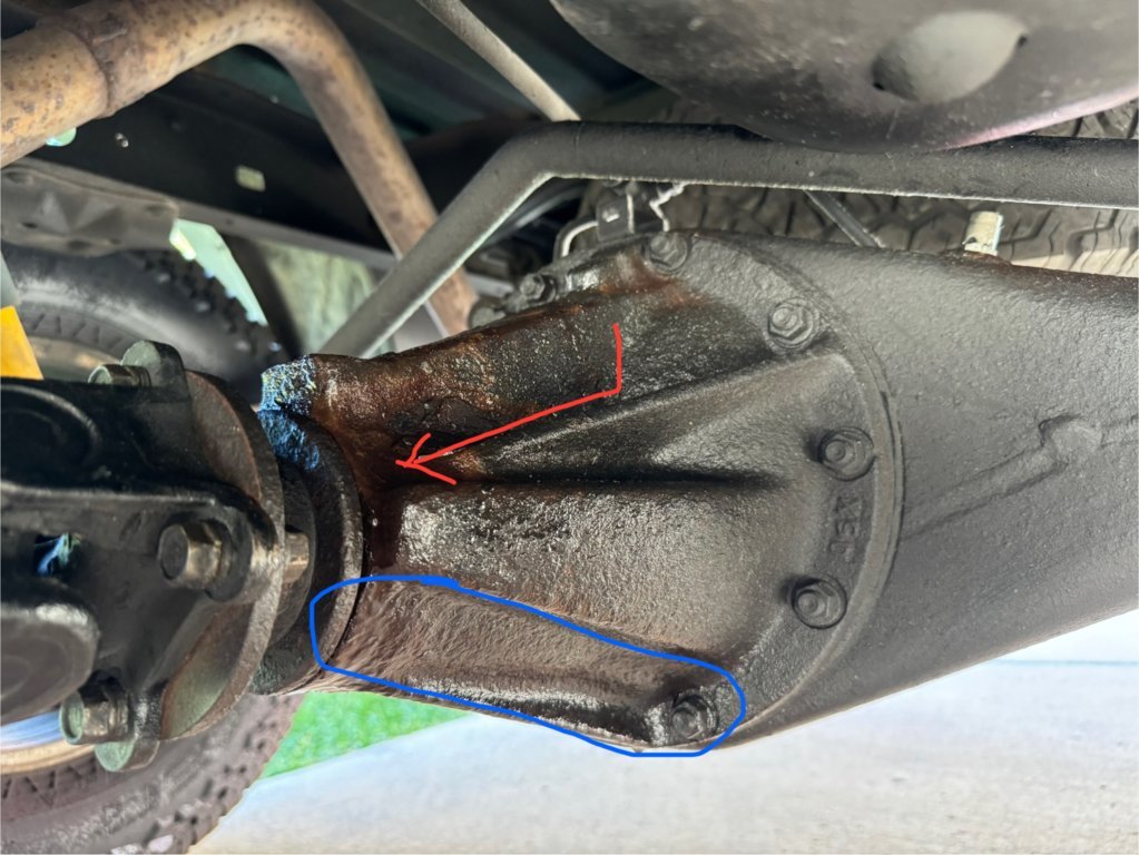

    Are you seeing coming from the pinion flange, flowing down underneath the 3rd and then dripping on to the ground? I know it's early in the morning for me. Just looks like it's directly under the diff gasket in the pic.

    There’s a wear mark, but it’s definitely not a groove. I didn’t do the fingernail scratch test when I had it off but I wiped it clean with a rag and it felt nice and smooth to me.
    Yeah, it’s running down the 3rd member and dripping from the lowest point. It’s the pinion seal for sure.

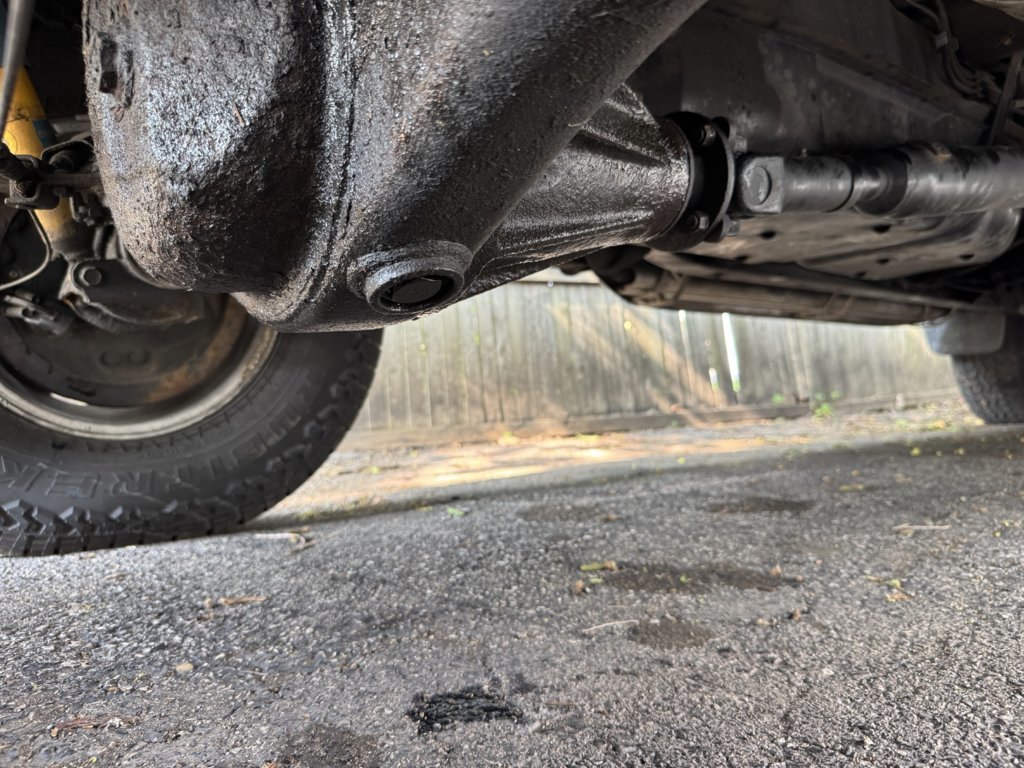

    So, I still haven’t replaced the seal, but it’s stopped leaking. I haven’t been driving it a ton, but it isn’t wet on the diff, and I haven’t noticed any fresh drips on the ground. There’s absolutely no way all 3.5 quarts have leaked out. I don’t think it would stop leaking if the level of oil in the diff got below the spindle, which I doubt it has.
    What do you guys think? Do I swap the new seal in? I still can’t check the fluid level without draining it all and pumping it back in the vent, which is just a pain and messy.

    Yup. Maybe what you saw dripping was just residual? Only way to know is fill and monitor.

    Yeah, it’s still leaking. Not very much, but definitely still leaking. I’ll throw the new seal in and see what that does.

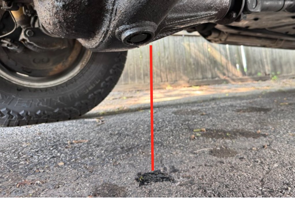

    Second new seal and it’s still leaking. And obviously from the pinion too. What the hell! I don’t know what else it would be.

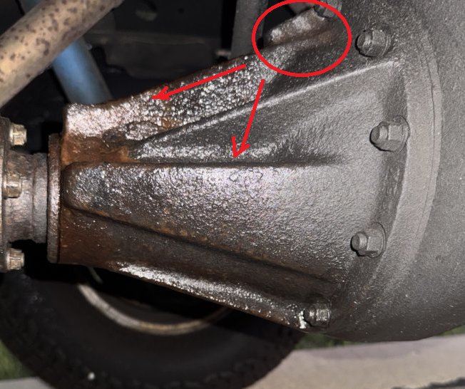

    Have you thrown a mirror up top to see if it's possibly leaking from up top, rakc up there, or maybe where
    I mean, it's feasible the spinning while in motion, and things seeping out and being blown back is coating everything evenly. But I'm curious if maybe it's an issue with the gasket between the pinion housing and axle/diff housing (up top), crack or loose nut on the pinion housing, ???

    I haven’t, but when I’ve been working on it I’ve had it lifted up on stands, and my head has been up between the muffler and gas tank. So, I’ve been able to see the top of the 3rd member, and it doesn’t seem to me like anything is wrong up there.
    I’ll throw a wrench on those nuts, but I can’t imagine why there would be a crack in such heavy cast iron.

    I've literally never seen it in my life, but I also can't explain why else it would happen. I also admit, my breadth of in-depth knowledge on anything past the slip yoke is lacking.
    I'm curious if, like @des2mtn or @whodatschrome may have any thoughts. I'd trust either of those guys to get in my rear end more than any local shop.

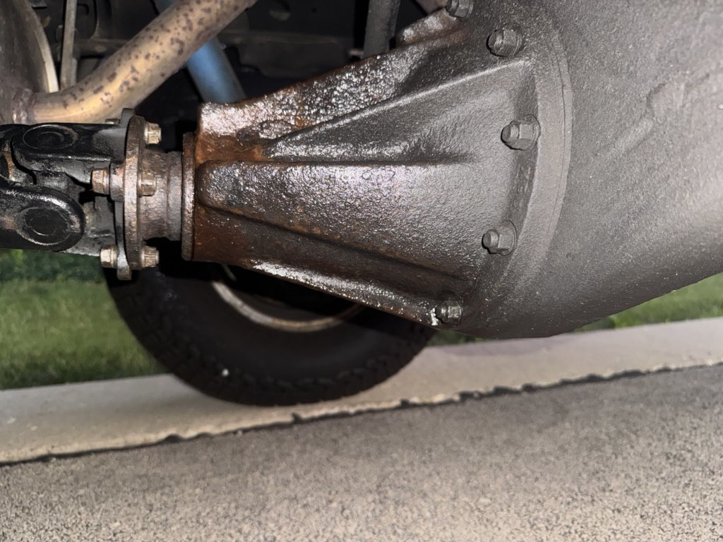

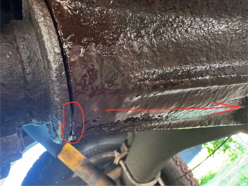

    I went out and looked at it some more. I won’t get the chance to clean it off real real good for a couple days- but I sprayed everything down with brakleen when I replaced the seal again, so none of this is residual.
    There’s noticeably more oil on the bottom side than the top side. Which makes sense- but if there’s a leak on the top I’d expect to see a lot more on the topside. I’d also expect it to pool on the ridges in the casting, (red arrow) but it didn’t. There’s definitely less oil towards the rear of the 3rd member.
    I sat here for a few minutes and watched oil drip out of here. I guess that this could be coming from above the pinion and flowing down the yoke, but it really seems to me like the pinion is what’s leaking.
