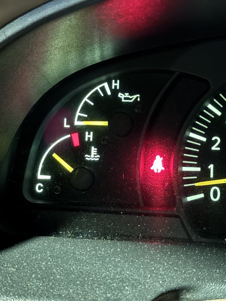

    Also- I know there are a million posts on here about low oil pressure. But like, this isn’t even above the bottom line.
    This is after two hours on the highway, but I haven’t seen it this low before. Maybe I’ll replace the sender this summer? I’m not really worried about it.

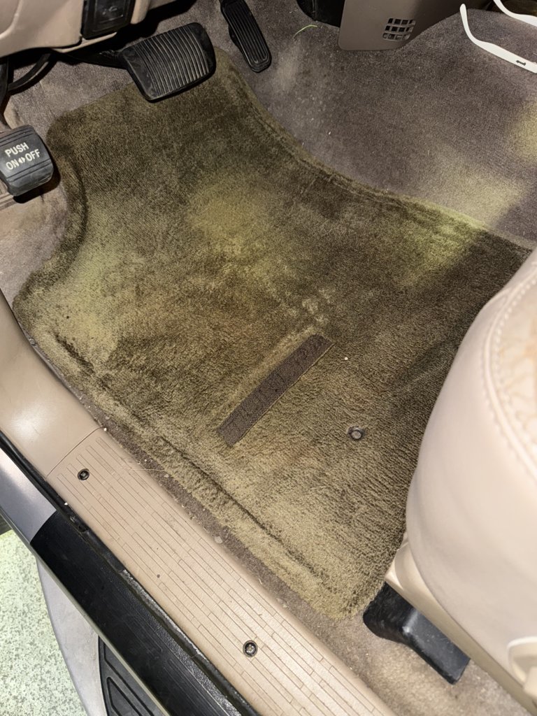

    This is what they look like fully dry:
    A lot less green, but they still don’t match.

    Same burnishing effect I saw on my OEM front mats. Someone apparently cleaned mine as well, and they were almost purplish in some spots instead of grey. Patterns strangely similar to yours.

    Damn. Guess I ruined my floor mats then. Hmm.

    Damn reminds me of old shag carpet from hippie vans lol. Looks like it was agitated too much
    Have you looked at Husky floor mats? Got a pair of those and dig them. Pretty easy to clean and fit the footwells pretty darn well. I'll take a couple pics for ya tomorrow if you want

    I’d wait until they’re completely dry, then attack the mats with purple power at full strength. Keep the mats saturated wet while scrubbing them for about 5 minutes a side. Then blast them with a pressure washer. I’ve cleaned old stinky gear oil out of automotive carpet by doing that same procedure.

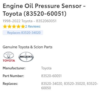

    It’s been a few months and finally got round tuit as far as their newer super dooper oil pressure sensor….83520-60051. Took it out before the evening was over.
    Normally @ idle 700rpm’s, I would read at 1/4 mark and 2000 rpm, 1/2 way point. After exchange, the newer one was at the line just below the H at 2K rpm and idle was 1/2 way. I said Fk that charlie and put original back in :crazy:
    FiatRunner[OP] likes this.

    Imma keep it stock
    That's the one I have now. So is your 04 OEM 83520–34020?

    No clue what my original one is, which is in there now and will stay there until it craps out or hell freezes over.
    Looking at Ourisman for my 04 DC LTD, they show 83520-60051 that replaced a few including that one you're showing.

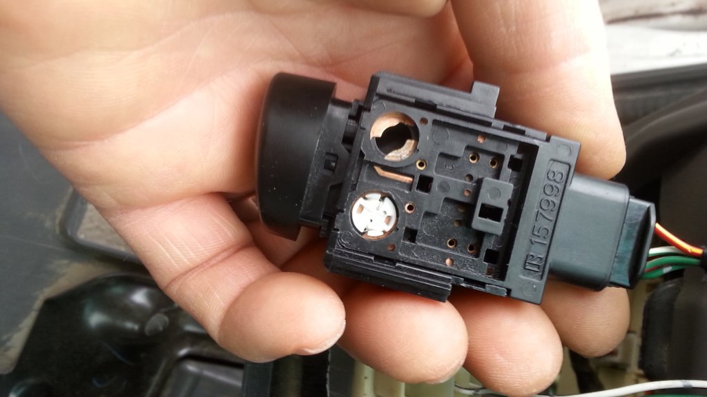

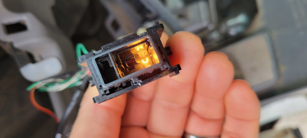

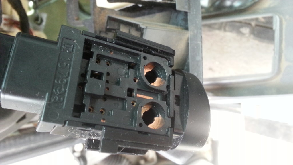

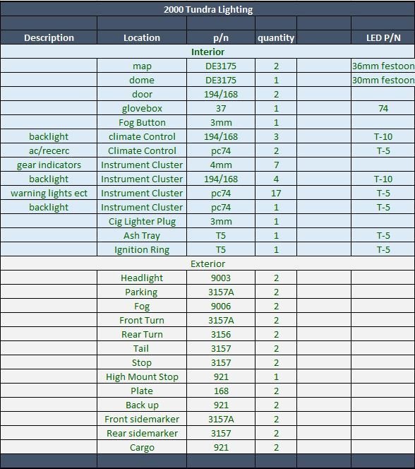

    Is there a replaceable bulb on the inside of the fog light switch? I literally just watched the backlight burn out.
  18. May 5, 2025 at 1:53 AM
    #528
    BroHon
    BroHon Bitch in the Mitten
    Sep 19, 2023
    #104169
    2,790
    Bro
    Location: Bitch Mitten
    2000 SR5 AC 4x4 4.7
    Sketchy street barnacle
    Yeah, here are some pics. I jammed an old/extra incandescent in there... If irc, the LED didn't provide enough light (didn't face out at a 90deg angle).
    Also, I couldn't get the other socket to light in any position. I thought it might glow when it was off with the parking or headlights on? Someone else might be able to elaborate on that and what it's for?
    I am a 2000 vintage as well, so its apples to apples
    Edit: found this in my archives

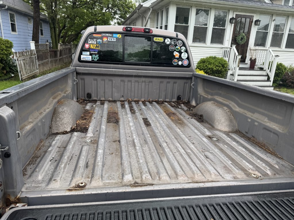

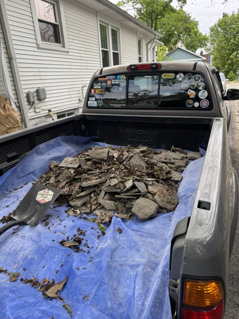

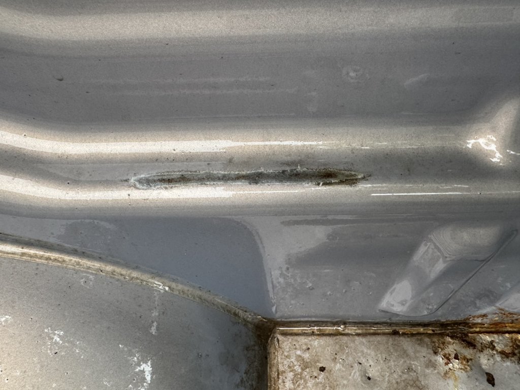

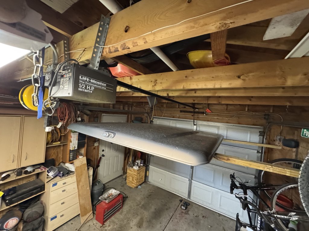

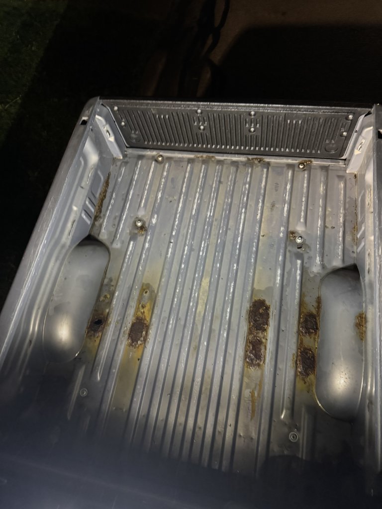

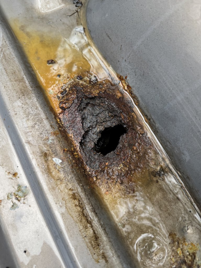

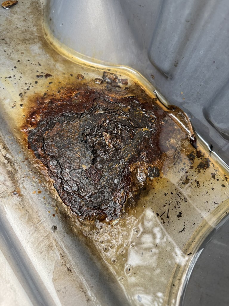

    Removed the bedcover to gain some more room to move out of my college dorm. Built this storage rack to hang it from the garage door track in my garage. Just a couple of 2x4s and some thin dyneema ropes. The bedcover weighs probably 80lbs and has a lot of damage from being stored on its end, so I really wanted to figure out how to store it flat.
    I also hauled a bunch of old gravel, rocks, and bricks. Should’ve gotten a better photo- probably had 4x this amount when I hauled it to the dump. I forget how nice this thing rides with 1000lbs in the bed.

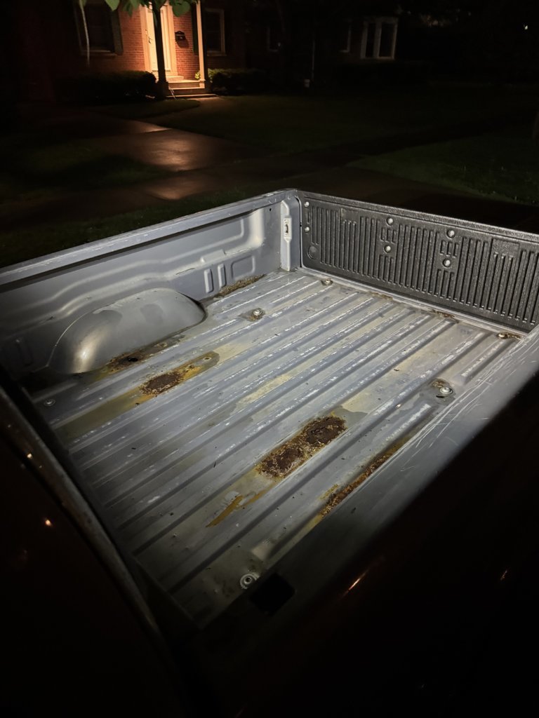

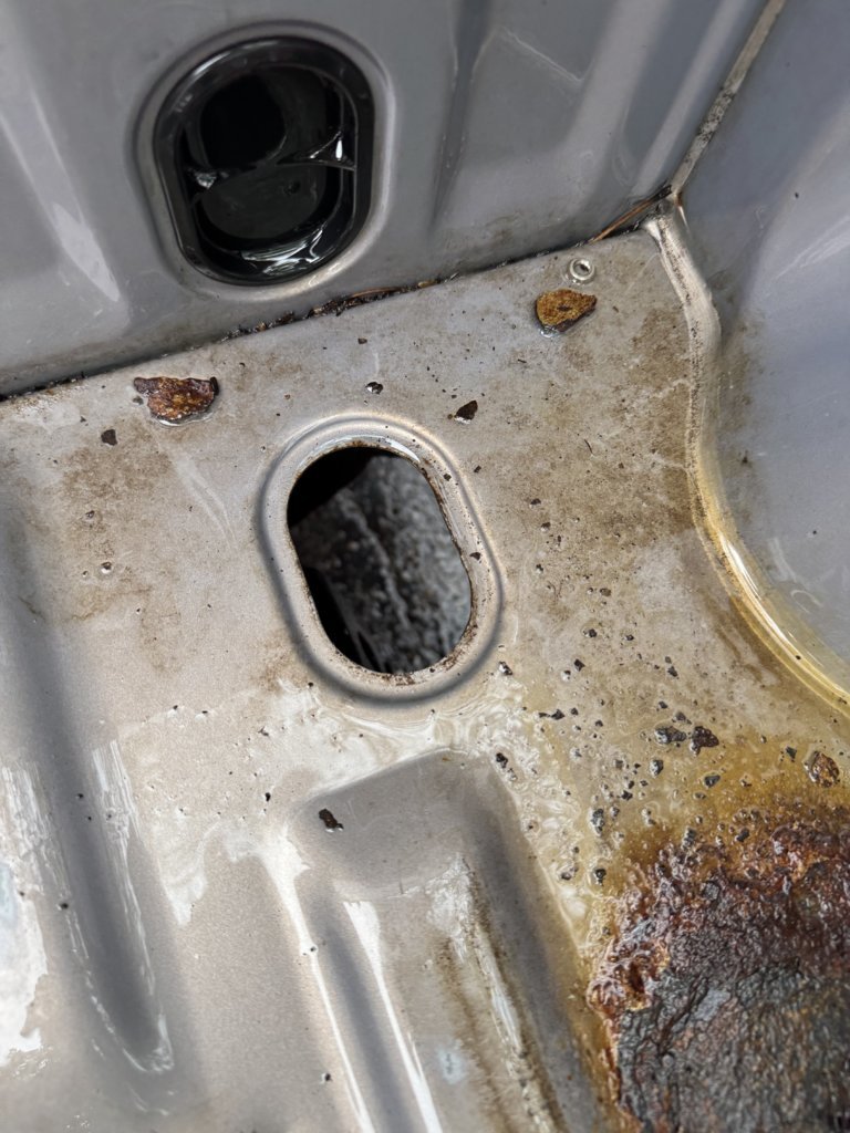

    I got curious and decided to pull the bedcover. First time it’s been removed in 25 years, and there was a fair amount of gunk under it. The truck has spent very little time without the bedcover on it, which I think has been really good for it.
    That said- there was plenty of rust. A bunch of surface spots, and a handful of really gnarly crusty holes. This was expected- I could see them from the bottom. For now I’m going to coat the rust spots real good in surface shield and put the bedcover back in, with the drain plugs removed for better drainage.
    It looks like most of the rusty spots are all on flat sections, so they should be pretty easy to cut out and replace in the future. All of the bed bolts were replaced when the frame was replaced, and they look like they’d be pretty easy to remove in the future.
    It’s interesting to see how much wear is on these spots where we’ve put a 1x6 for mounting a bike rack.
    Also, the LED cargo lights I installed work excellently without the bedcover.

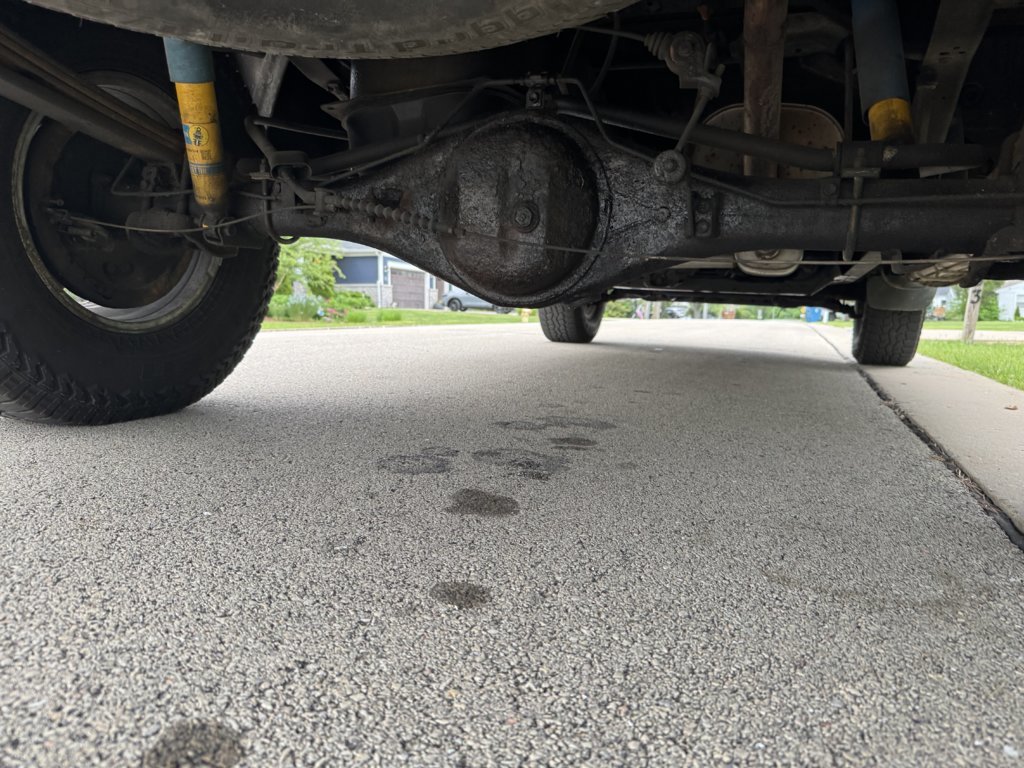

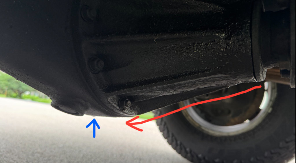

    Just noticed that there’s a leak from the rear diff. Don’t think it’s the rear cover or due to rust- it’s either from the pinion seal or the seam between the housing and the 3rd member.
    I always park in this exact spot at my girlfriend’s house. Looks like it’s been leaking for a few days at least.
    It’s wet around the pinion and the bottom, but it always kinda does because of the surface shield. It’s been parked in this spot for three hours, and there’s already two drips.

    1. Make sure you check the level and add more diff juice if needed
    2. Get some Brakleen and clean it up real good so you can see what's what
    3. If you haven't changed the breather now would be a great time to do so
    4. Put some cardboard underneath before you wreck your GF's driveway (potentially far worse consequences than a diff failure)
    You can take all summer to sort it out as long as you keep it full of oil. A leaky pinion seal will fling oil, so it would be easy to see it spread under the bed and adjacent areas. A leak at the gasket (or RTV seam at the carrier if someone's had it out previously) will be similarly obvious once you clean it up. It's unlikely IMHO that it would leak there, unless someone's had it out.

    Yeah, hard part is that the rear cover on the diff is rusted enough that I’m scared to try to loosen the plug. When I changed the oil (which was very clean when I put it on my finger) I filled the diff through the vent hole. Makes it a bit hard to check the level.
    The 3rd member has never been removed from the housing so I don’t think it’s leaking from there. I’m going to have to take a better look at it, but for now I’m assuming it’s the pinion seal. YouTube tutorial looks pretty easy.

    Just paint mark both the pinion nut and gear before removal. Put it right back to the mark.
    This keeps the preload correct for the pinion bearings.
    You could always just drain and fill with 3 fresh quarts if you're unable to check level.

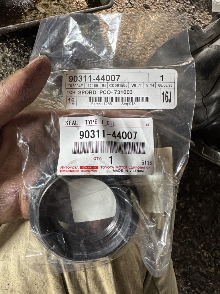

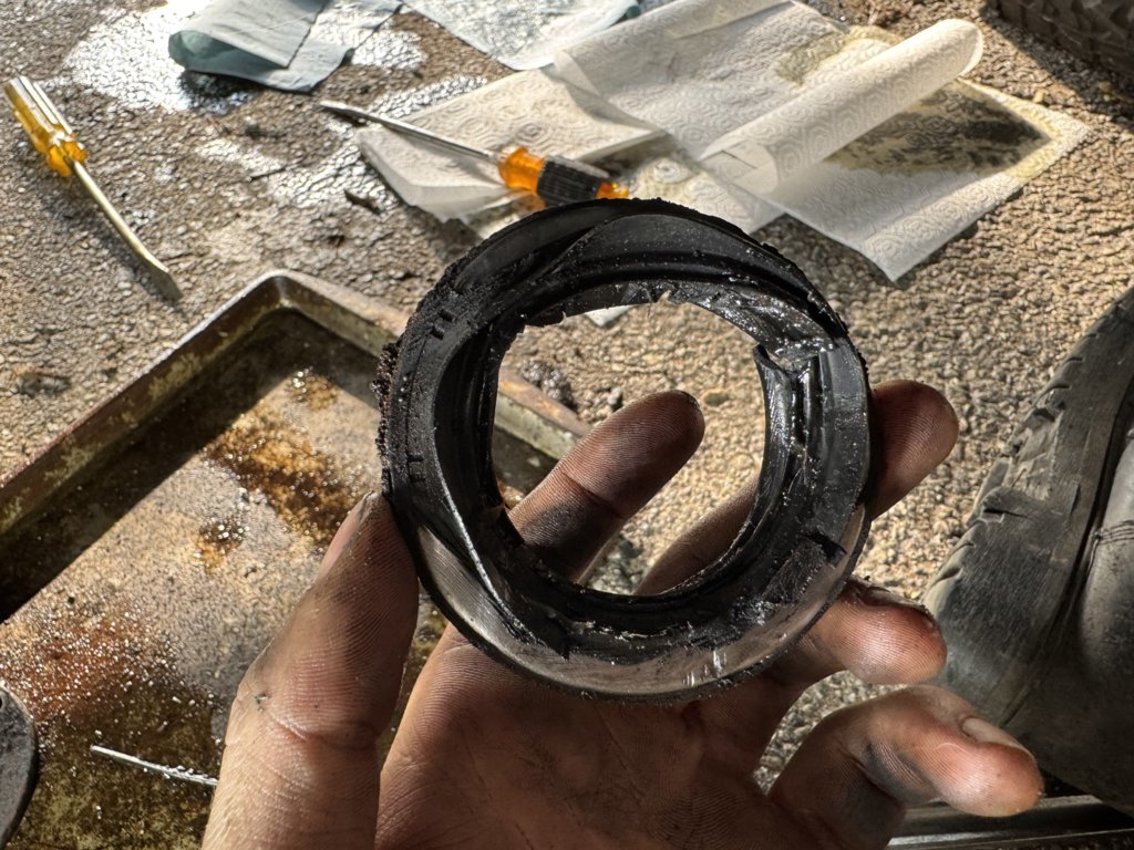

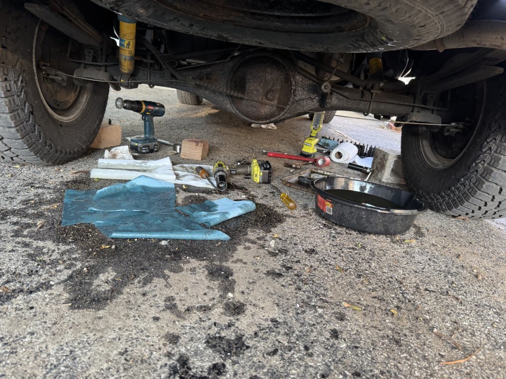

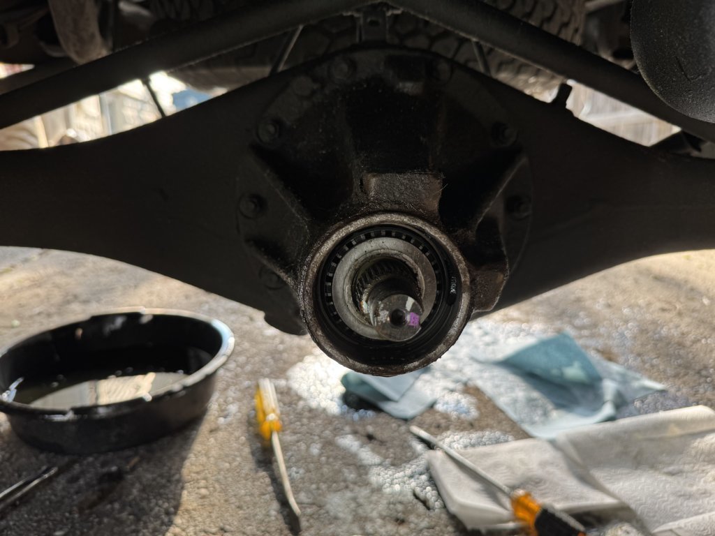

    Replaced the pinion seal today. Started out quick and easy but turned into a nightmare.
    Driveshaft bolts came right out, I knew they would since I put anti seize on them when I replaced the driveshaft. The flange nut came off pretty easy and the flange itself wasn’t too stuck on the splines. I drained the oil and it was super clean, and at least three quarts came out, so it wasn’t very low at all.

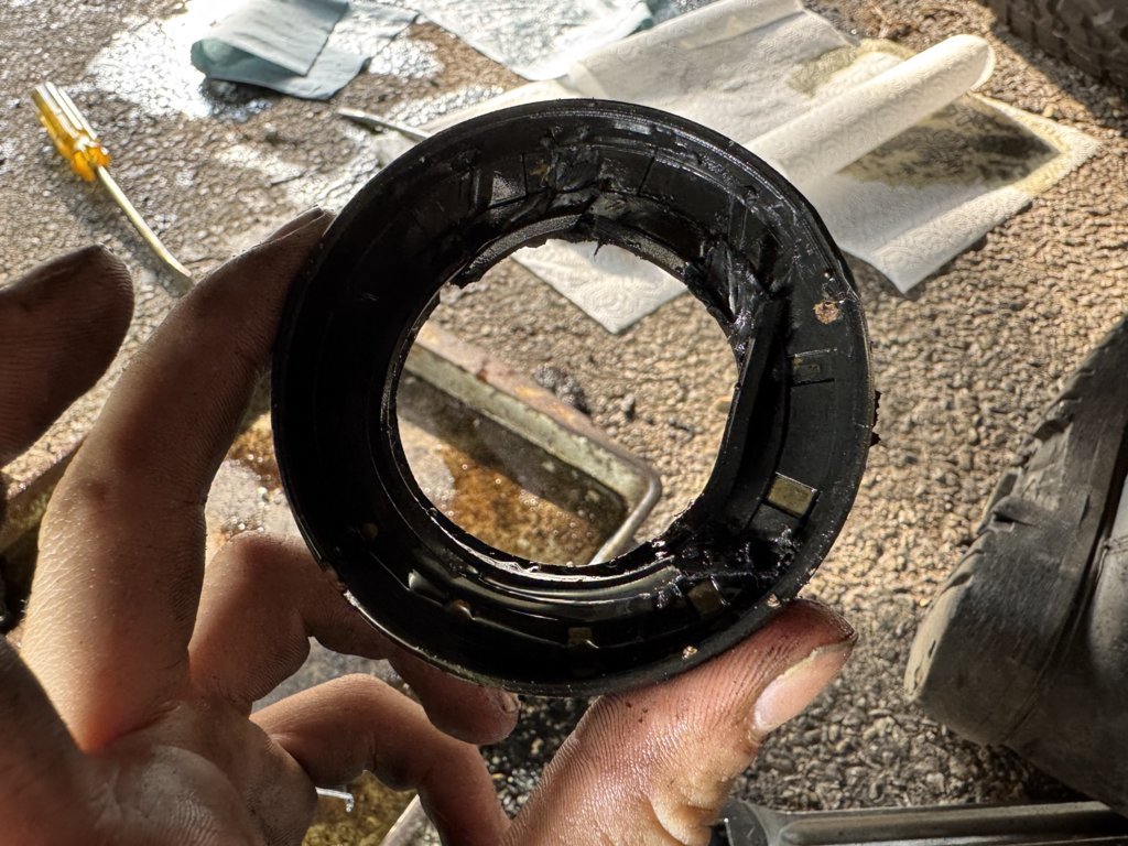

    Getting the seal out was another story. It was so badly rusted into place around the edges that I pretty much had to destroy it to remove it. I was hoping that I could inspect it after removal and find out why it might be leaking, but that definitely wasn’t possible.
    EDIT: I forgot to mention that the spring inside the seal was missing. Maybe it flew out and I missed it, or maybe it got eaten by the bearing, but I couldn’t find it.
    The only way I was able to remove it was by jamming a long screwdriver in it and kicking it with my foot, which backfired on me when the screwdriver launched into the pan of oil and spilled half of it on the driveway. This meant that I couldn’t reuse the oil that only has 20k miles on it, and looked super clean. To make matters even worse, I’m still too scared to remove the fill plug because of the rust, so I had to fill up the diff via the breather hole, which takes forever and is super messy. By the time I was done with the job the driveway was a disaster.
    The new seal was $21 incl. tax at my local dealership.
    Bmktw2, KNABORES, bmf4069 and 4 others like this.

    Please be careful when putting the flange back on the pinion as hammering it on will cause the pinion gear to press itself out of the bearing and then you will be in even more trouble
