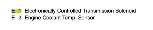

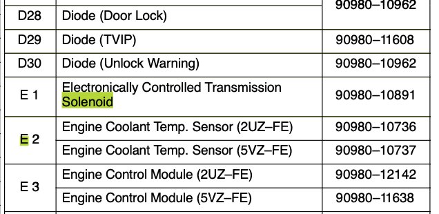

    This can only be confirmed by pulling the trans. Unless its visible from removing the inspection plate. Have they pulled it yet?
    Unfortunately, the FSE is of no help with Shift Solenoid E. If you feel that the issue is electrical, start with section DI-398 / page 668. That will give you the ECM pin diagram. Start there.

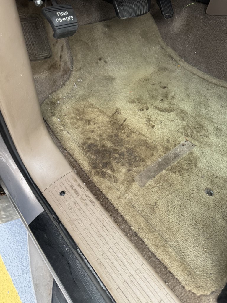

    The truck is finally back. Finally!!
    So glad to have it back, I forget how nice this thing drives. The issue was that the “E” solenoid installed by the previous shop wasn’t an OEM solenoid, and it failed. However, instead of failing completely and opening the circuit, it still had 3 ohms of resistance. Since the circuit was still complete, the computer wouldn’t immediately throw a code. This also made it take longer to diagnose, as both the shop and I assumed that the solenoid was good, since it wasn’t acting the same way it did previously.
    The shop was having some pretty serious staffing issues, which is why it took them so long. They were super apologetic, and knocked a lot off of the price. (Especially after I pointed out how dirty they got the interior.) They only charged me $400.
    Another thing the shop mentioned was that the paint on the inside of the trans pan was peeling and gummy. @The Black Mamba have you experienced or heard about this? Makes me wonder why it happened. They cleaned it out real good.
    Just need to figure out how to get this out of the floor mat. It’s not dirt, it’s like oil or grease.

    No, but maybe from heat?
    Soak in brake cleaner and then pressure wash.
    EDIT: Also, another good point when replacing critical items... always go OEM. Not that you chose the one the first shop put in, just a message for others down the road.

    A good degreaser, and a little time with a drill brush attachment should knock that loose enough to hose out

    I doubt it was heat. I’ve always got my eye on the trans temperature- and it’s never been excessive, even when the fan clutch was shot.
    The brake cleaner won’t hurt the mat? Like, that wouldn’t dissolve the fibers or anything?

    Like the drill brush idea. Will attempt this weekend.

    Nick’s idea is best. I’ve taken brake clean to shirt and pant stains before with no issue

    Sprinkle Oxyclean on it. Get a spraybottle, spray it with COLD water until it's just enough to form a semi-runny paste, and scrub it in with a stiff wheel or deck brush, circular pattern. Scrub in circles for 10 seconds, spray it with more water. Repeat for half a dozen cycles, then just let it sit and dwell for 10-15 mins. Get the garden hose out, spray it while scrubbing in circular patterns to get the Oxyclean out.
    I've used this for gear oil and it worked. It got the stain out, but the smell never went away.

    And blue Dawn soap, mixed with Oxiclean...

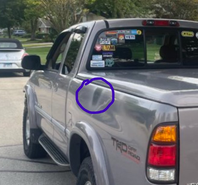

    Thanks! Everything was done with rattle cans. The paint itself is important- but the clearcoat is much more important. I used the Sprayaway 2K clearcoat, which is available on automotive touchup's website. It's the same stuff that pros spray out of a gun, just in can form. You NEED to wear a proper respirator when using it, it's serious stuff.
    Do keep in mind that painting is 90% prep and 10% paint. Sometimes you can skew that to 80/20, but proper prep is absolutely key.
    Edit: Here's an example of a spot that didn't get prepped properly. Turns out that the "surface prep" solution I was spraying on the paint wasn't happy with. Had I read the instructions, I would've known that you're not supposed to use that stuff. It still looks ok, and it's better than a rust spot. But I notice it every time I look at the truck.

  29. Apr 28, 2025 at 7:13 AM
    #509
    FiatRunner
    FiatRunner [OP] 2003 rich
    Nov 25, 2022
    #87321
    1,181
    Jack
    Chicago Suburbs/Milwaukee
    Washed the floor mats over the weekend. Sprayed them down with the hose, put a bunch of dish soap on them, and scrubbed with a drill brush. The grease stain came right out.
    That said- it took an unbelievable amount of time with the pressure washer to get the water coming off the mats to run clean. I kept spraying it over and over, and more and more dirt kept coming out. I was shocked.
    They also changed color?
    They’re still just a bit damp, but they’re mostly dry. Sure hope they look a lot less green once they fully dry out.
    The Black Mamba, w666 and BroHon like this.
  30. Apr 28, 2025 at 8:50 AM
    #510
    shifty`
    shifty` Dead heads and frog legs. Mmm... cake mix!
    Jun 20, 2020
    #48239
    30,703
    ATL
    '06 AC Limited V8/4WD
    It's quite probably some of the 'not clean' you saw coming out was actually the dye of the mat.
    Oxiclean tends to be a little more gentle with old dyes, and that's part of the reason it's my primary go-to. It might've pulled just as much dye out though.
