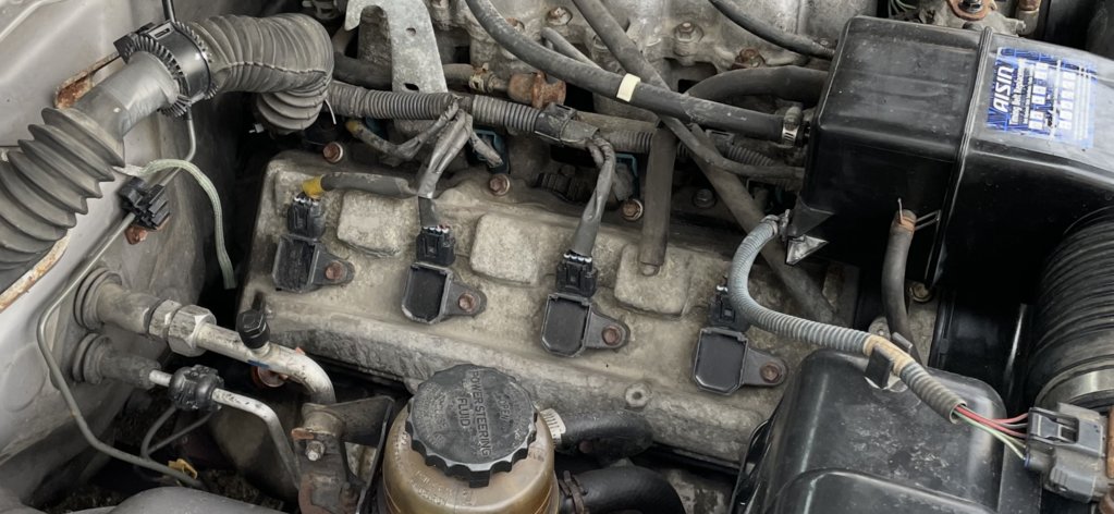

    Did another round trip to my girlfriend's out in Iowa for the weekend, same as usual. 430ish miles each way, one tank of gas each way. I think the low fuel light has burnt out, it didn’t come on when the tank got pretty low. Not surprising to me- this truck has spent a lot of time near empty.
    This time, however, things didn't go as smoothly as they have before. All was fine for the first couple hours, but about 25 miles west of Dubuque, Ia, at about 8:15pm, the #7 coil went out.
    Normally it'll miss once or twice every few minutes, give you sort of a warning. Not this time- instant dead miss. CEL flashing immediately. I keep a spare coil with me in the truck, so no big deal, right? Wrong! Pulled over, and my 10mm socket just spun on the bolt. It was super rusty. I ended up having to drive back to Dubuque to a parts store. Long story short, the guys at the O'rilleys in Dubuque were the absolute greatest. Zero hesitation to offer their time, tools, and help. The owner and manager even stayed after close to help me remove the stripped bolt. Definitely would've had to spend the night in Dubuque if it wasn't for their generosity. They even gave me a new bolt.
    I couldn't believe how kind they were to me- all I bought from them was some vice grips. That's the Iowa experience right there! Made my day.
    Sunset was nice, before everything went wrong.

    This sounds like the only positive O'reillys experience I've ever heard. In my dozen or so experiences, it's always been extremely negative. And some of the things I've heard from others on here looking for help, their staff told them or lied to them about (out of ignorance or otherwise) is alarming.
    Glad you got it sorted, and super weird about the coil pack bolt. The threads were OK in the hole, it was the fastener that ate shit and died?

    Agreed. I've only been to one other O'rilleys, but the guy helping me was clueless. All the employees at this one seemed to be friends, including the owner, so I'm sure that played a part in their knowledge/care.
    Threads looked great, they always do. Once you get it loose they always look great, the gold zinc coating still there. It's the bolt heads that got dissolved from years of salt. I forget that it used to be a very, very rusty truck.
    This photo was taken a while ago, it’s normally much cleaner than this. But check out the rust on all the fasteners:

    Sounds like when you get home it'd be good to replace all of them
    Edit: Just the bolts

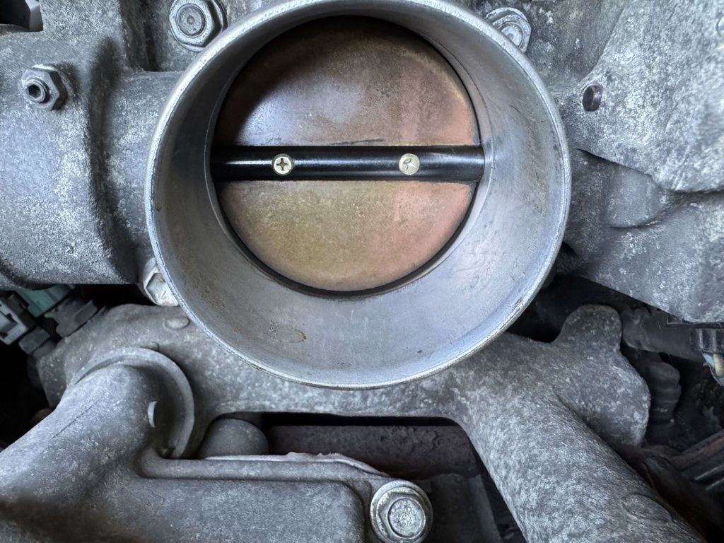

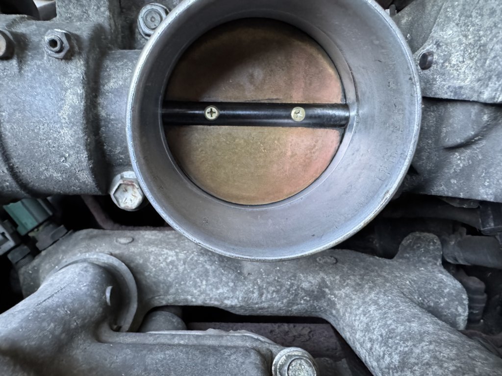

    Cleaned the MAF and throttle body today. I've been noticing that the idle isn't as smooth as I feel like it should be. Little bit suspecting of a coil but I haven't felt any real misfires. It could definitely be in my head too.
    The throttle body wasn't really that dirty, and it's been at least two years since I cleaned it last. Didn't notice a ton of improvement but I pulled the battery cable so the ECU would re-learn. Still probably hasn't fully "learned" yet. Before:
    After:

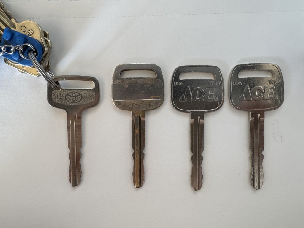

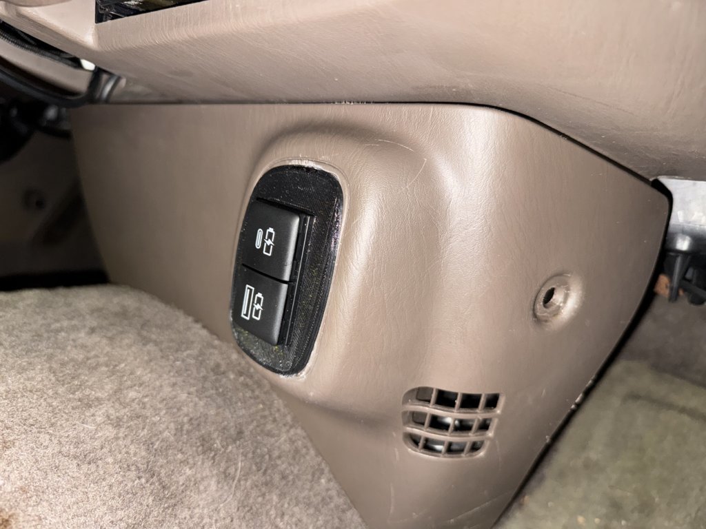

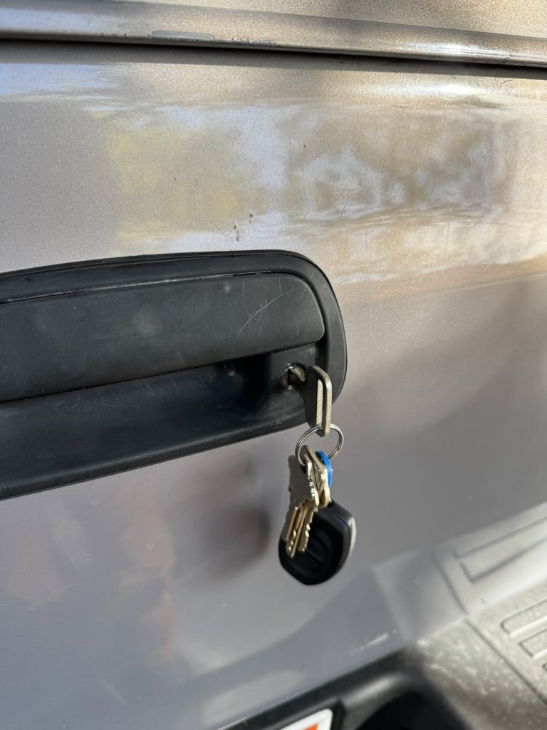

    I also realized today that my second key for the truck was too worn down to operate the door locks. Neither of the keys I had were original, they're both copies. So I decided to retire the worn out one and get the "nice" one copied. Turns out it was 2-keys-for-1 day at the hardware store, so I now have four keys that work in the ignition! I know I can go to a dealer and they'll cut it based off the VIN, but $4 at the local hardware store is a lot easier and cheaper.
    As I was testing to make sure my new keys worked in all the various locks- I noticed that you can lock the tailgate! How in the hell did I never notice this!?!? I'm sure I've looked right at the key slot hundreds of times! I've owned this truck for four years, and I've been around it my whole life!! Yet somehow it never occurred to me that I could actually use that key slot. It took some WD40 and a ton of working the lock back and forth to get it working freely, but now I can lock the tailgate.

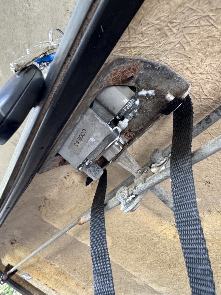

    Being able to lock the tailgate got me thinking. The bedcover on the truck also has a lock on it, but I've never been able to get it to turn.
    A key for it came with the truck, but I was never really sure that it was the right key. It took some googling but I was able to confirm that it is the right key, and with a lot more WD40 and a lot of turning the key back and forth, the bedcover lock now works freely! Sprayed some lithium grease on it an it's working smooooooth.
    I love fixing the little stuff so much. Not sure why I didn't do this when I got the truck. Total time invested was >30min.

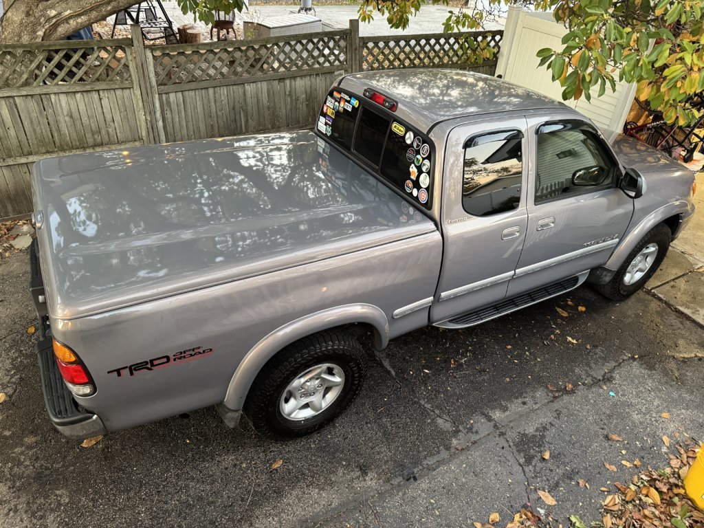

    Washed, clay bar'd, and waxed the truck this weekend. I've actually never waxed the truck before. It looks great.

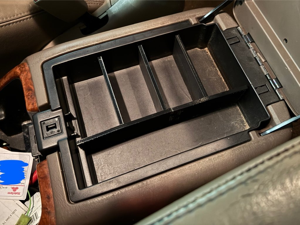

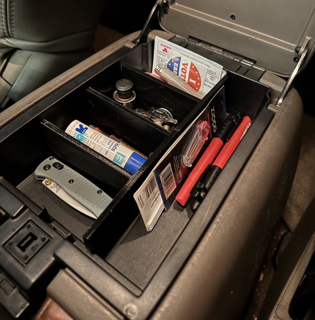

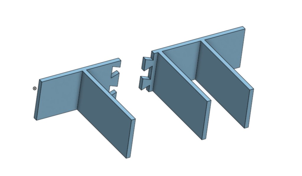

    Big news: I fixed my 3D printer. This meant I was able to design and print a ton of stuff that I've wanted to for a while.
    First up was some sort of organizer for the upper part of the center console. It was a total shitshow before- just tons of junk that would rattle around and make noise, especially if you opened the up the large bottom part of the console. I came up with this super simple and effective divider that has a spot for pens/pencils, and sections for other stuff. Works like a charm! It includes a dovetail joint, so it can be printed in two pieces. This allows it to be printed using a small 3D printer.
    It gets stuck down with double-sided foam tape.
    There is still a small gap between the top of the divider and the lid of the console. This lets little stuff like coins or paperclips pass over the top, but not anything bigger. Maybe some sort of foam would work to stop small items?

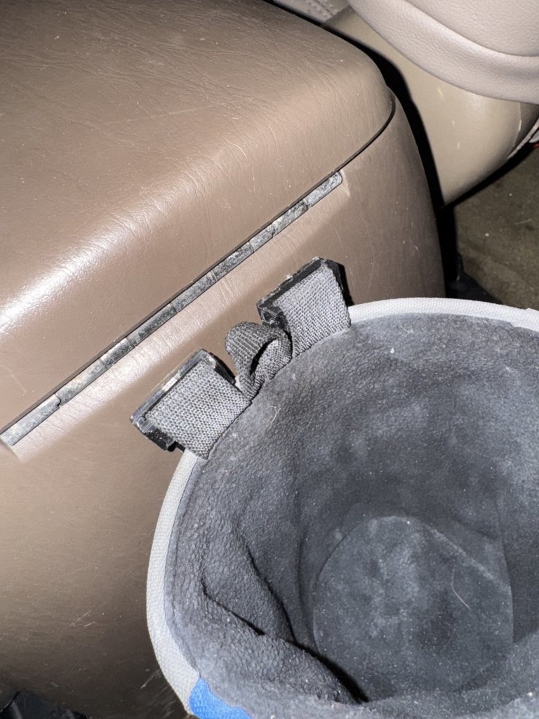

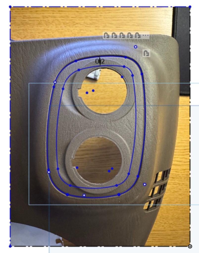

    The next part was inspired by RainMan_PNW's Lunar Rock build. He attached a rock climbing chalk bag onto the side of his center console, to be used as a storage compartment/oversize cupholder. I've been struggling to find a storage solution for my water bottles for a while- none of the cup holders in the truck are big enough for the huge water bottles I carry around. I started by designing these brackets that go through the straps on the chalk bag:
    Nice and simple. Took me 5 minutes to whip up in CAD, and they only take 40 minutes to print each. The two pieces get superglued together once the gray one is fed through the strap on the chalk bag. The large flat part gets a layer of double sided tape, and I put it on the back of the center console:

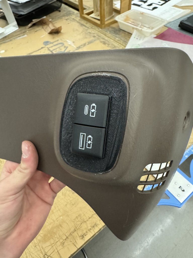

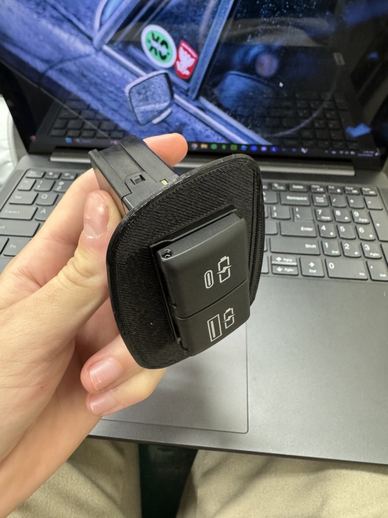

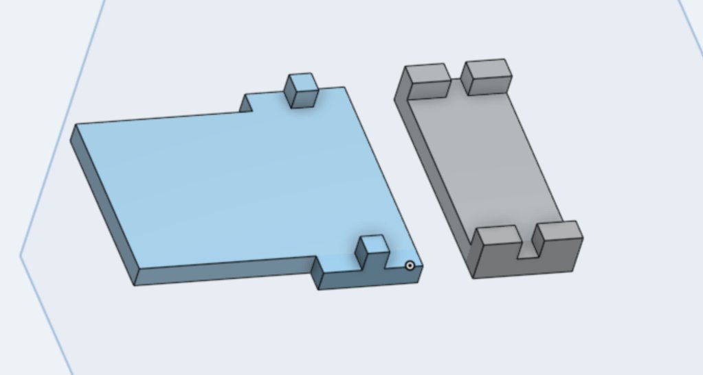

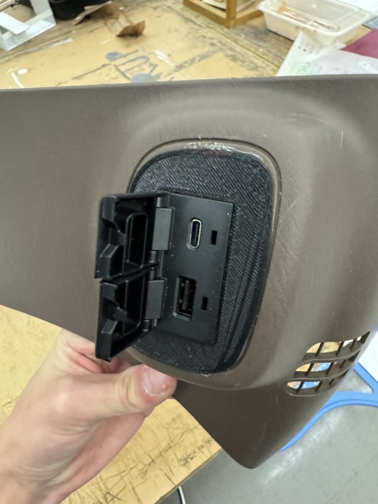

    I've also built a mount to replace the two 12v sockets with an OEM Toyota USB charger. I made a design to use cheap ScAmazon USB plugs, but those all looked cheap and had bright LED lights in them. I also don't really trust them that much to not melt and burn the truck down. Plus the OEM one is way cooler. I started by taking a photo of the dashboard piece with the 12v sockets removed, and scaling it into CAD:
    And from there I could make what's essentially a sheet with a rectangular hole that fits the OEM charger, and an outside edge that matches the shape of the dashboard piece:
    It fits pretty well, I cut a hole that's the same shape of the 3D print, just a bit smaller, so I can glue onto the lip on the print. It needs to be scaled up on the Y axis just a bit more, but I'm happy with it.
    With the 'doors' open:

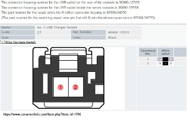

    And back in the truck. OEM part number for the charger is 85532-08040. I bought this one on ebay for $30.
    I think it really looks great. Only issue- it isn't wired up yet. I purchased a connector that fits in the port in the back, but it didn't come with the pins that fit inside of it. Does anyone know where I can find those pins? It seems to be a super uncommon connector. I had to order it from the dealer. Here's the part number if it helps:

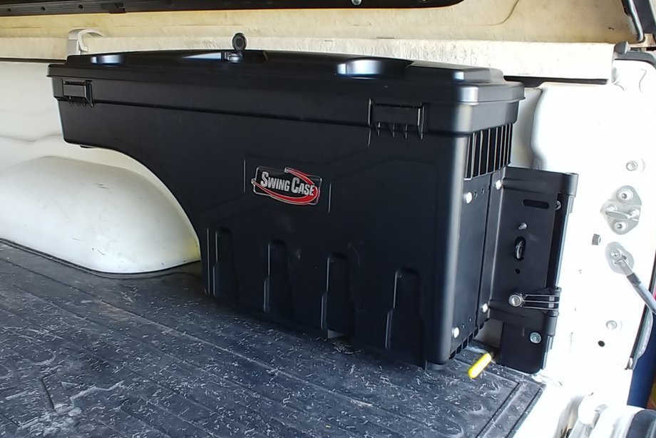

    Rats! Looks like they don't make this product for the 2002 AC.

    He has a 2002 AC but it's designed for another truck though I think. @FirstGenVol

    Correct. I bought one for a 2007 Tundra instead.

    Cool! And ouch! RealTruck has them at $399.98 for a pair. Maybe I'll keep an eye out for a second hand pair.

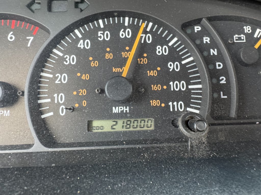

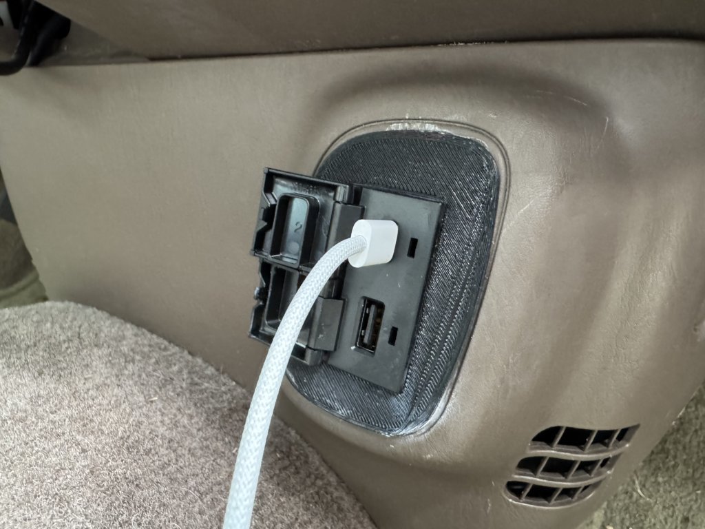

    Yet another 900 mile trip in the ol Tundra. Did most of it in the daylight this time, which was nice. Normally I’m driving there after dark, but that’s not really an issue with the projectors.
    Hit 218k. Interior is due for a dust cleaning.

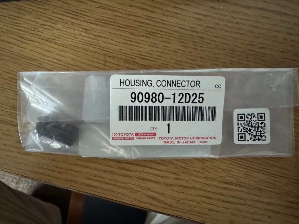

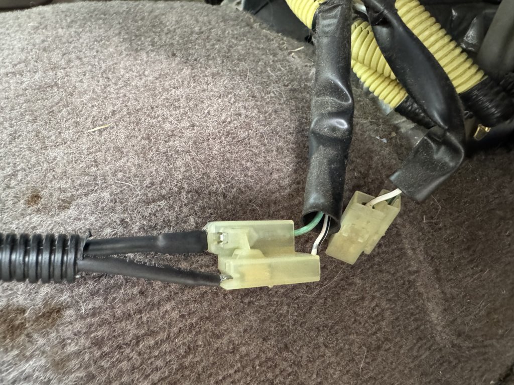

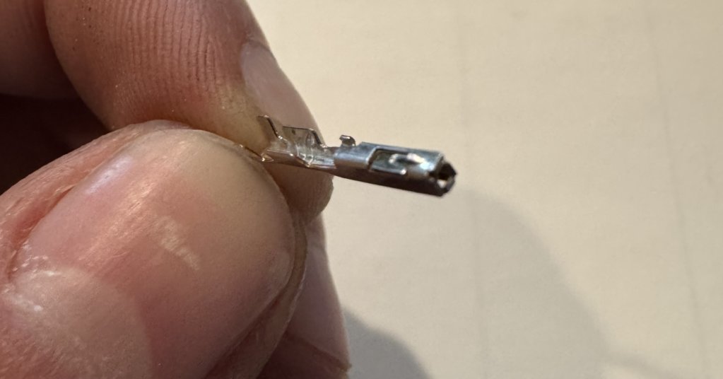

    Also finally got the USB charger wired up, I made a small adapter harness to go between the original wiring and the charger. No wire cutting here!
    I wasn’t expecting the terminals in the connector to be so small.
    Charger works good. Some of the glue I used created this white residue, I think just from offgassing as it cured. Need to clean it off.

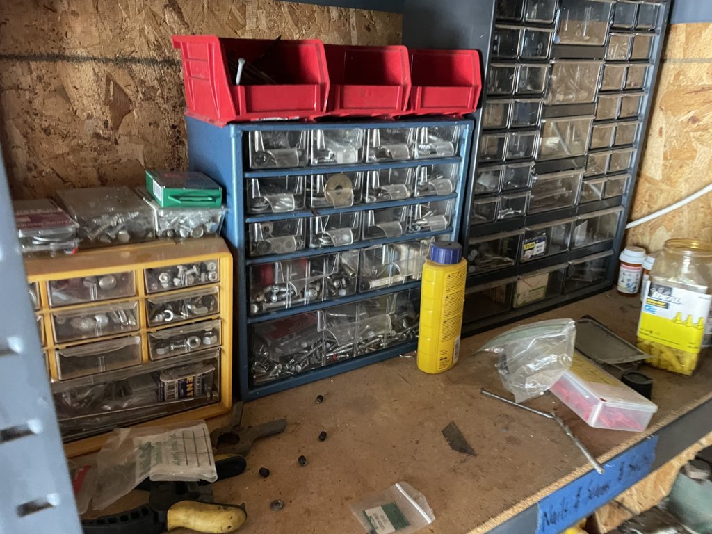

    Need a better storage solution for wiring stuff. This doesn’t work well, if you couldn’t tell. Open to advice. I’m thinking a large tackle box with a spot for the strippers/crimpers and small organizers for terminals and stuff.

    Hit eBay. Search: Vintage Raaco Drawer
    Lots of different styles. Far surpass quality of anything made today but priced the same. I use one that has a long bottom drawer, two rows of semi-wide drawers, and lots of small drawers above. Super flexible.

    I own three of those. Didn’t realize they were from that specific brand until now. They’re my bolts/nuts/screws.
    I like that idea a lot but I need something more portable. Something I can bring onto my boat, into the house, etc.
