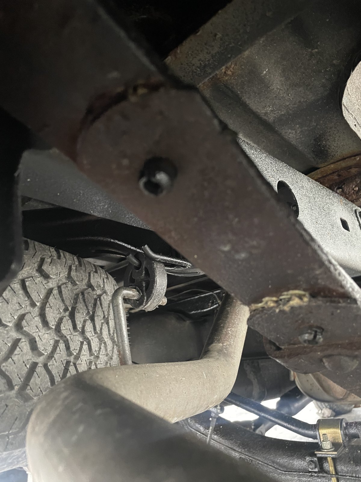

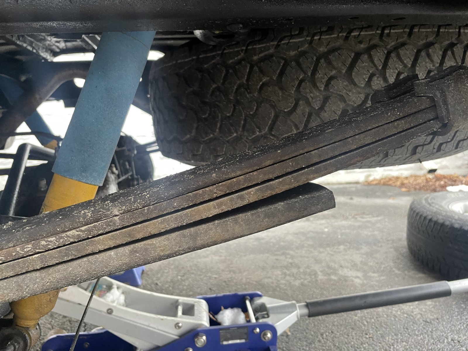

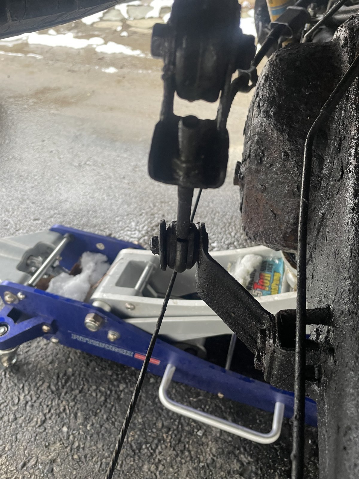

    So I took some measurements and some photos and took it for a good test drive and we’ve got a problem. The problem? I can’t find the problem!
    The outside of the drums is the same different from the frame on both sides, and the distance from the axle to the spring hangers is the same on both sides too. The frame is fine too. Even though it was most certainly shifted to the side last night. The truck also drives completely normal.
    Here’s the only stuff that I found wrong:
    The LSPV bracket is bent (indicating that the axle definitely shifted)
    This leaf seems to be splayed out more than normal
    And these gaps in between the leafs seem a lot bigger than they were before. I don’t know anything about leaf springs, is this fine?
    My dad borrowed the truck and drove it 30 miles or so before taking these photos. Is it possible that the springs could’ve worked themselves back into place? They still pop going up/down driveways more then they have in the past but less than they did yesterday.
    What’s our thoughts?
