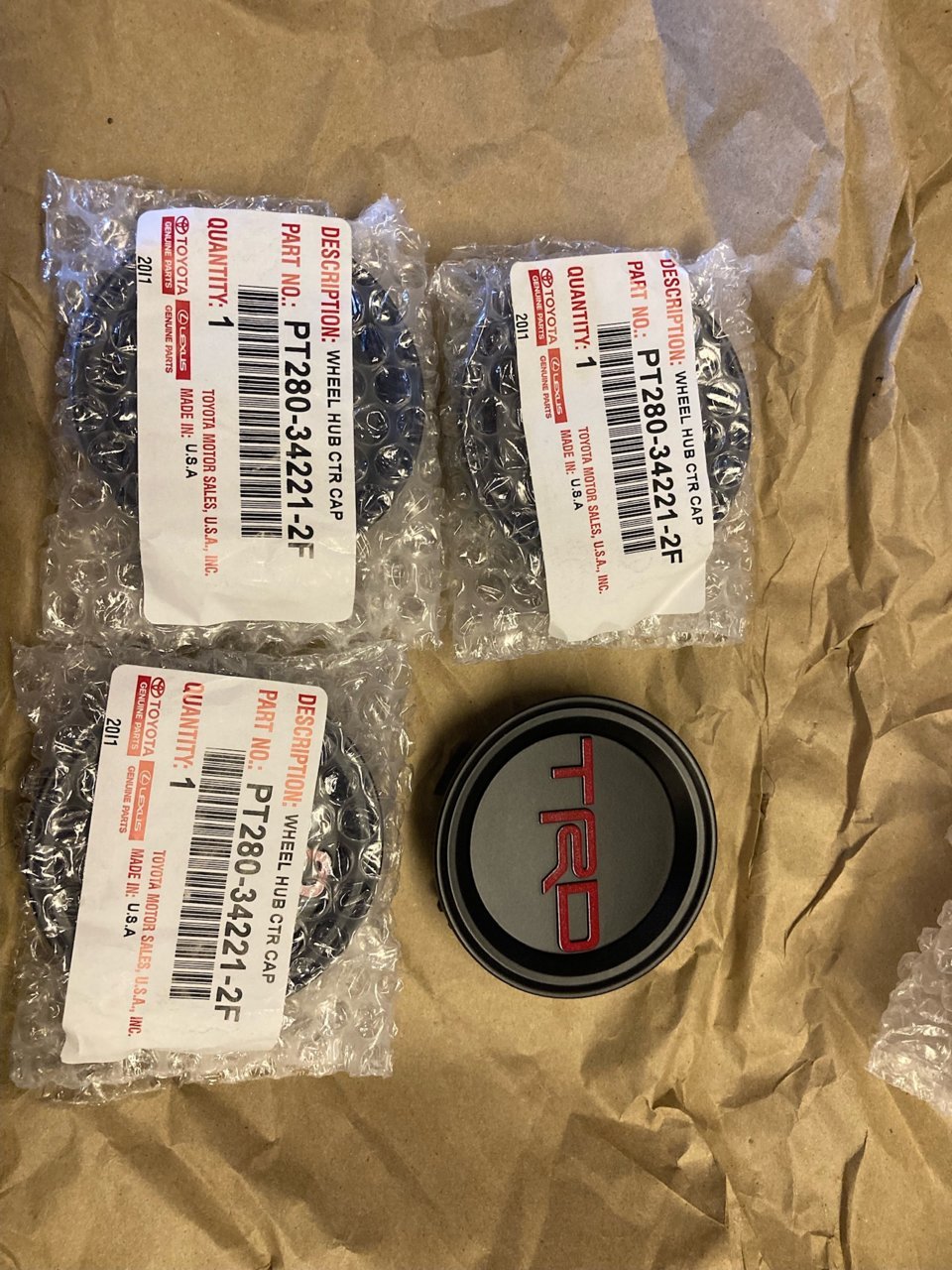

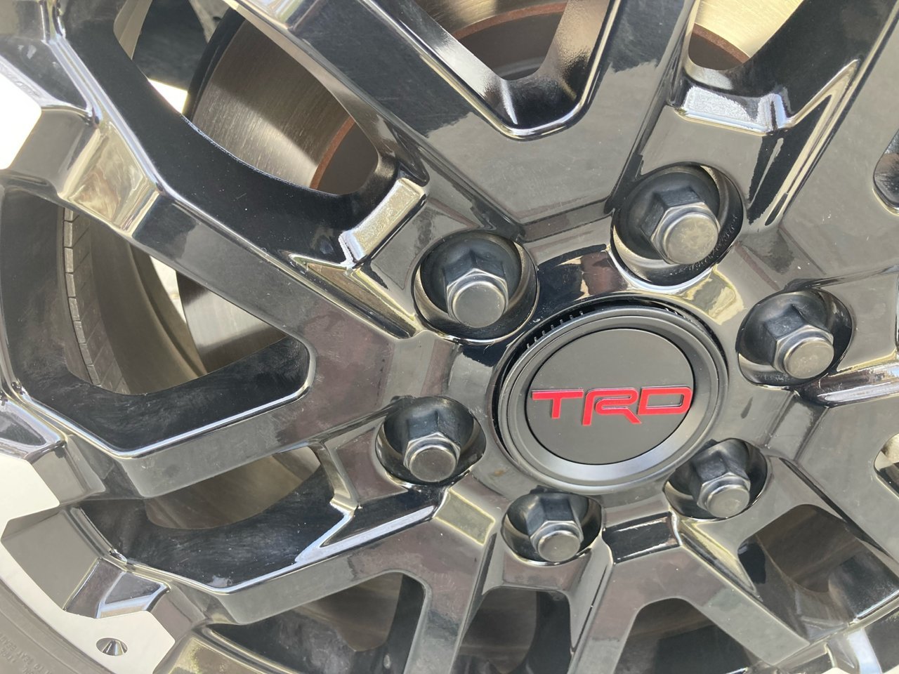

    Here’s an update, I ordered the black and red TRD center caps PT280-34221-2F from Tacoma town online after getting a verbal confirmation that they would fit my 18” wheels on my 2022 SR5 off road. Just received and tried them, they don’t fit. The grease cap sticks out to far/the caps sit to deep in the rims. I’d still love to find something with the same look if anyone has any suggestions. PS even after confirming incorrectly that they would fit, I’m having to eat the cost of shipping.535E46C2-65D1-46B1-ACD1-D8525D75DA95.jpgC55B9969-1170-4D9B-8FDA-ED7E41FA639D.jpg

    It looks like we have the same wheels, do you have a picture of your new centre caps pushed all the way in? Mine seem to be the exact same design, different part number, I’m assuming because mine didn’t have the red ring, and they wouldn’t push all the way in, hitting the grease cap.

    Don't have a pic, but they snapped in tight in the rear wheels I tested them on. Double checked that they fit all way around - very snug. Front wheel may be different, but you could just dremel the plastic clip somewhat where needed if it's hitting the hub. Seems there might be a difference between the ones with the red ring, and ones without, when fitting on 18s, but not sure.
    I am putting my TRD caps on new 20" TRD wheels so didn't test the fronts.

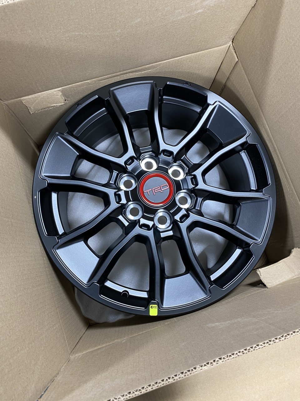

    Are these the 20" sport package wheel? I love them, but can't find them on the Toyota build site.

    Those are the 20" TRD Off Road wheels that come on USA trucks optioned with the Adventure pkg, and NA in Canada.
    Ordered mine from the US when my parts guys couldn't even find the number in the system.
    They will be mounted on the truck tomorrow with 275/65 Cooper AT3 XLTs.

    Can confirm that the red TRD center cap PT280-89210-F2 will not fit the front 18" silver and black TRD rims due to the ?grease cap? behind the rim. The TRD caps are probably 1/8" - 1/4" thicker in the middle than the stock ones and will not lock into place...

    Don't think so, there is no way that i can see to modify the back on the new plastic cap without destroying it as its hitting in the middle of the cap against the hub grease/dust cover behind the wheel. The only option i can see would be to modify or remove the hub dust cap.
