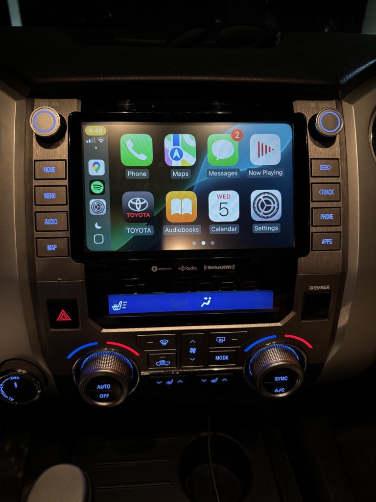

    **Update**
    Got my harness from auto harness.com. Sourced me a headunit from eBay for just under $500. Installed this evening.
