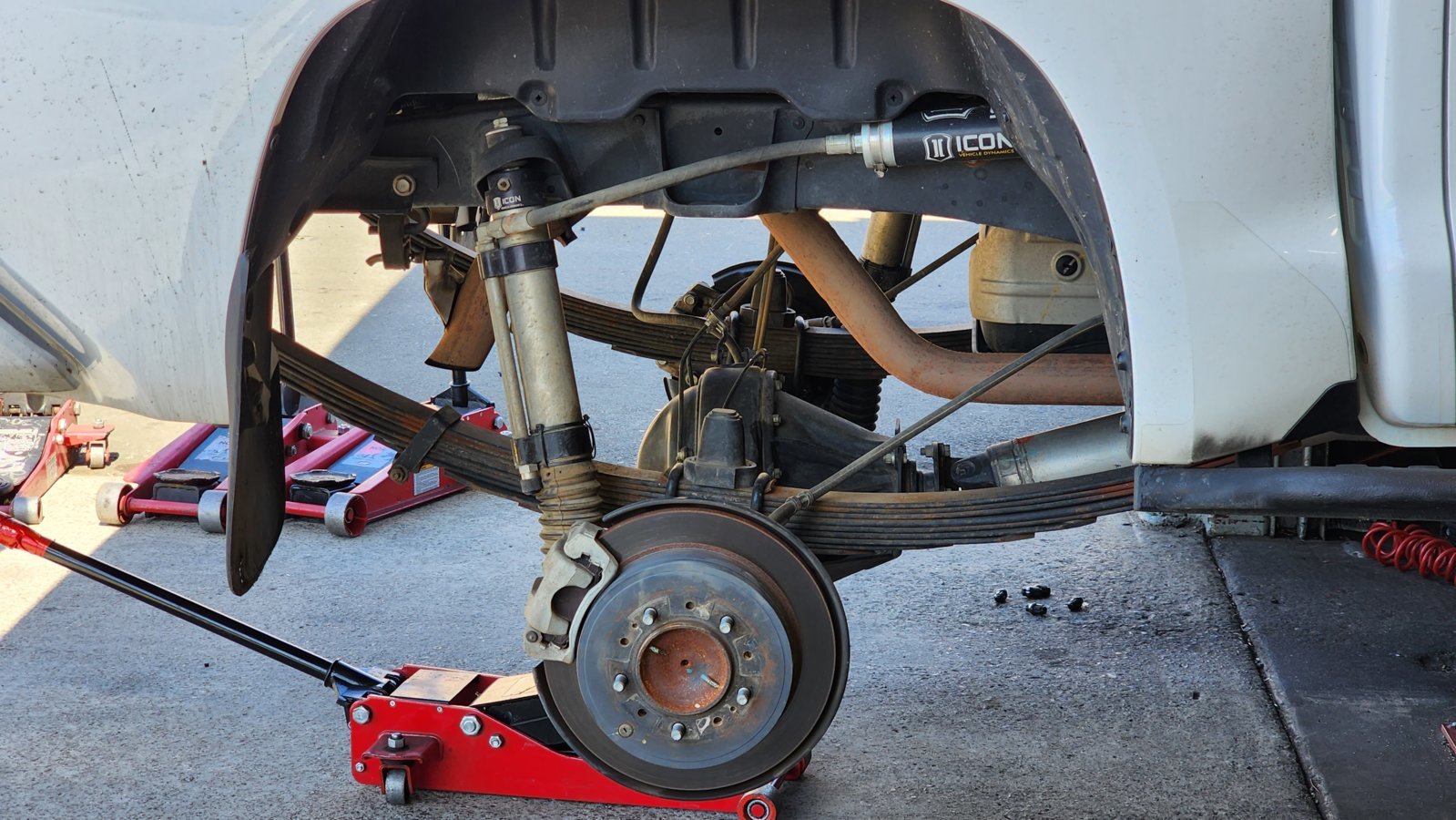

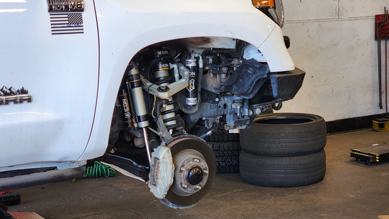

    Might try an ICON midtravel like mine... 3.0 coilovers with 2.5 omega S2, 2.5 Omega rear with RXT leafs. not shown is the rear 2.0 hydro bumps

    ^^That'll do, too!
    SAGE63 and reywcms like this.
