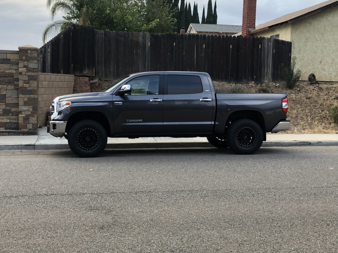

    You can add rake with a 1.5 shackle or block. Seems most are using shackles now. Mine is a 3/1.5 on my 18. No TSS issues, no CMC. I also have the TC UCAs.
    Kings would be my setup of choice. But between Toytec/Kings/Icon i don’t think you can go wrong
    Here’s my setup. You can see the rake here as well.
