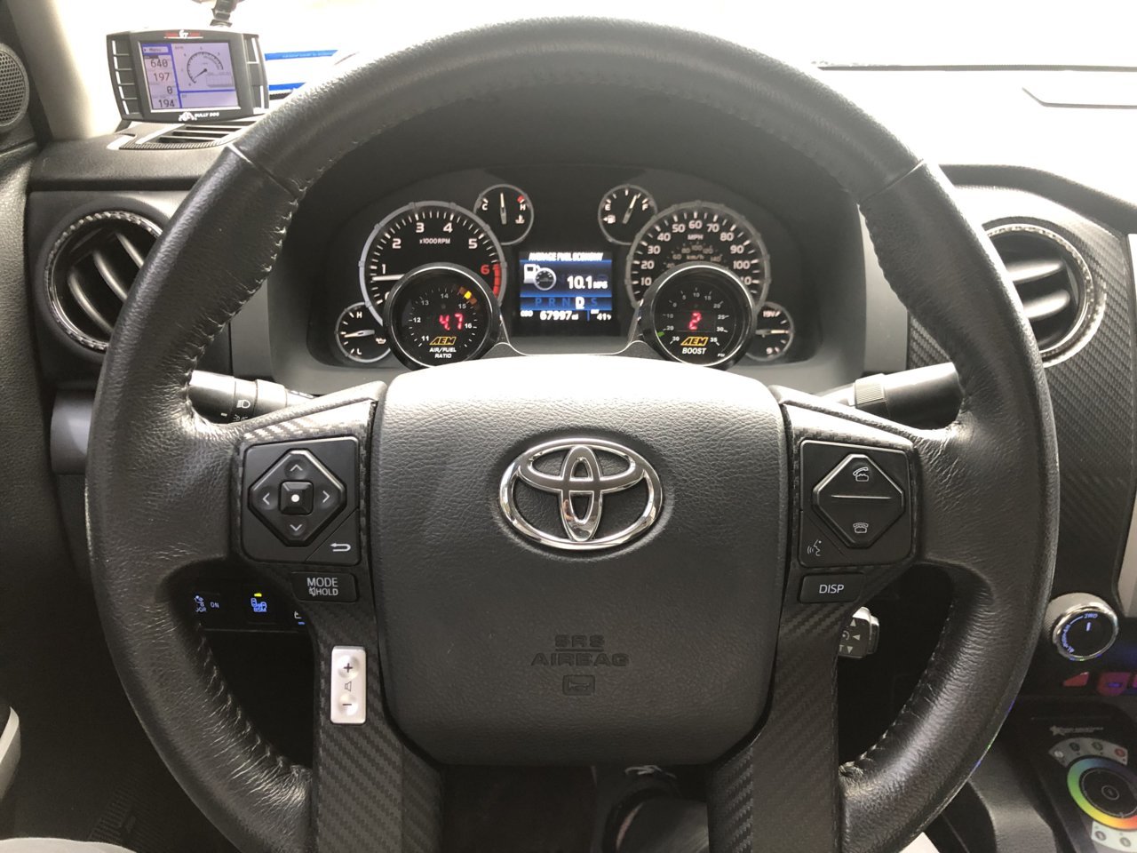

    My MPG has already gone up another .6mpg during my first 300 mile drive. Still need to work on my tune and do a few other things. I think I can get it back to 12 mpg.

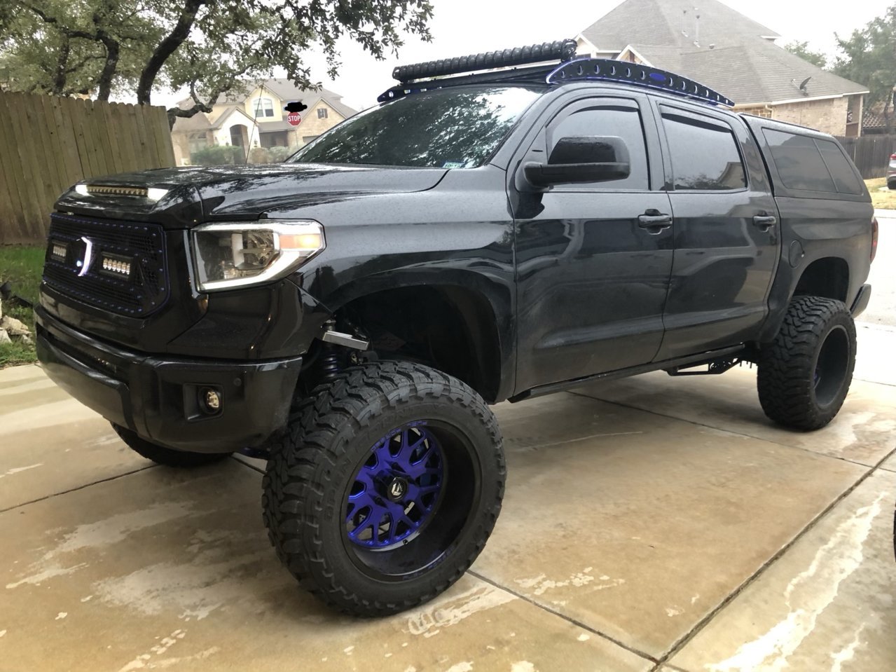

    I’m loving this new ARE camper! I like the look of it and all the extra room for storage.

    Its looks great. And as always your attention to detail is impeccable, lol....blacking out the street name signs, nicely done.
    How's the view from the rear, I know you put in quite a bit of effort into rear facing lighting on your truck. I'd assume you could move those lights to the shell if needed. That thing is gonna looks bad ass all lit up inside too. I'm really starting to warm up to the idea of a bedrug, even under my tonneau. How do you like it so far?

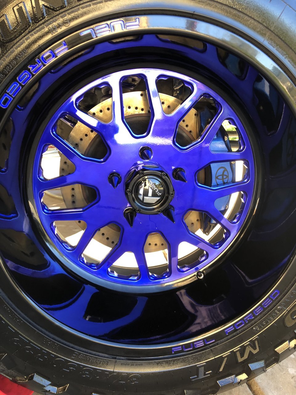

    My new TRD big brake kit is so massive compared to the stock size rotors.

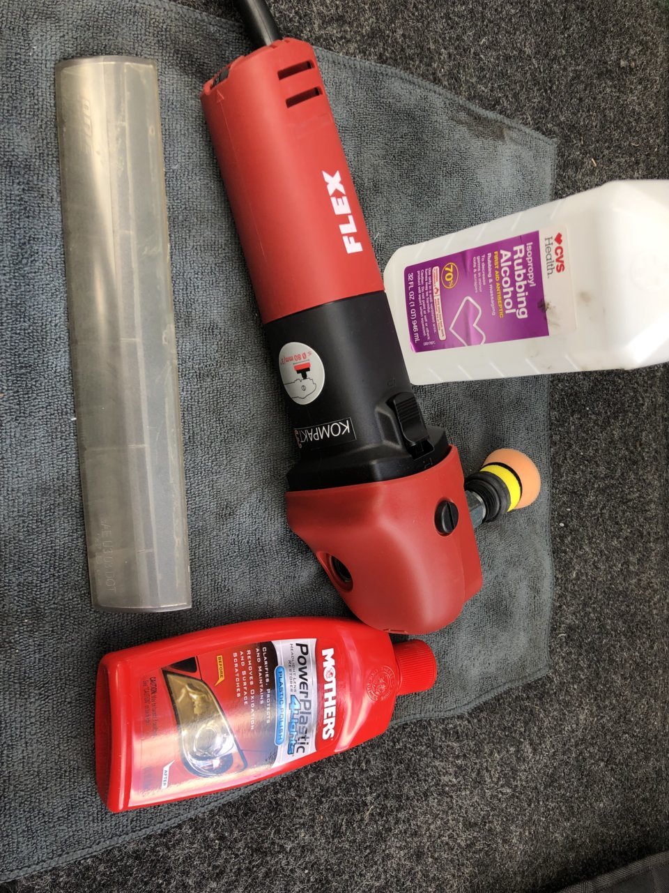

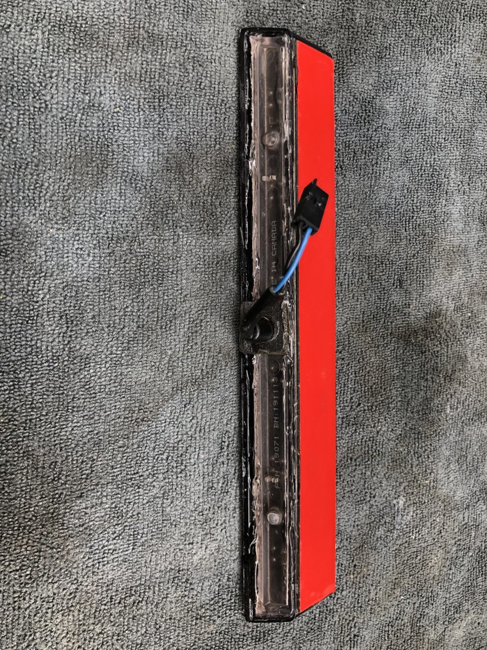

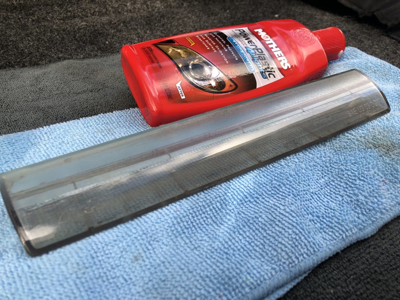

    My third brake light on the ARE camper shell was hazy and had moisture in the lens. So I took it off the shell, removed the old 3m tape, cleaned it with rubbing alcohol & then used mother’s power plastic cleaner. Plus I finally got to use my Flex polisher for small projects like this. The Flex did a great job! 09A54DE7-02EA-4A0B-B0C7-C358657105DB.jpg
    The right side of the lens is after one polish of the mothers. The left side is before doing anything.
    Both sides after cleaning.
    I sprayed the lens with a spray paint tint from a hobby store.
    Then I re-sealed the lens with new silicone. Reinstalled 3m tape.

    Installed and done! No more moisture can get in the lens. Now my tinted third brake light will blend in with the shell. 4C40174F-B5B1-4D5D-8177-31AA3A52DA42.jpg

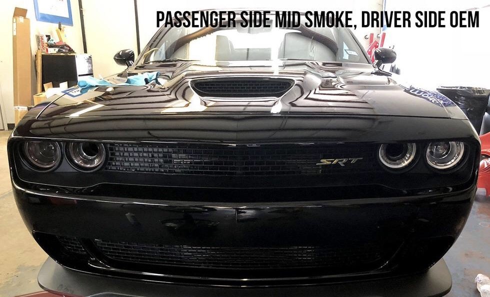

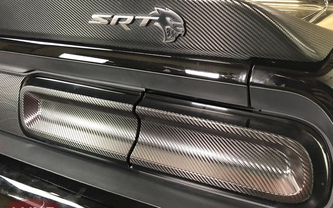

    I ordered some different vinyl samples from Dark, mid and light smoke to go over my front led light bars and a few other lights. I think the front of my truck will look more stealth and unique not seeing the silver led reflectors as much. I’ll post up some pics after I get the install going and done. The manufacturer also makes carbon fiber, satin & honey comb pattern vinyl to wrap lenses. Here’s a few sample photos for reference. 927EC68D-5BC7-4AD2-9EA4-A616A5CC00C5.jpg
