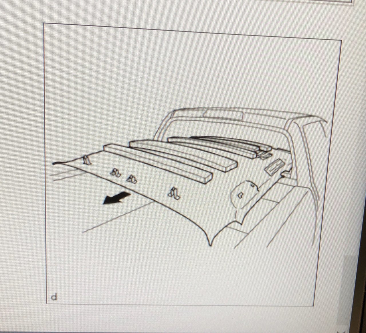

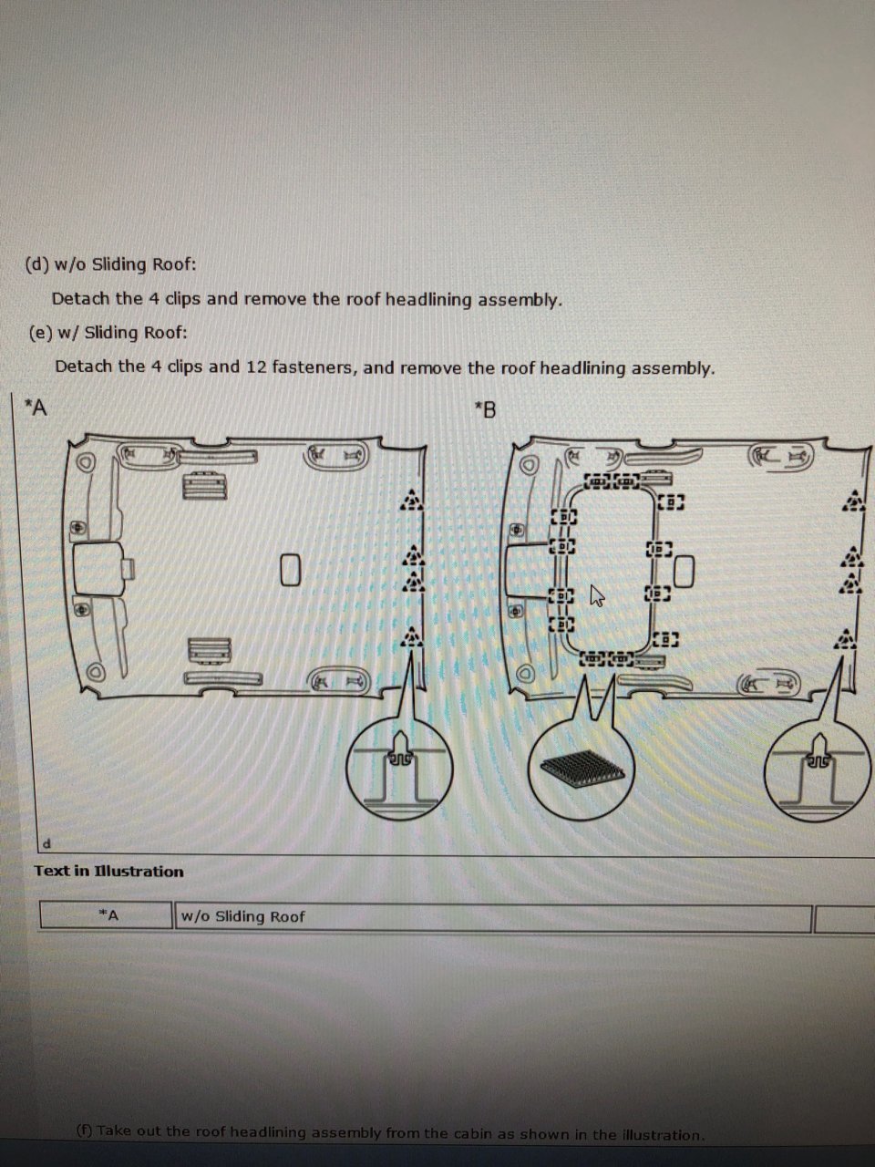

    Here is the information on clips for the headliner on a CM cab and how to remove it. B9D6E0EB-B6F4-45AF-BB9B-7372C3F25B50.jpg C9257254-5DF7-4746-947A-296D99FDF968.jpg

    Awesome, Thanks! Been debating on whether or not to Dynamat the roof but I hate removing headliners. Now I'm going to tackle it.

    Good deal. The biggest pain is removing the handles on the roof. Make sure and roll your rear window down first. You will also want to disconnect your battery since your working around the side curtain air bags. The rear clips near the back window are plastic clips. If you have a moonroof it’s just velcro holding around the edges. There will be some torques screws hidden behind the clear light lenses on the ceiling. It’s not as bad to remove as you may think.

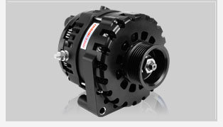

    I ordered a 240 amp alternator for my build. This is the biggest alternator they make for my 17 Tundra. I’m also replacing my battery and battery tray. Alternator does take 3 weeks to build. I like that you can select the color of the alternator. It is a direct plug and play replacement but the pulley is a little smaller. So I will need to change my belt with a 1/2” shorter belt.

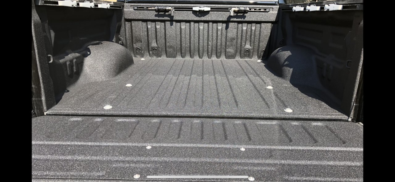

    I had the bed of my truck re sprayed today. It was looking bad from all the construction and paint materials that have been in it. So for $200 cash it looks like new again. 8ECCC3AC-BA85-419F-8409-BF5C45072E23.jpg
    aperezsh, airosey and Skippy like this.

    Based on your statement about the smaller pulley I'm assuming that it's a Mechman alternator? What belt will you be using? I was thinking of doing the same things. Also, what battery tray and batteries will you be going with?

    Yes sir. I’m going with the Mechman 240 amp alternator. It’s $424 painted your choice of color. No tax unless you live in TN. I don’t know what belt yet. I figured that is something I won’t know until I have the alternator in my hands. I’m going with Savior Protected Showcase 27 battery case and I have the Shuriken AGM 2400 Watt battery. I’m pushing the size of battery for the tray so I may have to change my battery if it doesn’t fit. I’ll know for sure tomorrow when my Savior Protected tray arrives.

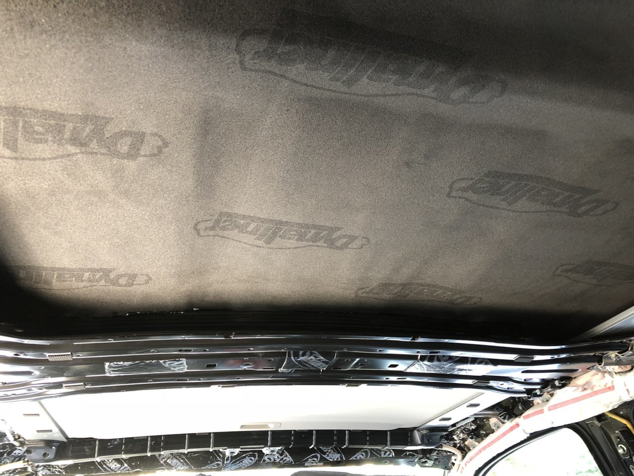

    Yes sir. The 1/4” dynaliner made a big difference in the heat transfer from the outside heat into the cab. I still have my hood liner down still and when I place my hand on the dynaliner it doesn’t feel hot like it did before. So I would definitely recommend sound deadening and dynaliner if your thinking about it.

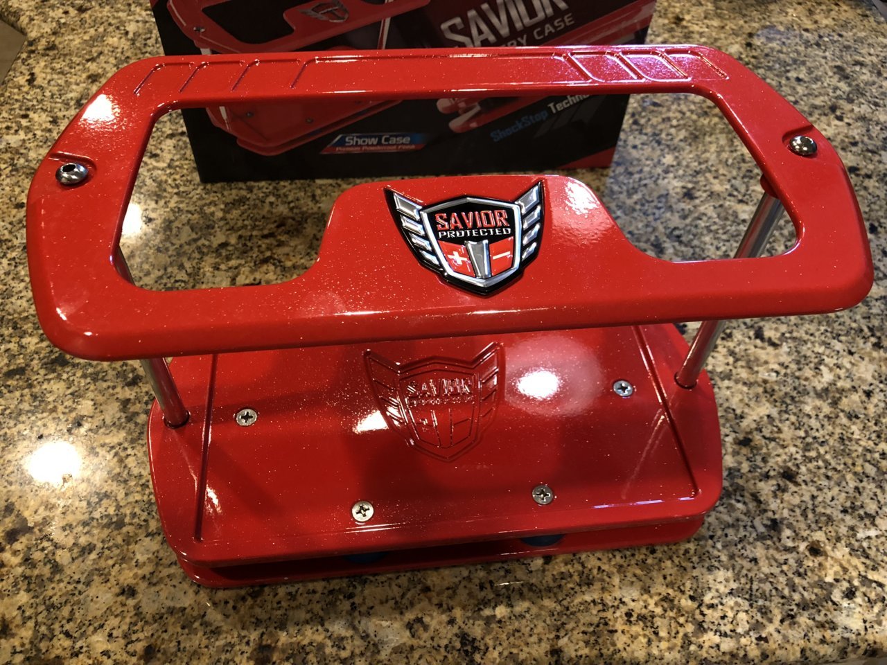

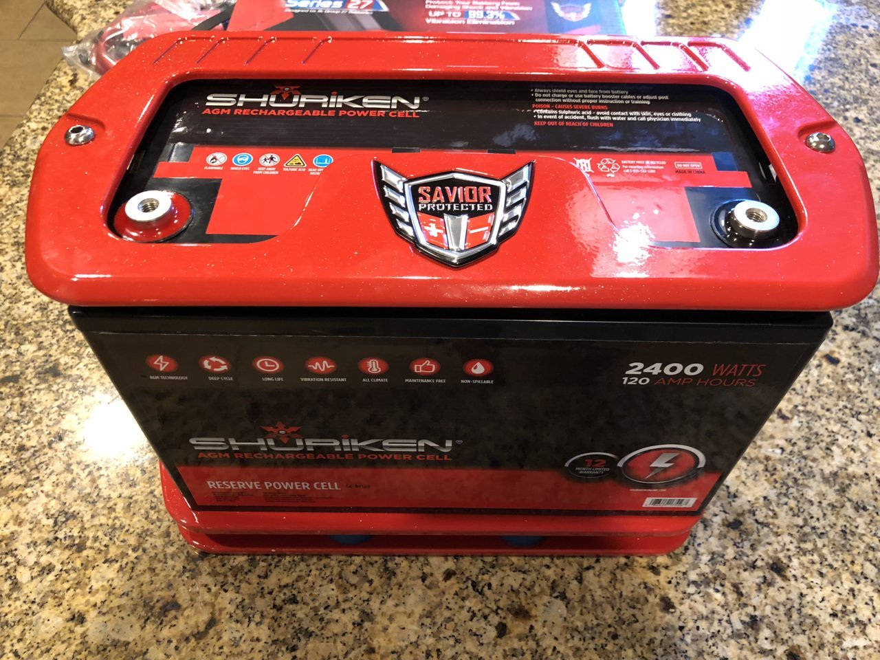

    My new battery and Savior Protected case arrived. It looks so good! Very happy with the quality and looks! 54B0070A-5B62-4365-BB4F-8FC06587B553.jpg 488929BB-FFC5-4B41-9A81-7C0CDE7C1A4A.jpg
