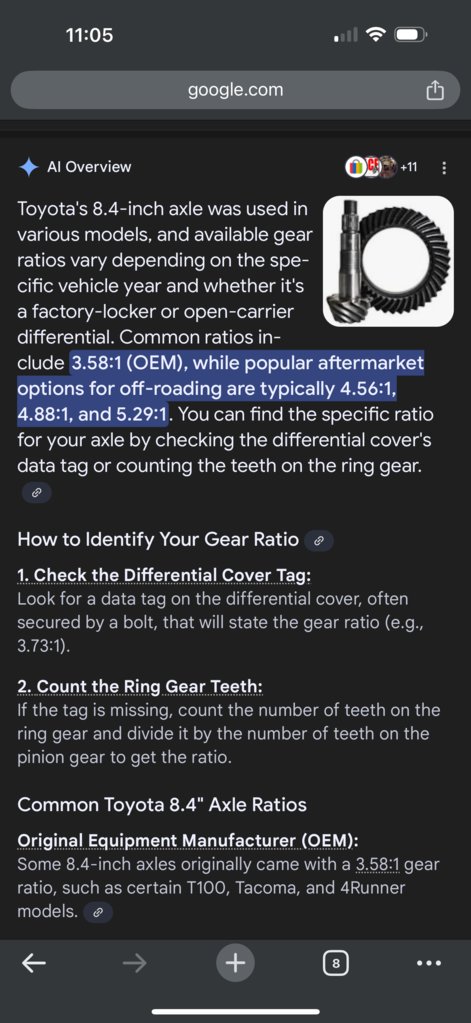

    New goal?
    My personal best: 225mi/10.9gal = 20.6mpg (60mph, freeway, flat'ish land).
    Above results from: 265/65r17 OEM size tires, 2wd v8 but a tonneau cover and 4.10 gears.
    The gears and tonneau seem to net me about 1-1.5mpg more at freeway speeds.
