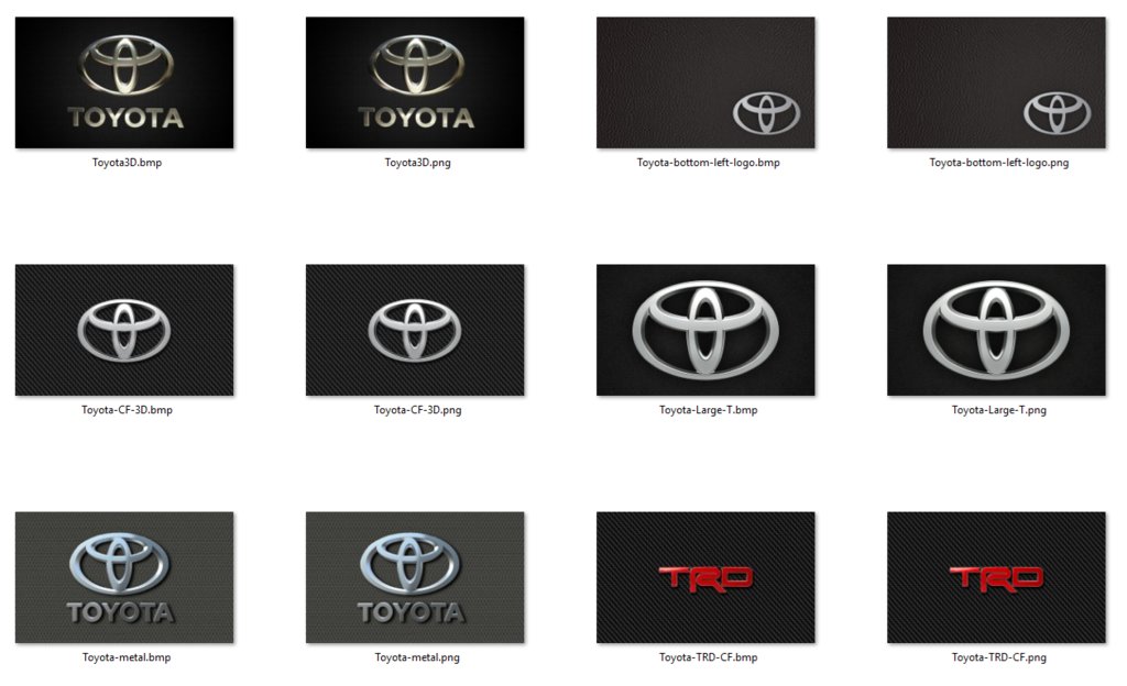

    Speaking of screens, in case it's interesting for anyone ... I'm attaching a ZIP file here with a bunch of Toyota/TRD wallpapers in 800x480 resolution. It seems like that's the native resolution of the ilx- W650/670/770 and the 407. But The 507, Halo9, Halo11 all seem to use larger/variable resolutions.
    It's possible other brands use the same resolution, or will trim these to fit also. Screencap of the ZIP contents here, there's a BMP and PNG file for each, look below the images here to find the ZIP file to download all at once. And yes, I don't know my left from right. Momma always told me I was a little bassackwards.

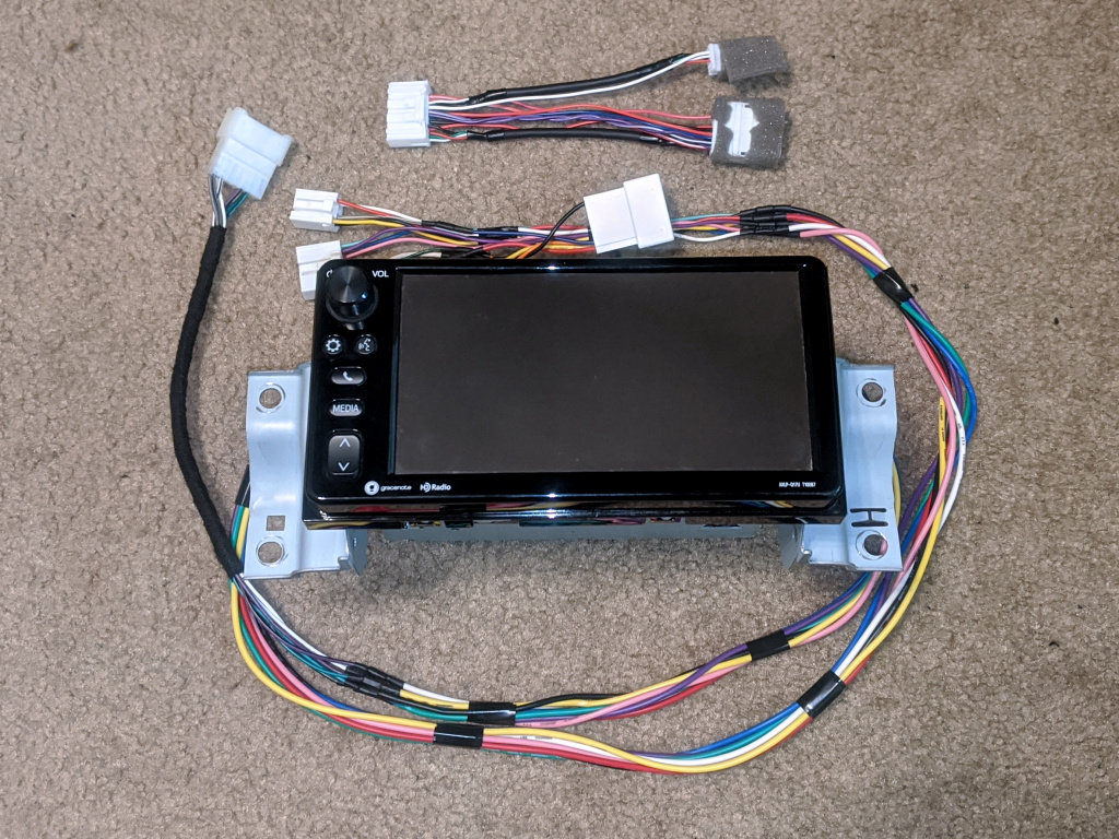

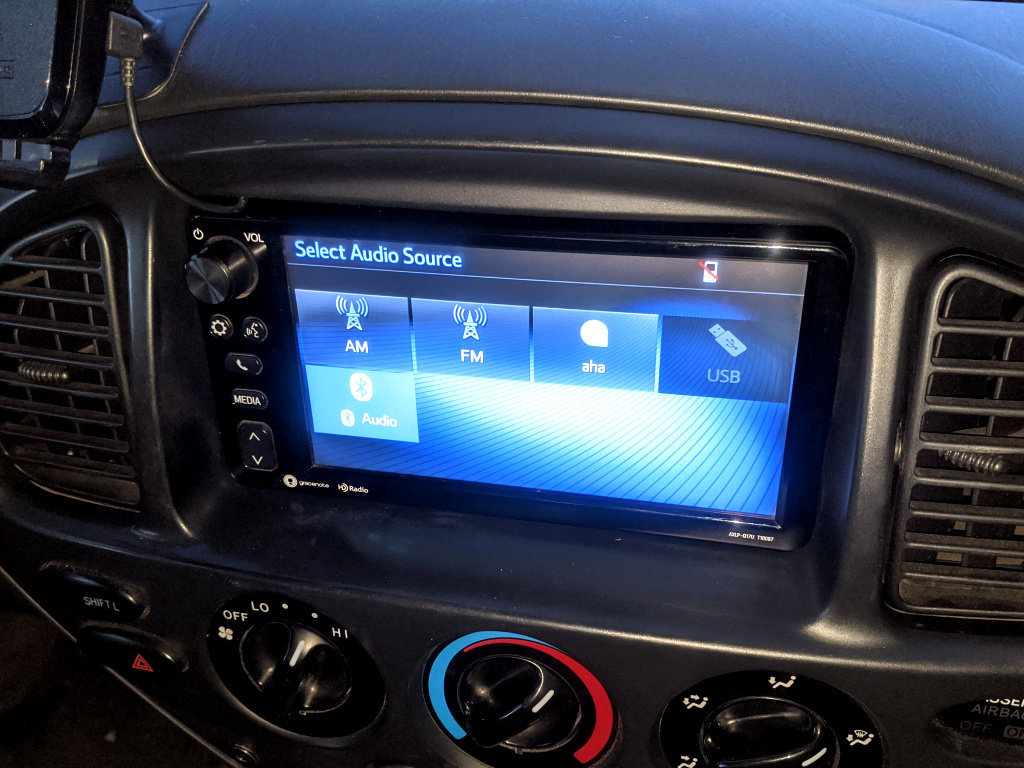

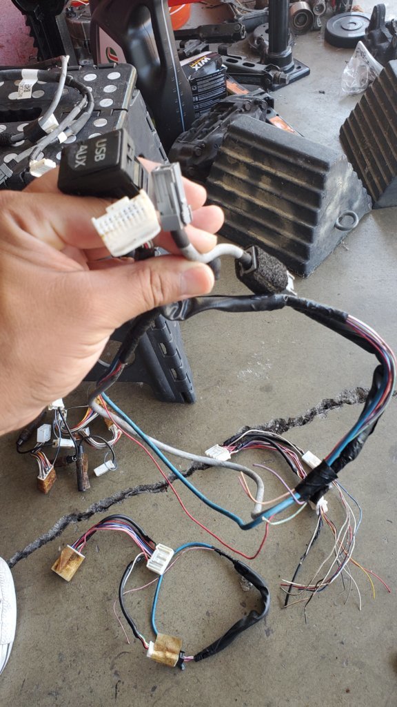

    Curious about the Toyota 86 radio retrofit, so couple questions [things not so apparent fr/ur pics], if you dont mind:
    1. Actual Display housing looks like it fits perfectly thru the HVAC cover bezel [looking at part online, noticed it has a rectangular black plate behind the display head. Does that get covered by the HVAC cover bezel ?
    2. Looks like wire harness needs minor mods [thx @Shifty], butotherwise is your USB/Aux interface operational [and did it also require wire mod] ?
    3. Otherwise is it all good w/SoundQuality, Settings Access, EQ Memory, BT, etc ?
    4. Tundra oem amp By-passed?
    Though im still aiming at Alpine ilx507, it seems to have near 10% not happy to truly pissed users....a bit worrisome for almost $700.
    Understood that this Toyota 86 radio may not have all same features, but Toy usually has great QC on things like this before they build-into a million vehicles IE: at least what features Toy claims, usually work 100.
    Thx for a reply.

    1. Correct, bezel fits great. Rectangular portion hidden behind.
    2. I think either myself or Dan @empty_lord gave that info to @shifty`. I never hooked up the aux/usb or mic for handsfree calls. You have to buy the additional connectors/parts for that.
    3. Yes, waaaaay better than the original radio and amp. I had non-jbl 6 speaker OEM setup.
    4. Bypassed the amp.
    In the settings I select 'iM' for the vehicle. Gave the best sound/power.
