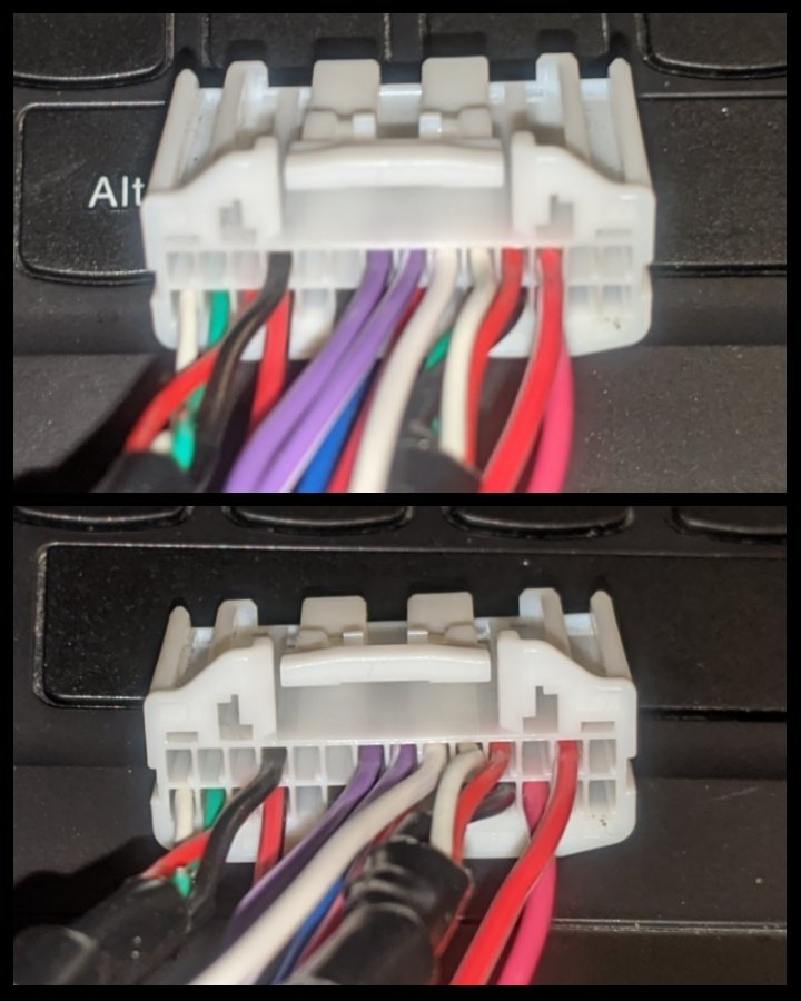

    I’m not well versed in radio, but I’m guessing that’s the connector for all the components? Which it is different than the other.
    I should say, same connector, but different pinout.
    Some of the components and feature are different. No GPS, different mic size, no wire for speed sensor and different setup for steering wheel controls.

    I can now confirm that l was able to use the Axxess device to maintain my steering wheel controls and so far I’m really happy with the alpine 407. I was able to use the wiring I had from my previous ready harness and have it hooked up and working great.

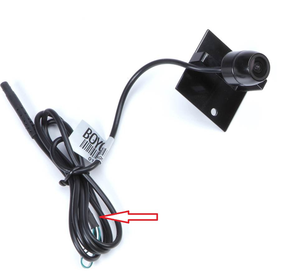

    Most half-worth-shit cameras come with a wire loop or two, one of which you can cut to reverse the image from whatever the camera outputs. More info in the installation instructions I provided over here, see the 3rd image specifically and read its associated text.

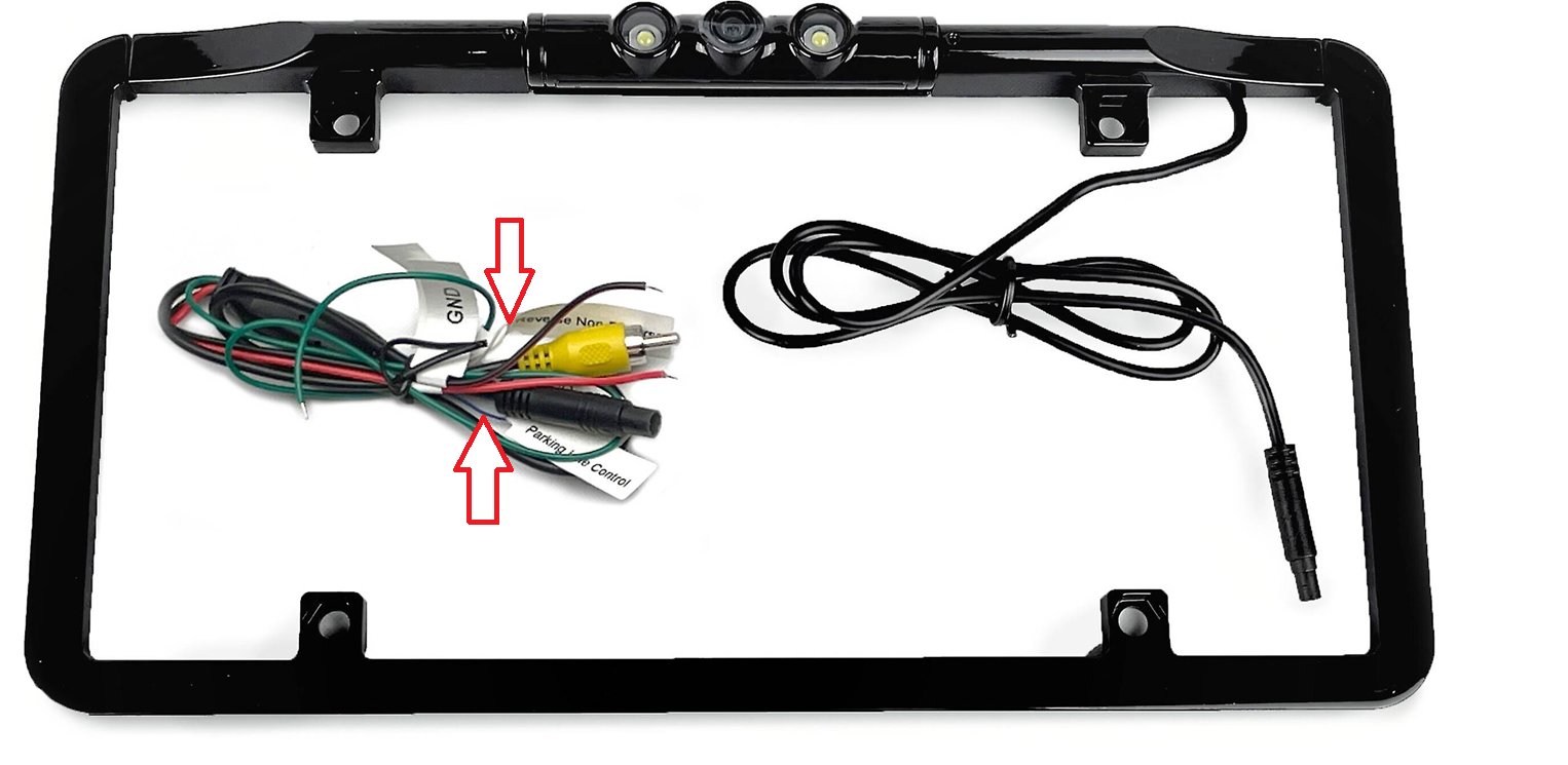

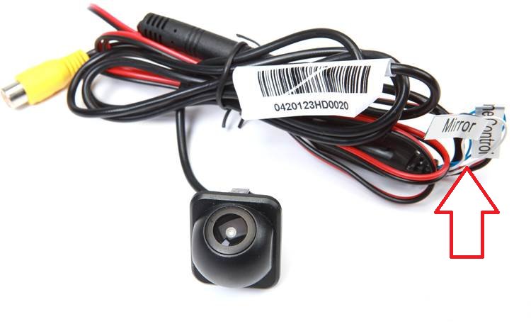

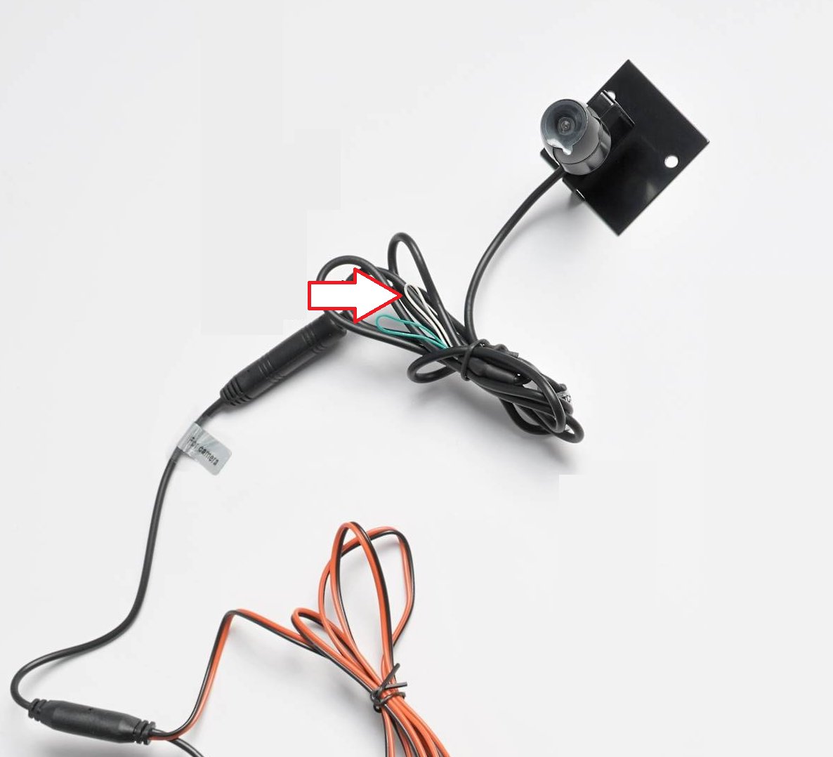

    Backup cameras I've installed, typically:
    • Have the camera on a 'tailpiece' of some sort (modular connector on one end, camera on the other end), so if the camera dies, you just replace the last few feet of cord with the camera
    • Usually have the looped wires you'll want to cut for modifications somewhere on that tailpiece, on mine I believe it was within inches of the the modular connector end
    • I'd start hunting from the rear of the camera, up to the modular (typically round) connector
    • It can vary from vendor to vendor, you may need to look on the stereo end also, but most companies don't want to waste money on sending those wires all the way to the head unit
    Here are some pictures showing a few different cams from the camera to the modular connector, and highlighting the wire loops with a red arrow.

    Awesome, thank you.
    Mine is the license plate frame type, sort of like the last photo. I'm about to head out for the 4th but I'll be crawling around under my truck looking for the wiring on Sunday.

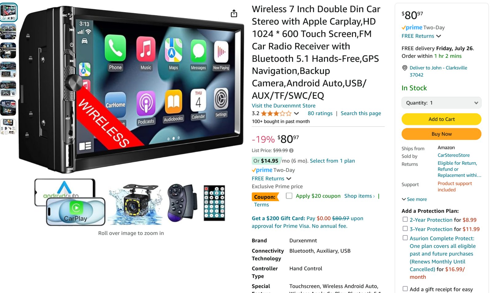

    so i bought this cheap head unit from Amazon seem like a nice unit so far just finished the install of just the radio side of it will do the backup camera this weekend hopefully had to modify tho opening on my outer bezel few minutes with the dremel and a steady hand i managed to make it fit in the opening this evening so far it powers up nice and has decent sound in my regular single cab will know more by this weekend

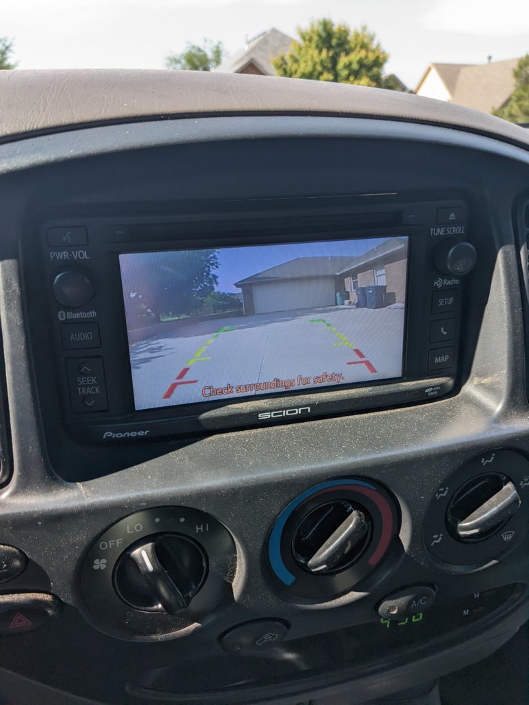

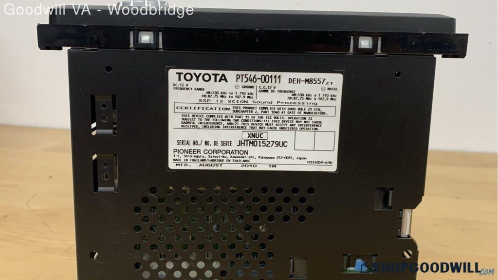

    You can also get any radio from a Scion. It is plug and play. Here is one I put in a DC I used to have. Some also have bluetooth

    I've got a similar one, made by Pioneer for Scion (/Toyota), and it even has preamp outs and stuff. But I don't need it. I bought it as a "if I buy another Toyota and I want to stay OEM, maybe for the kids' first car" and whatnot.

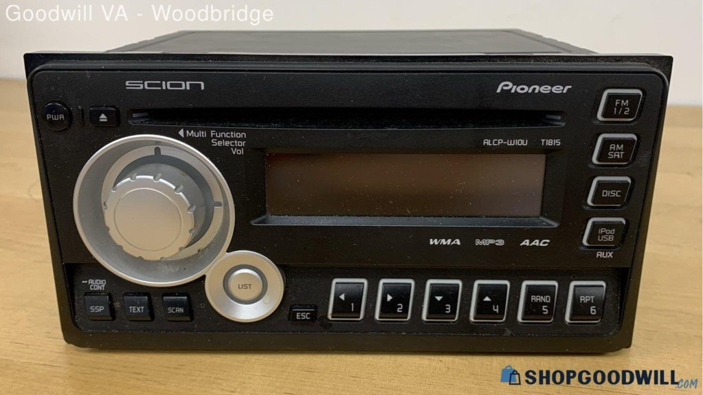

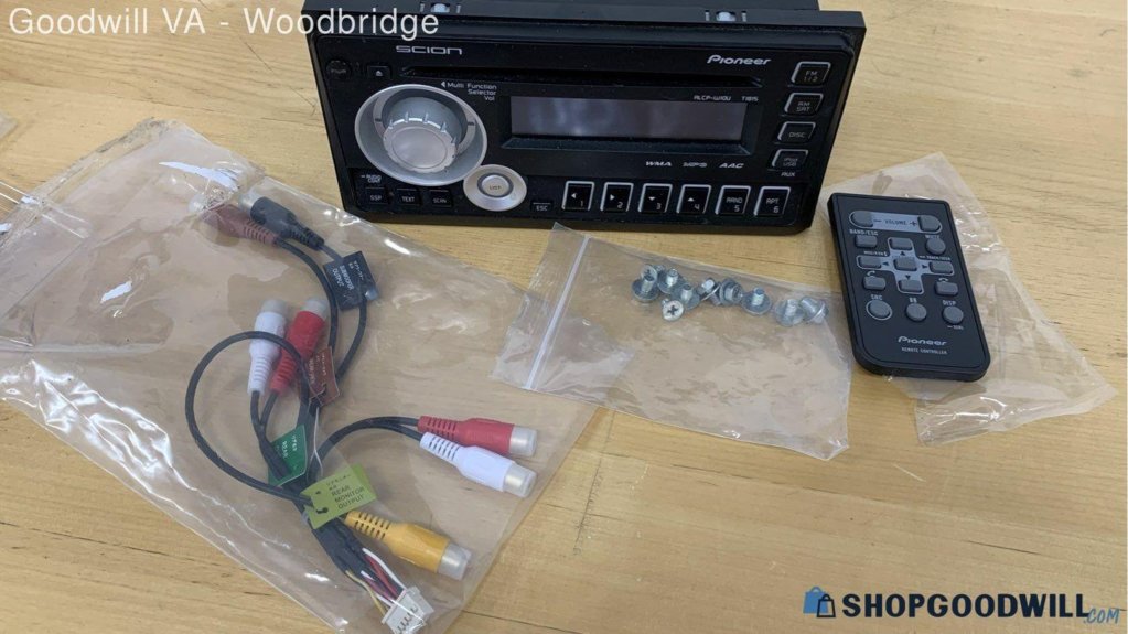

    Toyota has been using (generally) the same radio harnesses starting in 1987, up through the years of the 1st gen Tundras. I know with the newer touchscreens, like the one some folks use from the ~2017 GR86, there's one or two wires you need to swap in our harness to make it work. But generally speaking, many OEM Toyota radios are like the scion/Pioneer unit I bought, having two different harness options in the rear: One (or pair) of plugs for amplified system harness, another for non-amplified system harness. I think I marked up the image below correctly.
    Like, this is the radio I picked up for ~$30, as shown. It's not touchscreen so not in-line with this thread, but same general year I think (2008-2012), and with the mp3/iPod support, plus RCA in, plus USB in, plus rear video monitor out (I think that's what the yellow video out is), and subwoofer/front/rear RCA out, it made for a compelling buy knowing I've got to get an older Toyota for the oldest kid to drive soon. I want them to have access to a cool system, but not necessarily have the distraction of a touchscreen.
    Actually, I'm curious on the rear monitor out, I guess I should confirm that 12-pin RCA connects to the 12-pin port next to the amp harness on the rear of the radio, eh? I assumed it was reverse cam when I saw it, but where would it display output on the head unit? Hmmm....

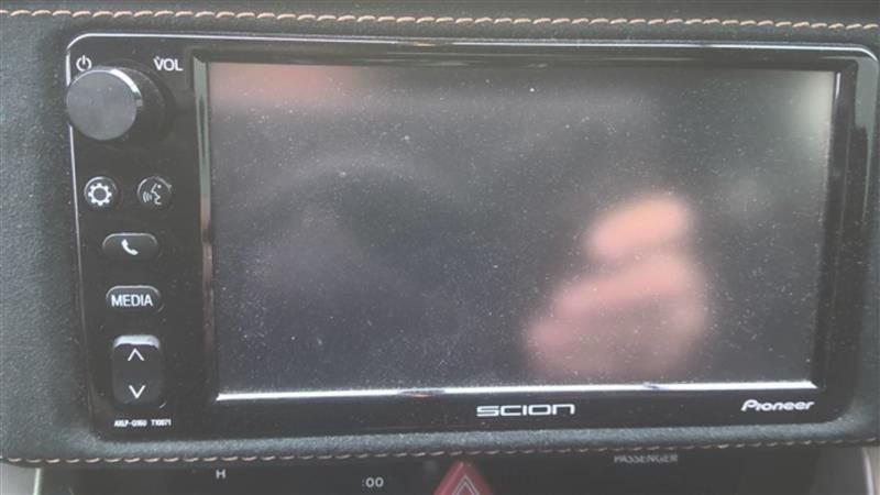

    Here is the one I will get next. Single volume knob and no cd so bigger touch screen. This one can be found in the newer Scion.
    The Black Mamba and shifty` like this.
  20. Mar 30, 2025 at 9:42 AM
    #350
    ps8820
    ps8820 New Member
    Mar 28, 2024
    #114453
    532
    joe
    06 SR5 AC 2WD V8 BktSeats
    Freshly Killed Piezo Buzzr!
    Yep, that [one in #349] scion-pioneer unit looks compelling based on cost.
    Except for fitment, since it looks larger than the radio port of FGT dash panel.
    If you already installed, any pics?
    AND
    Is the daytime screen visible?
    And is the DIM function based on an ambient light sensor?
    Presuming the sound quality was more than adequete, but w/or w/out an external amp?
    Except for lack of a wireless connection, looks quite usable for many FGT owners.

    Same dimensions as the Toyota 86 radio. Fits the newer bestgen dash with the larger bezel.

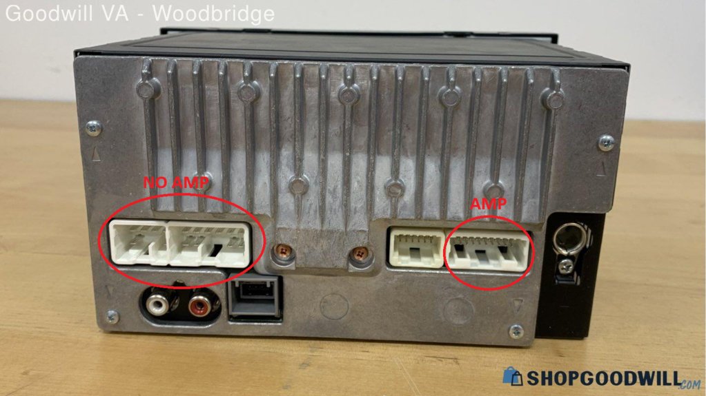

    Tiny rework needed.

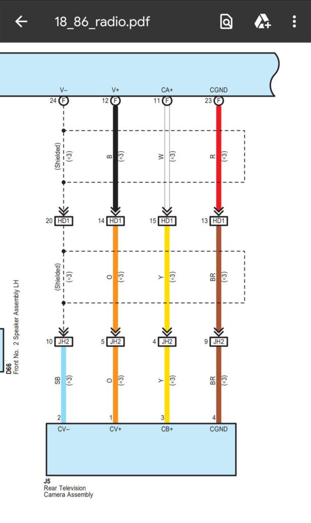

    Sharing what was shared with me in the past. 2 pics, then 2 PDF attachments after the pics. Covers the pertinent details.
    1st pic here, note the reposition on the red wire shifting 1 pin over. Basic re-pin.
    I've got a 2017 radio from an 86 ready to install, but opted to stick with the Alpine, and recently updated my W650 to a W770. I guess I'll be saving the 86 radio for a future Toyota/Lexus or something.

    thx @Shifty. Very timely info.
    If I had SWContols, I'd try it. Obviously 'do-able' but with necessary wire terminal mods, otherwise 'appears' to be a clean fit.
    I read thru the UserManual and attached here if anyone wants to see its full spec/operation. Basically, a Pioneer 16watt @ 4ohm, but relatively up to date features, BUT, unless I read wrong, only Wireless for AA. [?]
