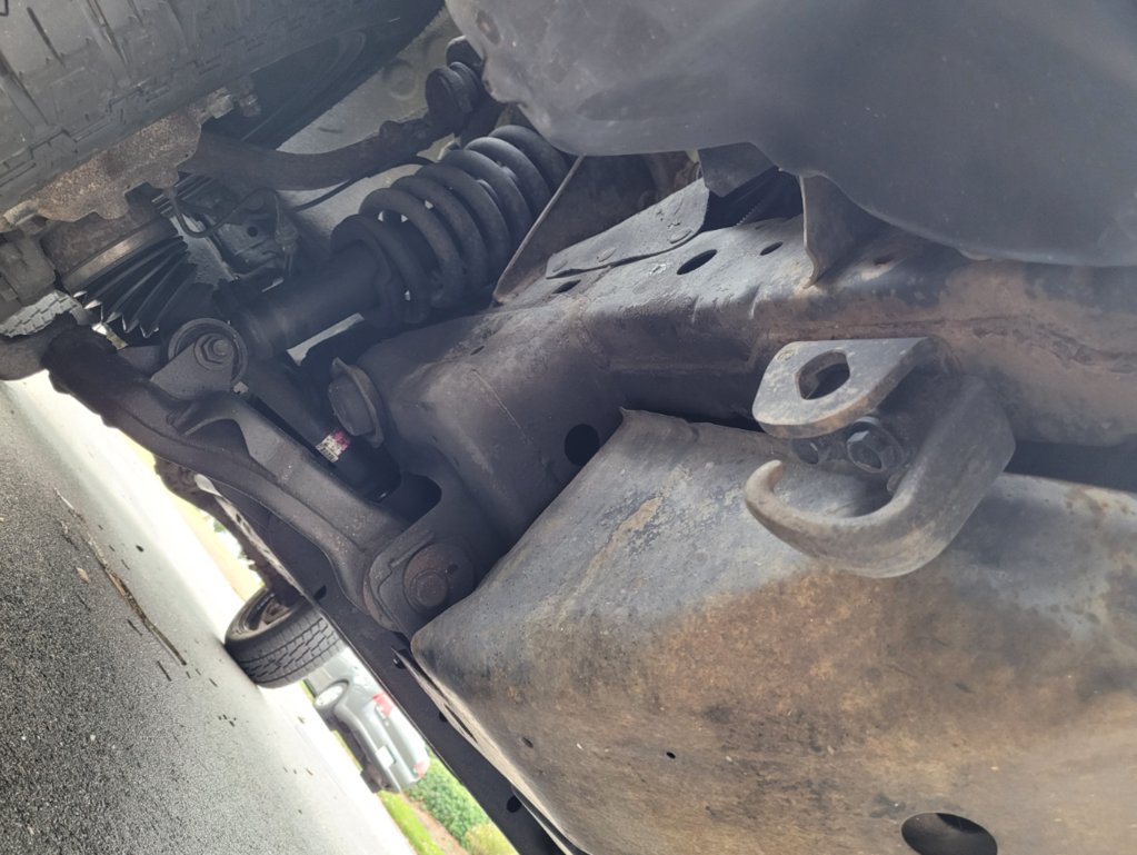

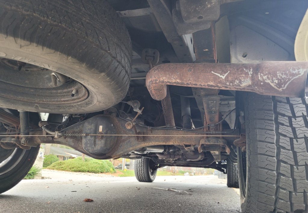

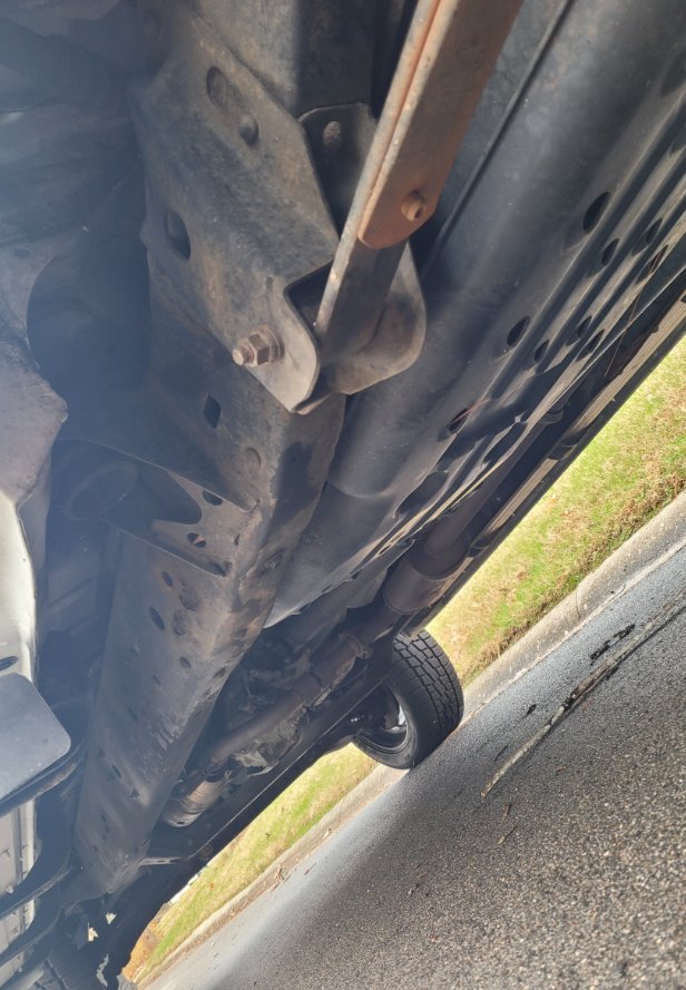

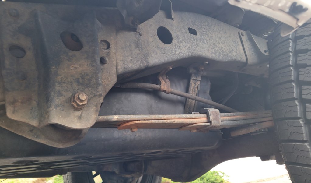

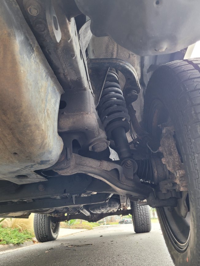

    Looking to purchase a first gen
    none yet

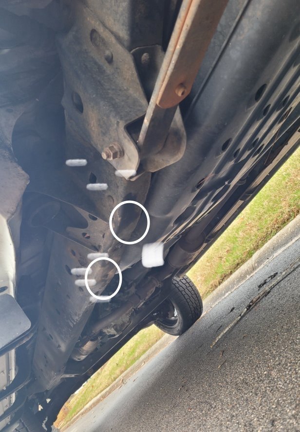

    Hi Everyone, long time reader, but new to the forum. I'm actively hunting a 05-06 tundra crew cab, 4wd, no rust ( as everyone else is of course). I'm in talks with a gentleman with a 2006 crew cab, and I'm aware of what to ask and look but feel hesitant with easily identifying how bad a frame is or not. The truck I'm looking at is from Virginia with 201,000, priced at 10,500.00, what's everyone's thoughts on the frame? thanks!

    Pics don't look bad, but I'm just a guy in Texas looking at a screen. You need to learn what to look for and go see it yourself.

    thank you Sir, I've read it many times! I have it printed out! hahaha First time posting but long time reader! Just hard trying to try and buy something I cant drive to see, I'm trying to make the best judgement by pictures to then make the commitment to fly for review.

    Just from the pics you supplied, it wouldn't scare me away. My undercarriage looks better, but the posted truck looks much better than others I've seen on here. I don't see anything to cause me concern.

    Thank you for you're response it's much appreciated, Hopefully I'll be posting newly purchased truck pics soon.

    From what I can see, not much concern since it’s mostly surface rust. However, you may want to capture the inside of the frame rail at these two points. The frame should be perfectly straight and I see there’s the characteristic bulge of delamination going on in these two areas. Can’t be sure unless you take a photo.

    Those pics don't look bad compared to lots of the carnage we see on here. Certainly worth a look in person. But that one definitely advances to the next round of the "Looking for a first gen" playoffs.

    I've give it a 7-8 out of 10. I don't see anything there requiring immedaite attention, and while @Jack McCarthy is 100% correct with what he's recommending, you can technically pop in new stiffeners if bad. Price/etc. sounds good.
    However, point of note: You need to very carefully, very closely look at the framerail where it kicks up at an angle, just below the master cylinder. This is a common fracture/failure point, even on frames that look this clean.
    I wouldn't hesitate to buy that at the price point for one of my kids, but I'd expect the timing belt/water pump/tensioner would be done (although for the price, it may be asking/expecting a bit much)

    Seconding this. That price point isn't terrible, but you may have $2-3k in deferred maintenance, minimum, depending on what's been done.

    Thanks guys, my goal is a daily driver for me and my family, I've seen a lot of primo trucks pass by before I was ready, now that I'm ready of course I'm not finding one, I think I'm gonna hold off and wait it out. I'm ok with spending 15,000.00 but again I'm hoping to get into something very solid with a lot of the big ticket replacement items done.

    I personally think you're freaking crazy if you pass that up. Unless it's totally trashed on the interior. But I can't look at it in person, maybe the body is smashed up and interior is moldy and ripped to shreds, so I'm missing the bigger picture.
    But if you pass on that because you think it's rusty or too far gone, that's better than 9 out of 10 trucks in my area where rust isn't even a problem. Hell, that has less rust on it than @FirstGenVol's Knoxville TN truck which has virtually no rust to really speak of.

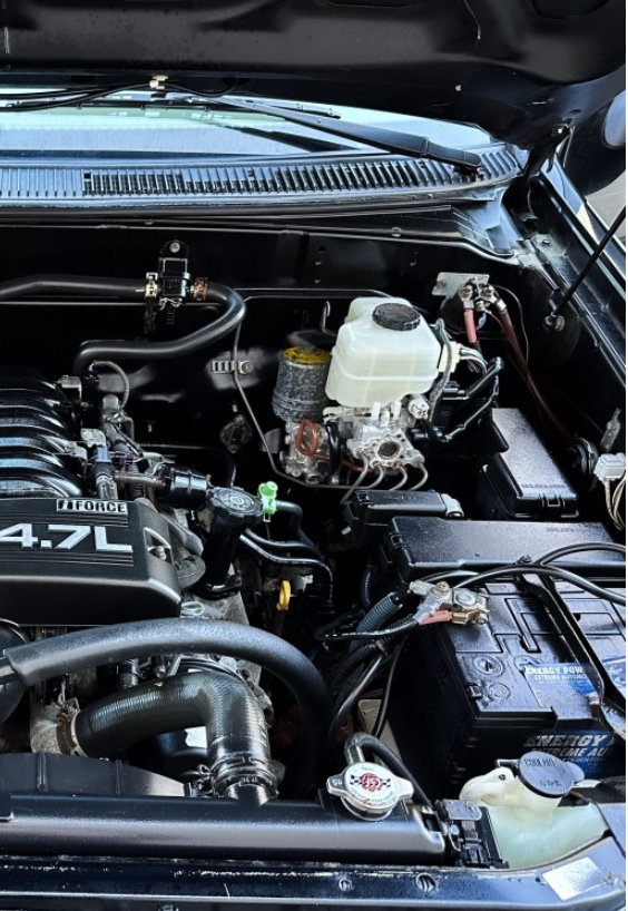

    Quick question not trying to hijack this thread. I’m looking at an 05 DC 4WD with the Auto LSD, (picture shown). What makes them a not so good option? I’m not too familiar with the system on the first gen’s. I know it can be an expensive fix but Is the system known to have issues?

    It’s that unicorn of a master cylinder. Yours looks in good shape and the fluid looks new. When they go bad it’s around $1K for the part if you can even find it.

    My 2006 Double Cab does not have VSC, so it wasn't a standard thing for 2006.

    I just replaced the one on my Land Cruiser...$1,800 list/$1,300 at Ourisman. They can be rebuilt, but I opted for all new.
