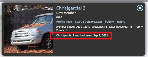

    That member hasn't been back since 2021, I see by clicking on his username. Like so many, posted a few times then bailed on the forum/account.

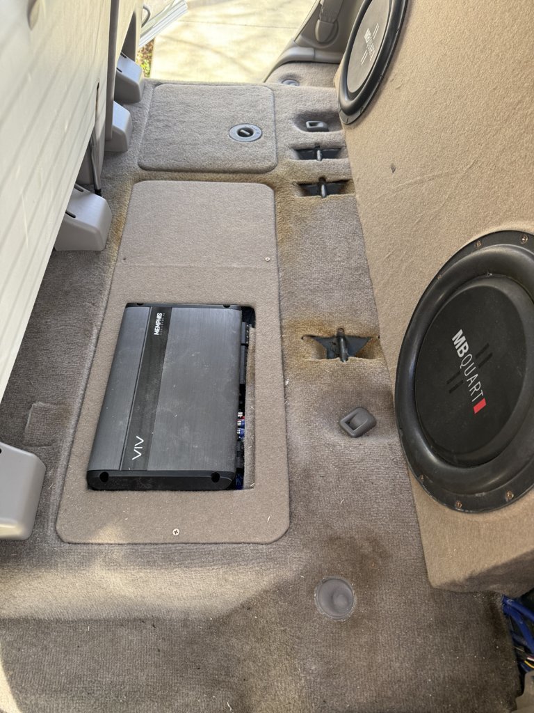

    Subwoofer enclosure, Apple CarPlay, 9” screen, headache rack

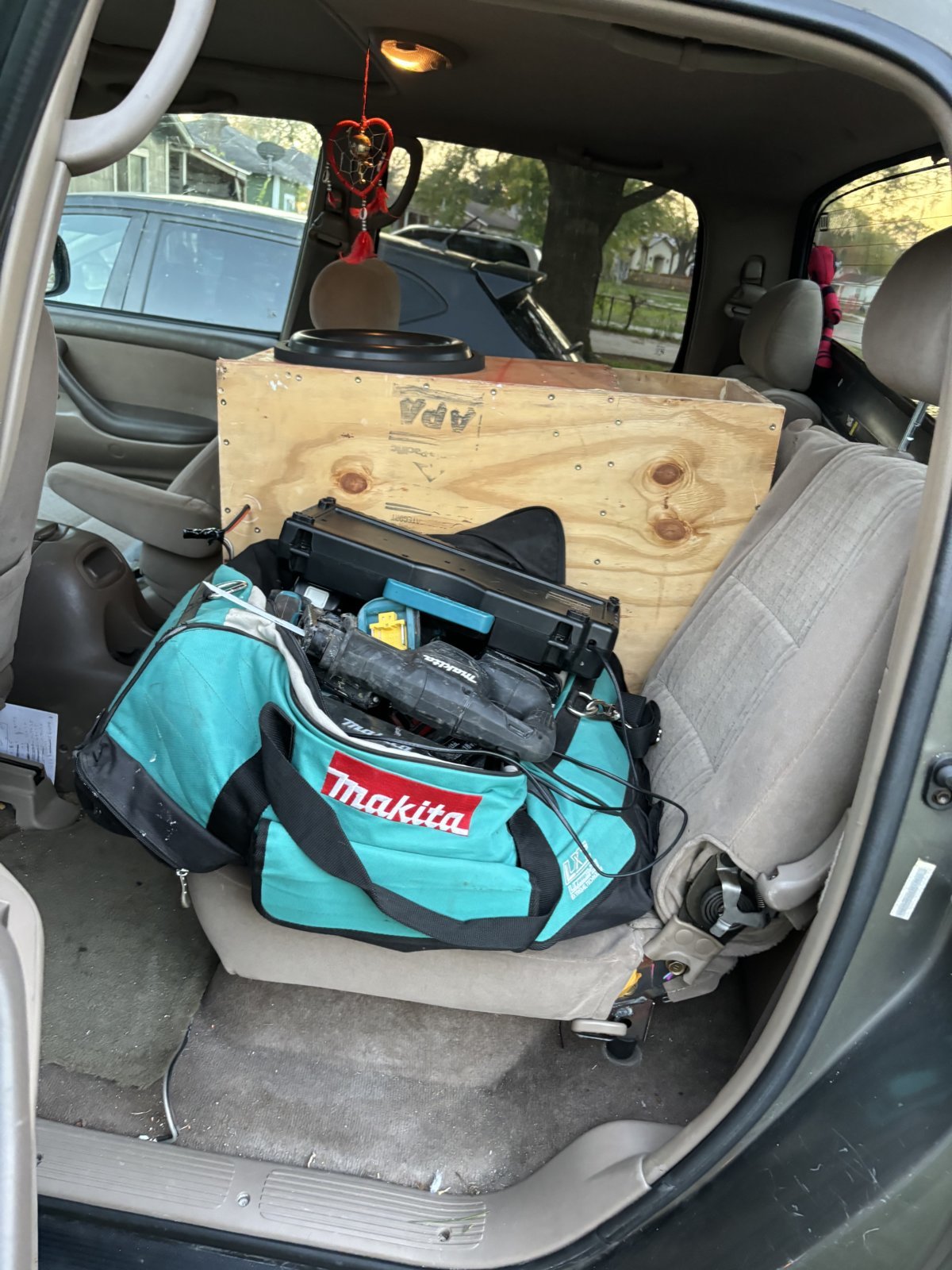

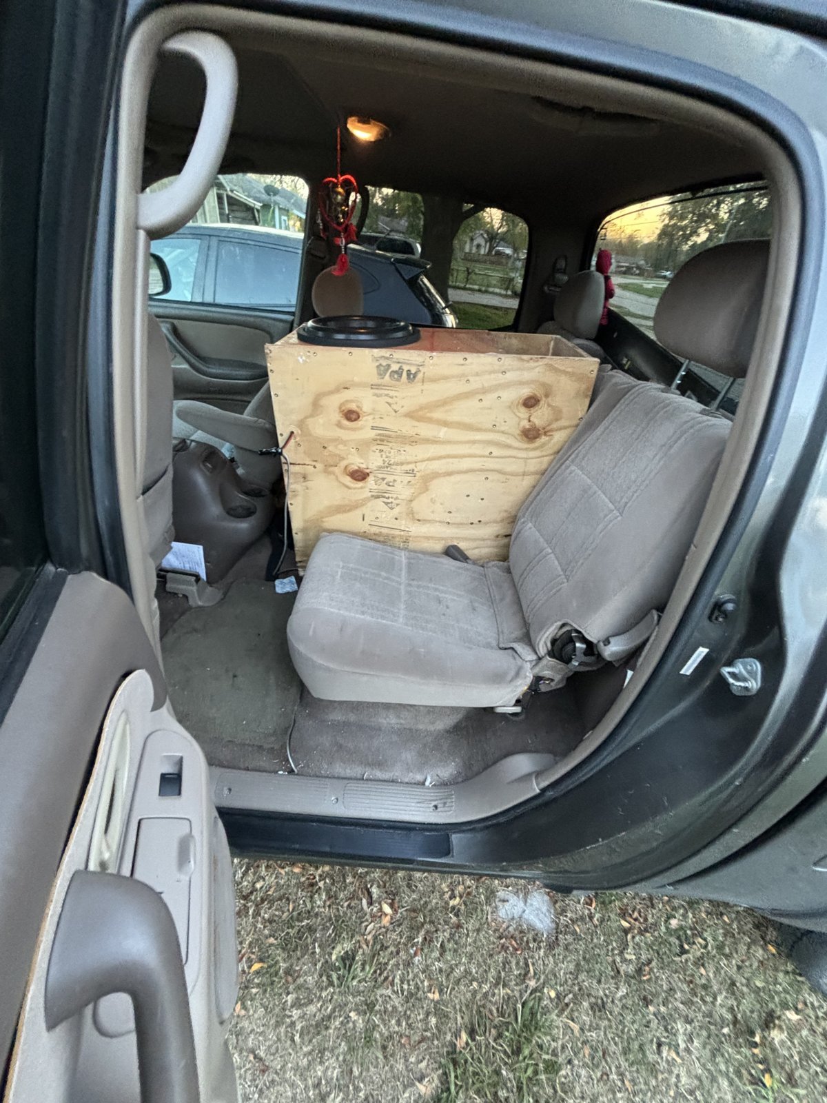

    I chopped up my back seat to make a bucket and stuffed a huge box in there. I can’t figure out how to upload more than one picture though but I can do a full write up later if there is interest.
    The Black Mamba likes this.

    Looks like a real comfy spot to hang out.

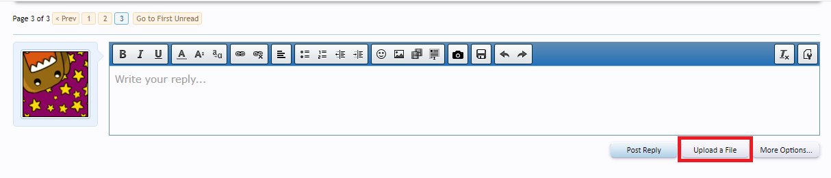

    Looks good! With your cell phone, copy the photo from your picture app and paste it in your post. You’ll need to give the server a second to catch up. Once you see a thumbnail of your photo at the bottom, you know that your photo is now embedded into your post.
    shifty` likes this.
  14. Dec 30, 2023 at 2:17 PM
    #74
    shifty`
    Jun 20, 2020
    #48239
    29,451
    ATL
    '06 AC Limited V8/4WD
    I mean, if that's too difficult and you're masochistic, you can just click the "upload file" button repeatedly, and upload pics one by one.
    But it's way easier on your PC to just select all the pics you want to upload and drag/drop them into the "Write your reply..." box.

    3” lift, 33” tires, Memphis VIV 6channel amp, two 12” subs
    Added two 12’s to my son’s 2005 Tundra double cab. They are shallow mount subs at 3” deep. Running a 6 channel Memphis VIV 750.6. Not quite enough air space but only short by about 0.18 cuft. I added some poly fill and it sounds really good

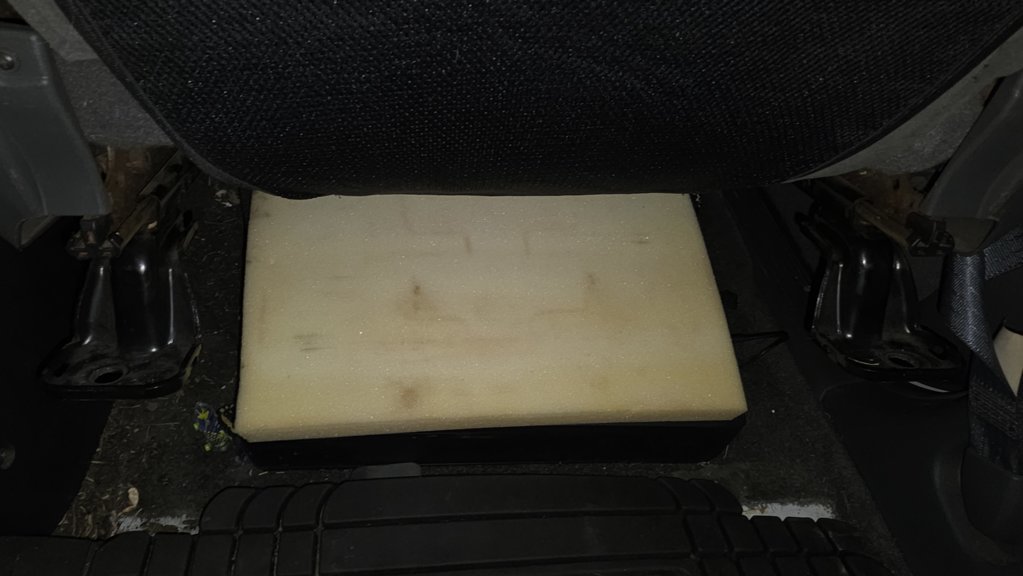

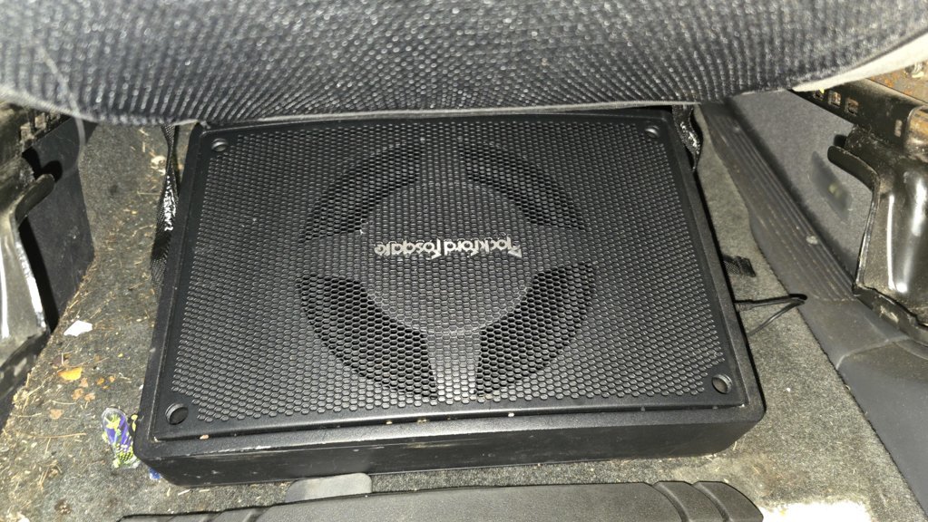

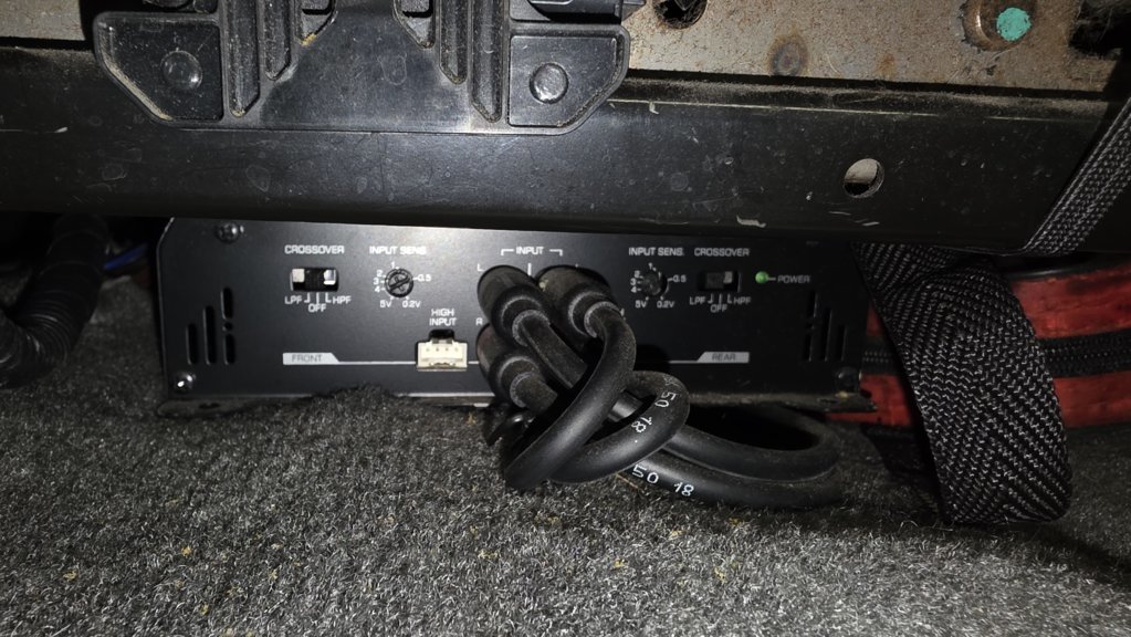

    Did the whole Rockford 300w self powered 8" under the passenger seat. Had the seat out yesterday to put on cleaned seat covers but didn't think to take a picture.
    Have a 900w amp for Kicker door speakers under driver's seat. Hind sight being what it is I should have put the sub under the driver's side since that seat is height adjustable.
    The 8" powered box just fits under the passenger side seat. Put some foam inserts around the sub to keep from vibrating on the seat frame.

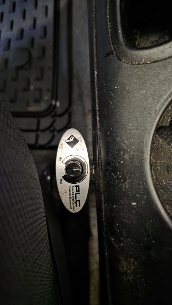

    Makes enough bass for me to be happy. Only listen to metal and wanted something punchy and responsive to the double bass kick. Adjustable bass knob mounted near driver's seat is nice too.
    Link to sub:
    https://www.crutchfield.com/S-bNIyApeOv6P/p_575PS8/Rockford-Fosgate-PS-8.html
    Example of said double bass goodness:
    https://youtu.be/VW442x1MyGw?feature=shared
    Edit: 30 seconds with an impact to show you what I'm talking about.
    With foam between speaker and seat base
    Door speaker amp under driver's seat
