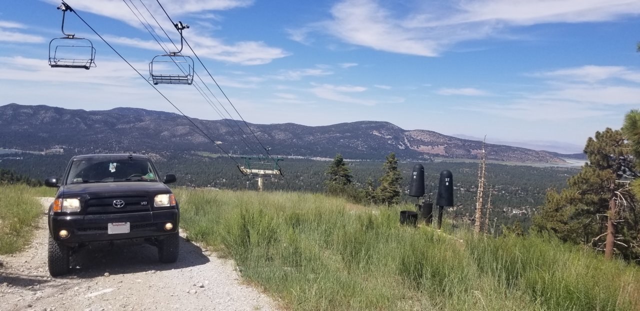

    I agree. I accidentally took my truck down a dry ski slope a while back and popped it in 2nd and 4lo. Carefully tapping the brakes and listening to the truck do it's work got me to the bottom safely without the truck running away.

    This was on Bear Mountain, someone shut the gate on the trail I took in. I forget the name of the slope I went down but the grade and fact I couldn't see the whole trail from the top was enough to make me pucker.
