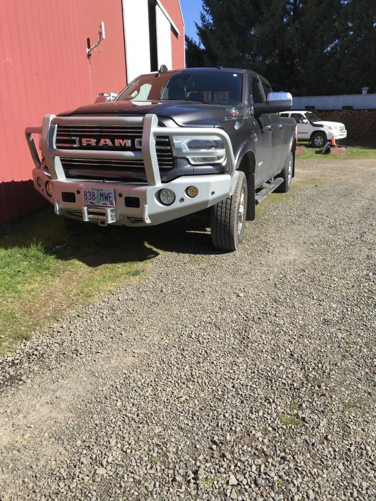

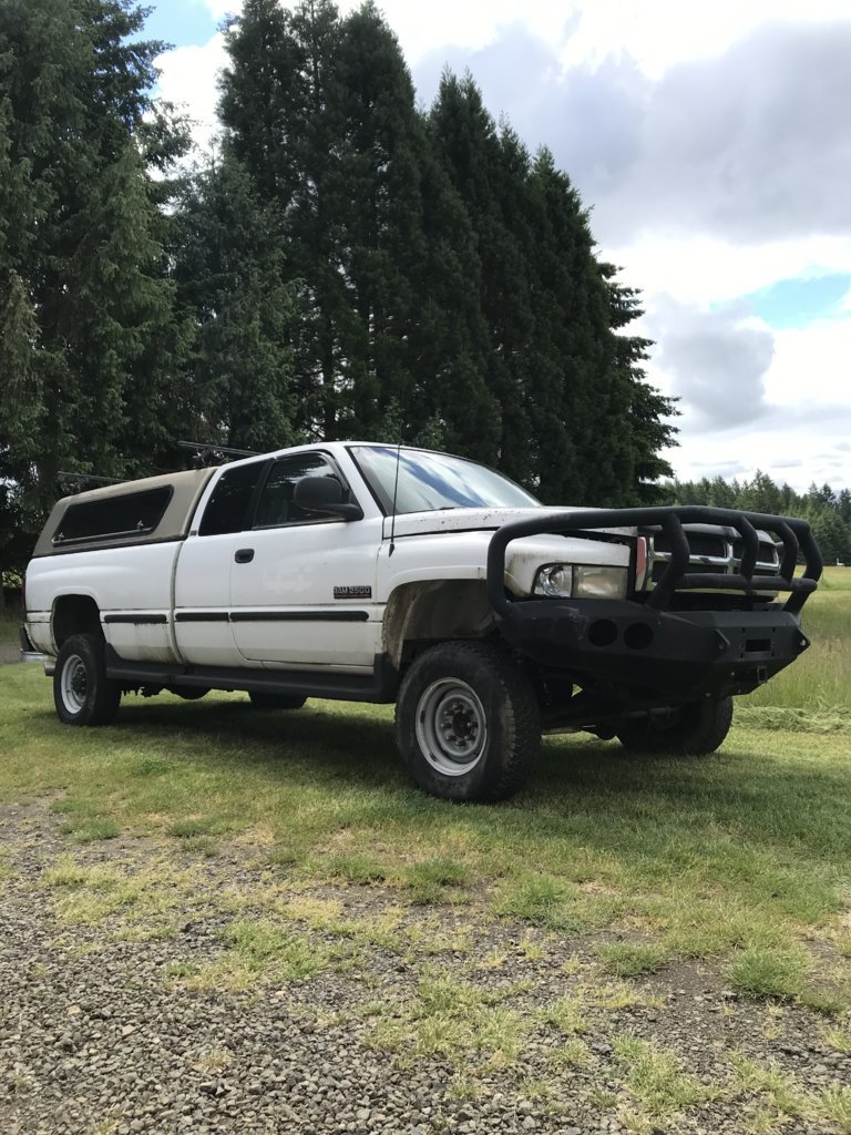

    I usually have to anchor my brakes 3 times a week for deer where i live in NW oregon. I’m still on the lookout for a Tacoma ARB bumper to mount on my Tundra.
    This is the Trail Ready bumper on my sister’s Cummins.

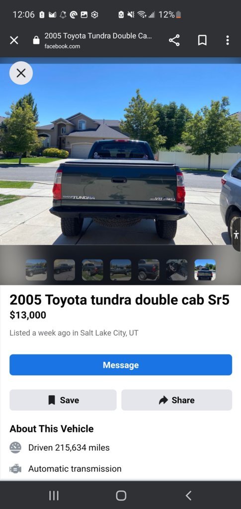

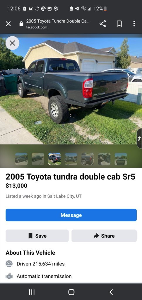

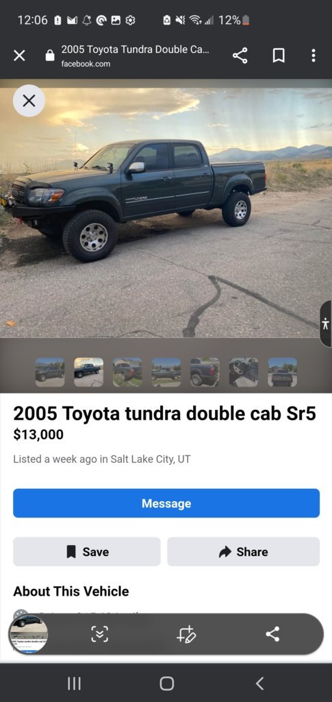

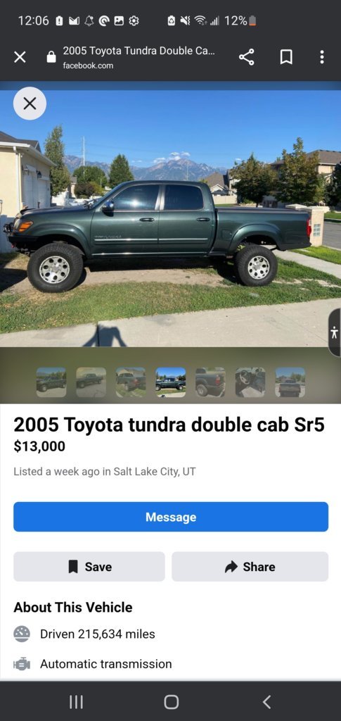

    Not my truck but I screenshotted this listing near me a while ago.

    I like the looks of the high clearance rear bumper, but my truck would need some sort of mid-clearance bumper that still had plenty of room to be used as a step bumper. Plus i would absolutely still need the full weight rating of a rear receiver hitch.

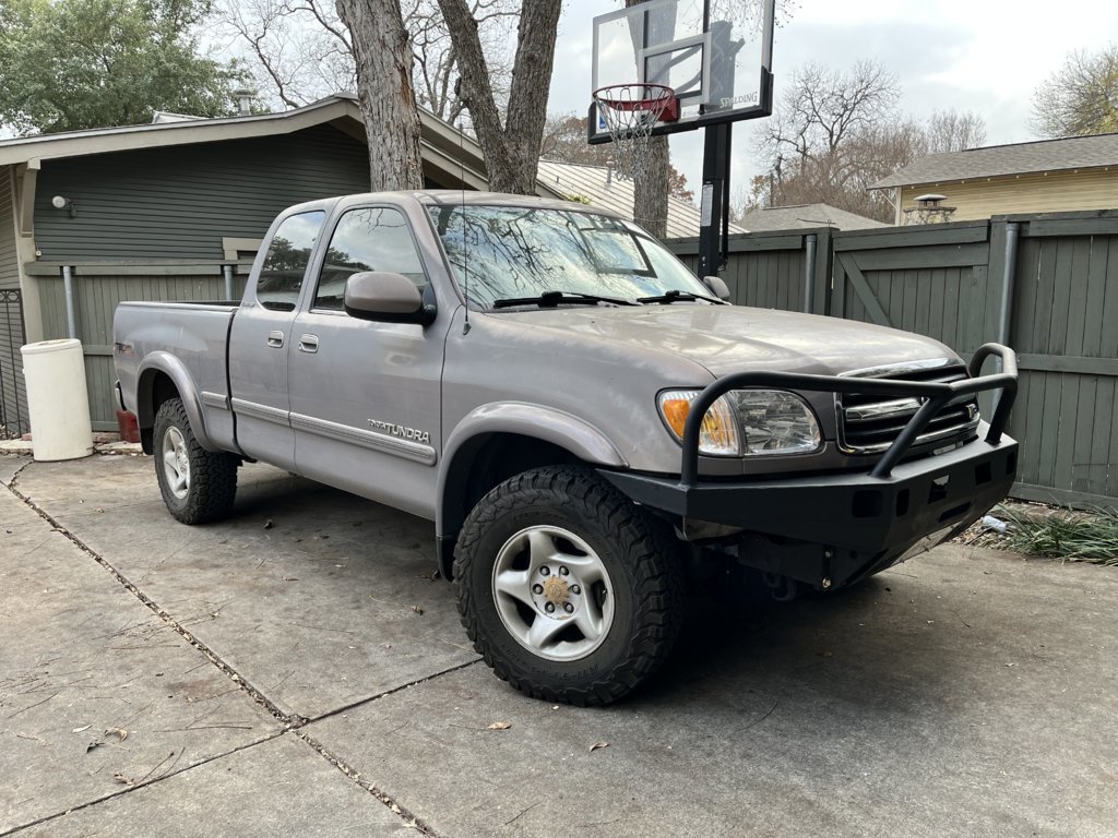

    I put a full-tubing, high-clearance Coastal Offroad front bumper on my 2001 Tundra. Have been very happy with it. I never welded before, so I bought a welder and used this project to learn. I was able to weld it up without any major problems. I used the MIG gun with 0.030 flux core wire (no gas) and it was mostly perfect for this job.
    The instructions are pretty good, but were for a later-gen Sequoia so some stuff was different (only some of which they acknowledged in the instructions). I wish they’d give you the option of printing your own color set because the photos in the instructions lose some detail in the black and white renderings. I also had to tweak a couple of things on mine to get it to fit, but it was fine overall.
    Edit: you’ll need a child with skinny arms to install the license plate UNLESS you install the bolts from behind before welding that main bent plate (number 6) into place.

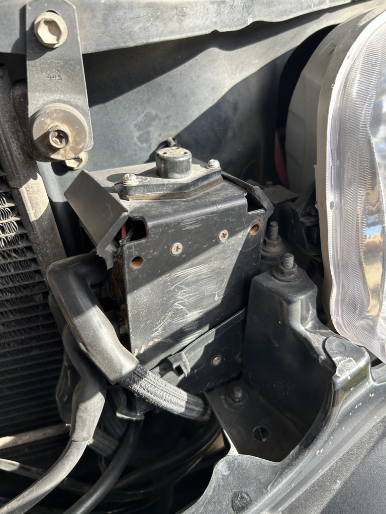

    Mine is mounted in front next to the rad secured to the left headlamp support

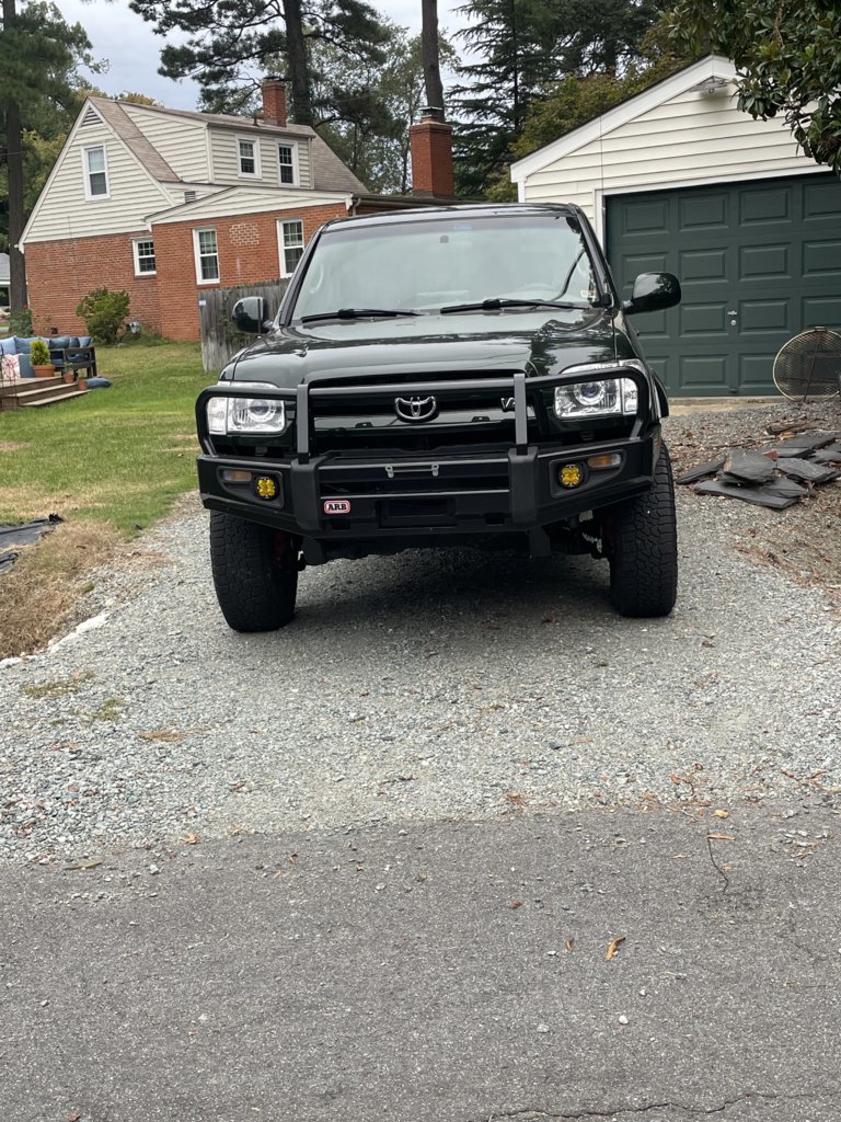

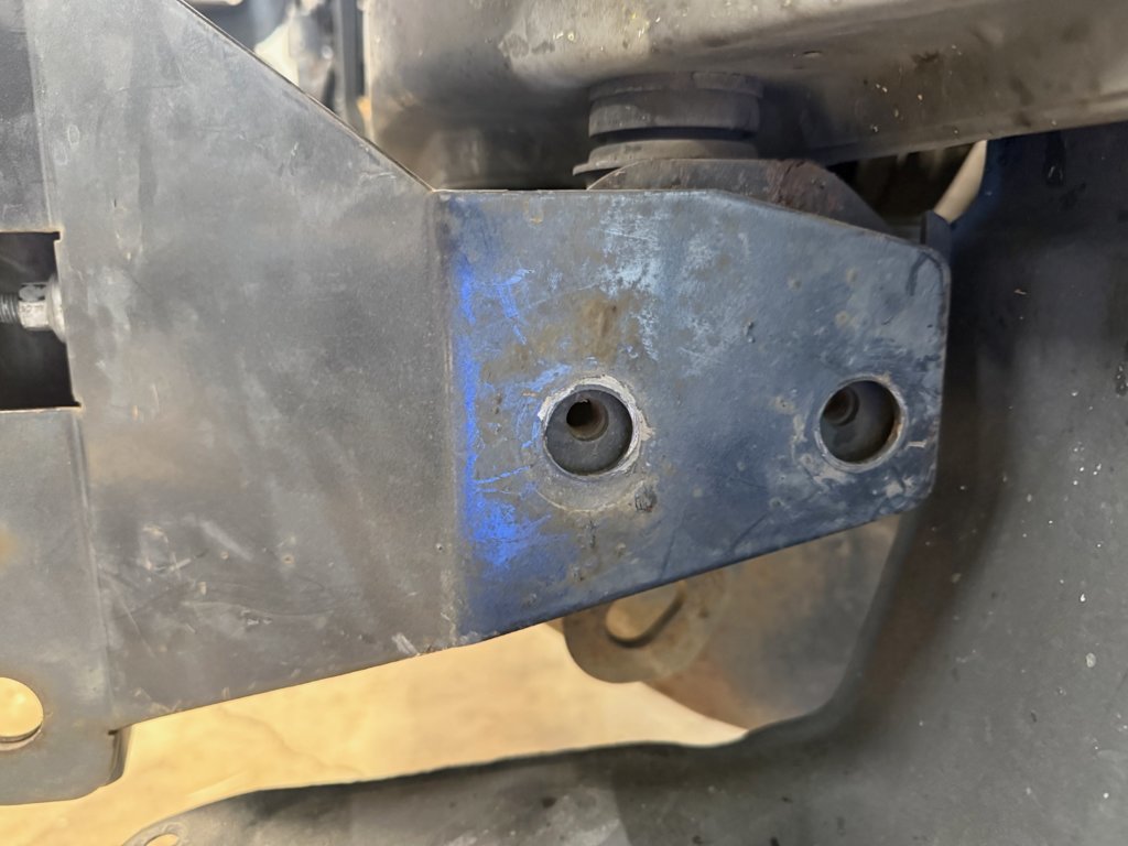

    Question, when installing my ARB bumper the instructions were suuuuuuper vague. Didn't mention anything at all about the hardware for the bumper mounts on the front of the frame that the plastic bumpers use, only showed the 2 bolts on either side of the frame that the metal bumpers mount up to. The ARB mounts have three holes that mount up to the front of the frame rails, and two holes on the side. Currently I just have the bolts on the front holding it on, I did manage to find the side bolts from Toyota and got them ordered. Do you think it would have been ok with just the factory bumper bolts holding it on or should it have all 5 to help handle the extra weight?
    These are the bolt holes on the sides.

    The more bolts the better. The front is kinda weak
