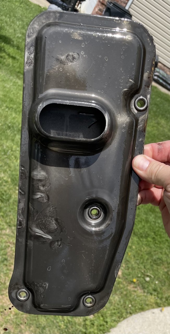

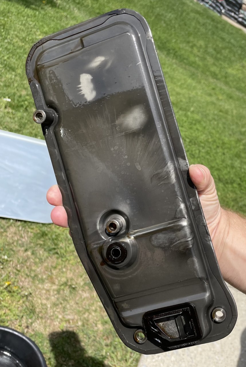

  19. Jun 12, 2022 at 9:42 AM
    #49
    Seethan
    Seethan [OP] Overwhelmed noob
    Apr 14, 2022
    #77183
    54
    Seth
    Middle TN
    2000 V6 Tundra SR5 AC 2WD
    This is the original filter
    And this is what I replaced it with (originally)
    For some reason finding a new oem one was difficult
    Jack McCarthy likes this.

  21. Jun 12, 2022 at 10:07 AM
    #51
    Seethan
    Apr 14, 2022
    #77183
    54
    Seth
    Middle TN
    This is the problem I was running into also. 35330-60030 is for V8s. One of the screw holes and the inlets are off.[​IMG]
    YardBird likes this.

  23. Jun 12, 2022 at 10:49 AM
    #53
    Seethan
    Apr 14, 2022
    #77183
    54
    Seth
    Middle TN
    The part number for the original is 35330-30010, and the number for the one I got (the smaller one) is 35330-30011. On the toyotapartsdeal website it says that 35330-30010 was replaced by 35330-30011. I just don't get why they're so different. The website also says it doesn't fit my truck for some reason. I ordered it anyway, so hopefully it is correct.
    KNABORES and YardBird like this.
