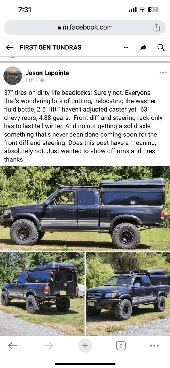

    Mud trucks need alot of lift, seems tundras just need alot of trimming. Pic for inspiration (not mine).

    Inspiration, aka "I hit a bump and my front tires ripped my fender flares right off" :rofl:

    Fender flares need to be ripped off. Adds character.

    Man, that is a cool looking truck. 37's on only a 2.5"?? So, you're saying there's a chance...just need to cut the entire fender well out.

    Front suspension lifts do not help you clear bigger tires on IFS at all. They simply do not. The only way they help you "clear tires" is at ride height on pavement. All IFS suspension lifts will do is change your static height at ride height. Sure, you can have a coil over maxed out to give you a huge hub-to-fender measurement where it looks like you fit a big tire no problem, but your suspension will still compress all the way and your tire will end up tubbed in the fender just like it would have on stock suspension, all in the same spots.
    Cranking coil overs might make it where you need more force to fully compress your shocks and stuff your wheels, but you also lose your downtravel and risk pulling apart your shocks.

    Oh for sure, my post was mostly in jest. It's cool to see a truck like that, but doing it properly requires quite a bit of modification.

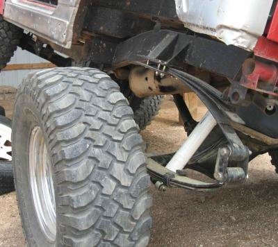

    I'd like to keep my height, but with longer, softer shocks and springs. Stock bumpstops, but be able to drop a wheel like a foot or so.
    Maybe get a little silly with the rear.

    I want that camper
