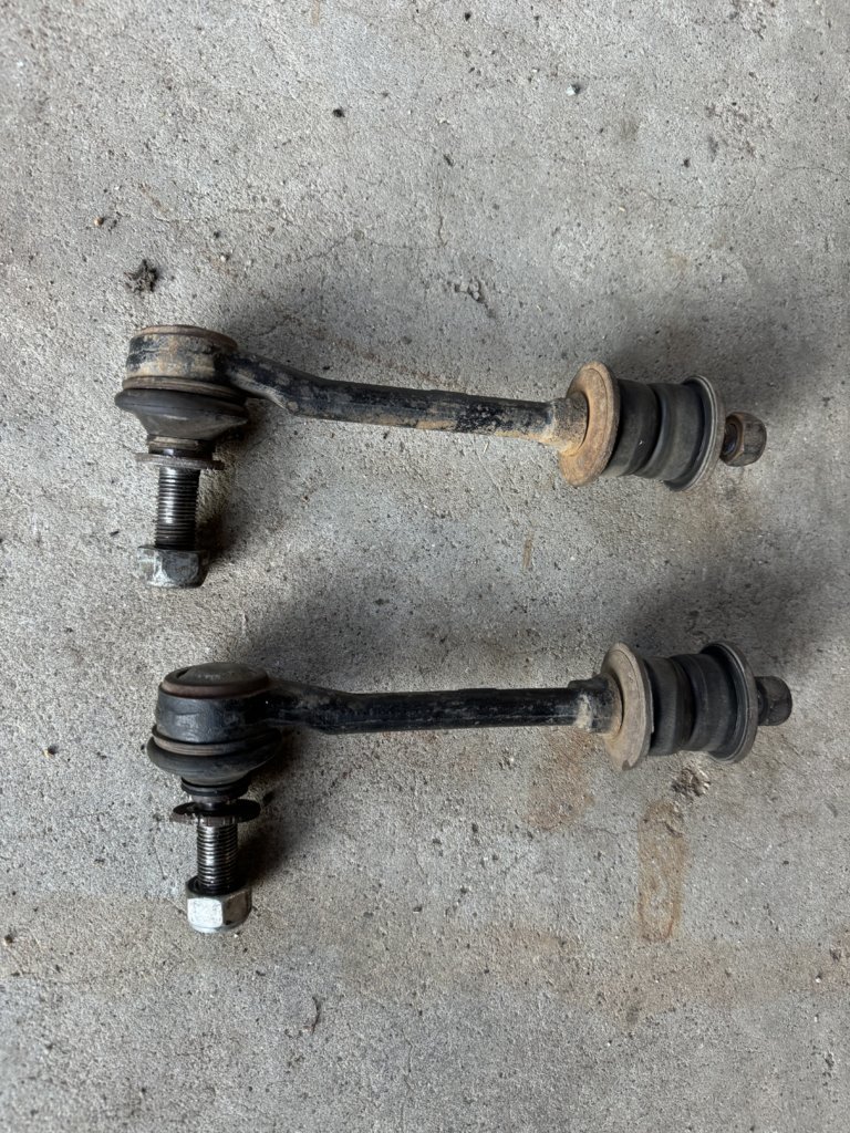

    I’m adding the Moog Sway Bar Links. I only swapped them because I assumed they were going to be trashed, and I had to pull them anyway to add a 1/4” top plate spacer.
    They have 115k on them and are 4 years old. I live on a rough poorly maintained bumpy road, they have bombed down washboard roads at 70mph, they have held up like new.
    The balljoint is still very tight and the bushing are in great shape. They have surface rust, but that’s about it.
    Not bad for $42 shipped. I replaced them with the new Moog links with the white bushings. We’ll see how those hold up.

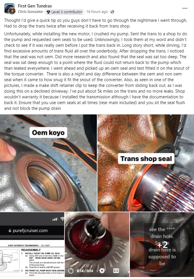

    Well, here's an OEM plus, aftermarket minus/fail to share from the lowercase FB group.

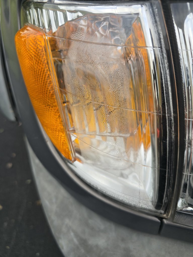

    I've had 2 sets of passenger side Depo CAPA certified corner lights get moisture in them now. First one purchased 5/18/23 and then replaced on 11/2/23 under warranty and now a year later here is the passenger side again with moisture in it.
    Not sure if any of the other options out there (other than OEM) are any better and I suppose I could pull the one apart and reseal if I have to.
    Gonna have to be OEM minus here. Maybe just a bad batch or something, headlights and driver side corner light has been fine so far.

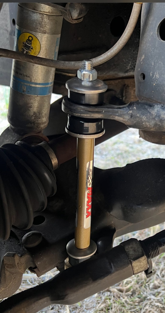

    Stock height: https://suspensionmaxx.com/product/smx-122260t
    Lifted trucks: https://suspensionmaxx.com/product/smx-122270t
    Use a poly-safe lube on the bushings during install.
    Do your best to keep the bottom cam parallel to the ground at install.
    You may need a (14mm? 17mm? I forget) thin wrench to install.
    Read the directions they provide for install so you know how to properly install.

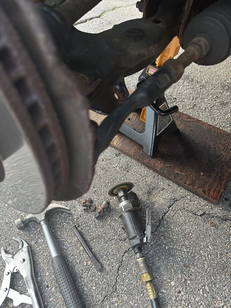

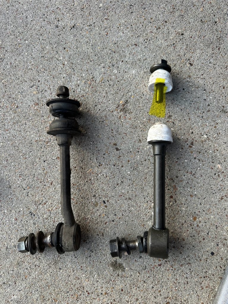

    Well f&$k, moog 2 piece for the loss. 14ft/lbs torque my ass.
    Didn’t want to spend extra monies for someone else to enjoy a few extra years out of ‘ol dirty red. Guess I’ll chalk this up again and listen y’all before buying….again. (I couldn’t wait for response before I bought, had a couple days off work ((shift worker)), figured easy 1 hour job)

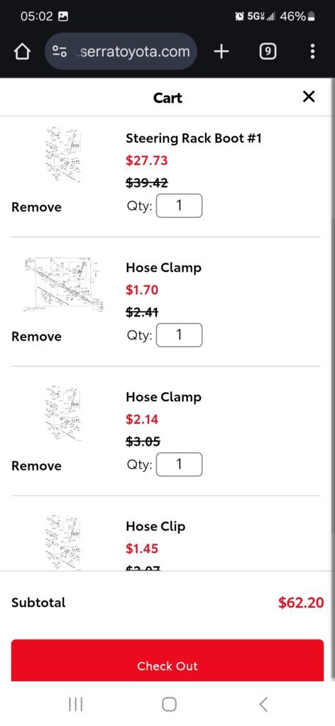

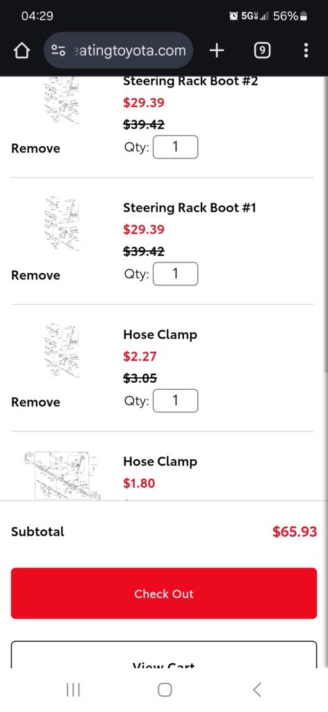

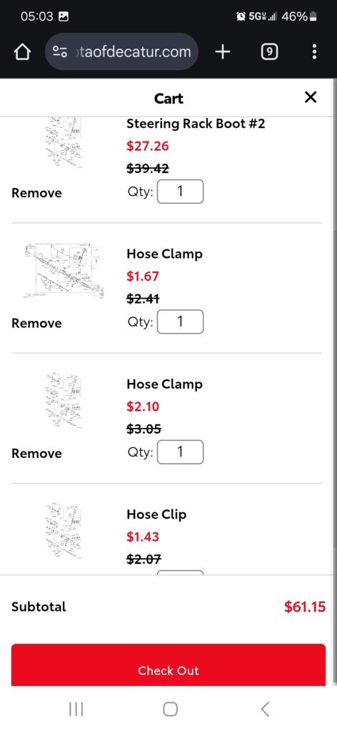

    At my local Toyota those 6 items come out to $66 before tax. How necessary are new clamps? NVM it's just an extra $7... Weird that the two sides aren't identical for the clamps and bellows part numbers and the clamps differ by 47¢ in price.
    Local
    Birmingham
    Decatur

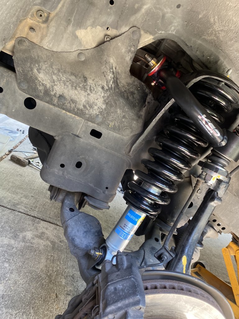

    it isn't THAT bad. If you get the VERY specific Toyota ball joint tool. But even then.....I hated doing my OEM UBJ.
    it's 2 months shy of a year installing my KSP UCA. It comes with an entirely different UBJ assembly. It didn't break the bank and is still holding upIMG_4471.jpg
    so take that for what it's worth
