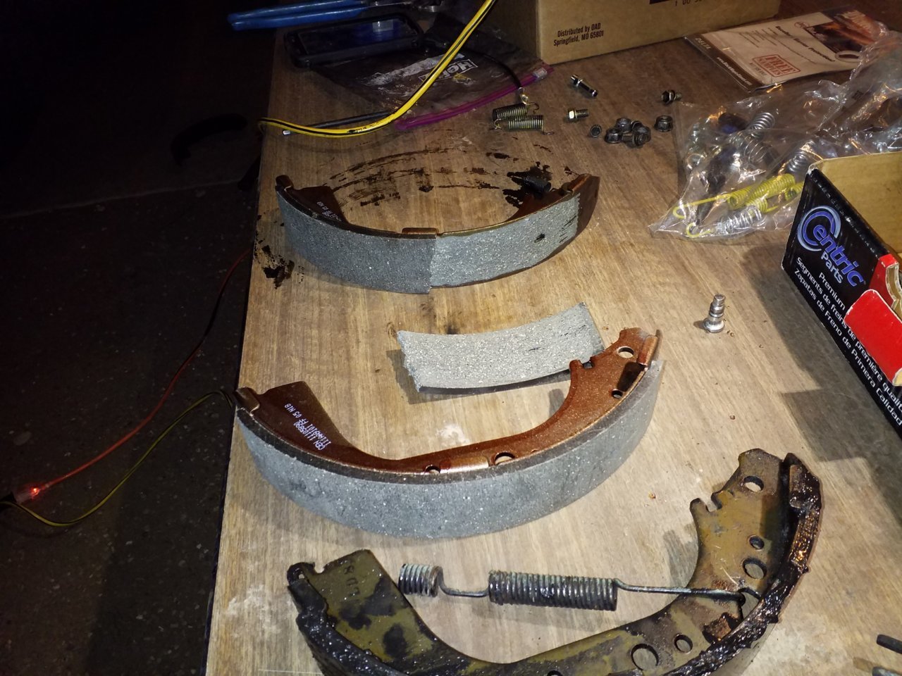

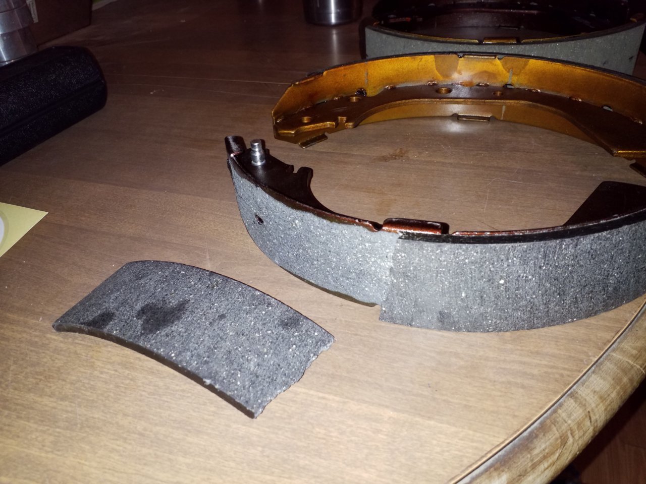

    Fail: centric rear brake kit. The shoes shattered and one was missing the cotter pin stud/shoe hanger thing.

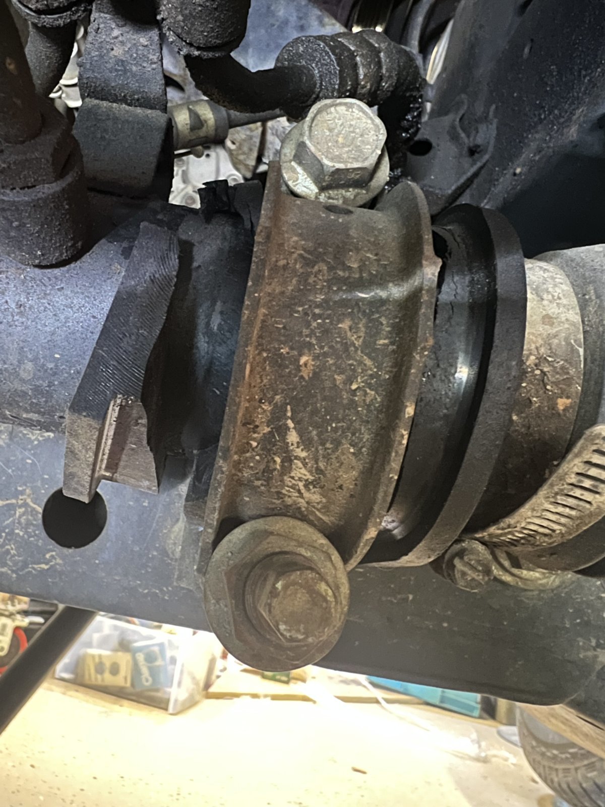

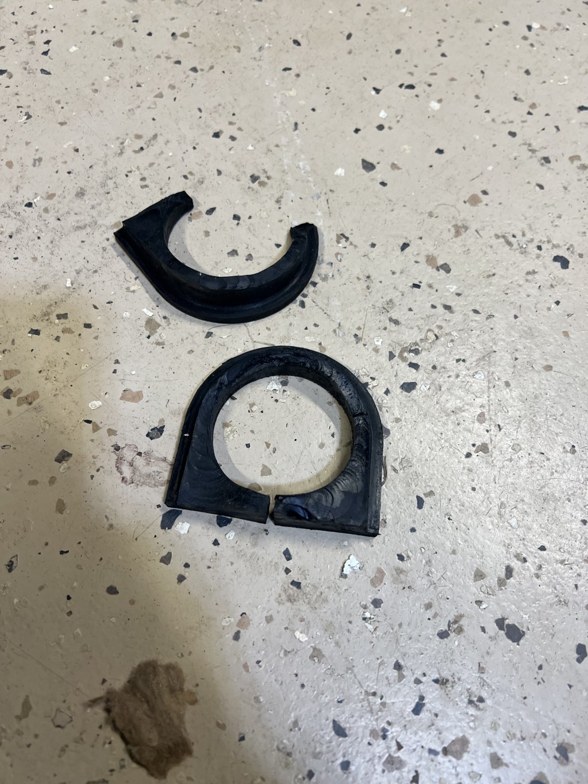

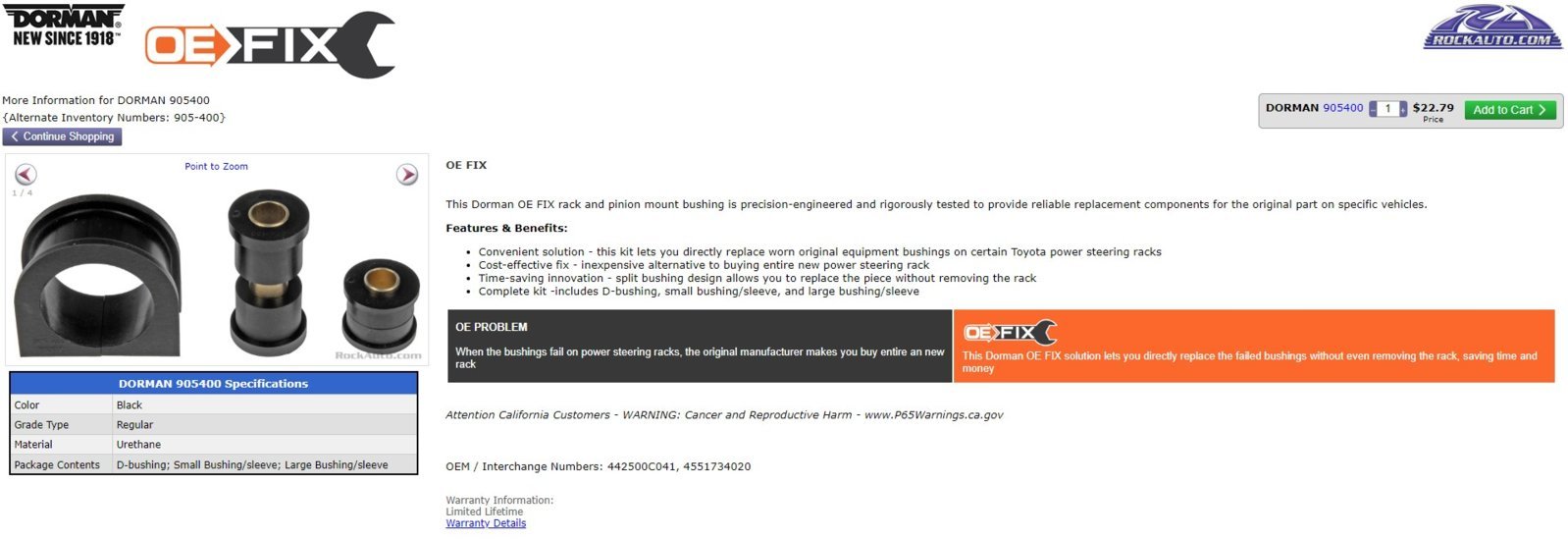

    Dorman Steering rack bushing kit. Failed spectacularly after 40k miles or so.

    Not surprising. Hopefully their replacement gas tanks are acceptable if my pinhole leak gets worse.

    Well that sucks...I just installed one!
    Edit: Wait...never mind. I installed the rubber parts.

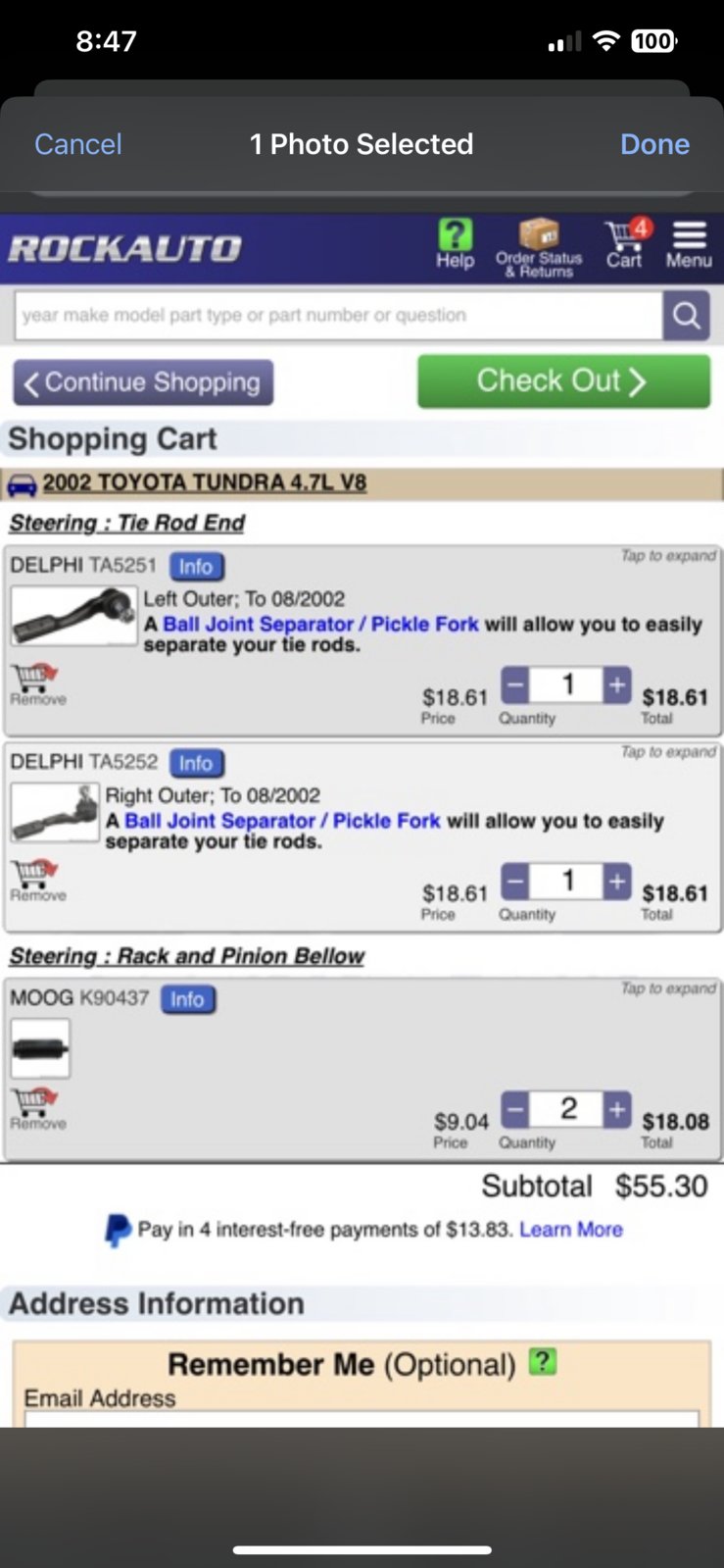

    Anyone else have good luck with Moog steering rack bellows? I'm hitting up Rock Auto for new Moog Inner tie rods and was planning to order new bellows too.

    Honestly, this is one of those where I intend to go OEM. It's only $25 for '00-'06 ('07 Sequoia), and the part number is 45536-0C010 for RH with large clamp p/n 90080-46271, and 45535-0C010 LH with large clamp p/n 90080-46272 (smaller clip-clamps are identical/reusable but p/n 90080-46270).
    Knowing they're that cheap, why would you consider Moog or any other non-OEM brand?

    I have a pair of these in my Rock Auto cart. I think there was a post on on the forum from someone that had 2 years on some with no complaints, but of course I cant find it now.
    As long as the rubber quality doesn't suck they should last a while.
    Edit: @shifty` search fu is better than mine, per usual.
    My argument against oem on this would be the basic function of the part. As long as they seal the steering rack and stop dust intrusion they are doing their job.
    Im much more likely to tear one on some road debris or whipping some skids than I am to see the useful lifetime of the part.

    I posted a pic of my rock auto cart & i think someone (?maybe knabores?) mentioned the moogs split after a couple months, so i changed to beck-arnley. If i get home by this weekend i plan to start changing front end parts.
    Indeed was the moogs i was warned of.

    I know. I quoted him and asked if anyone else had the same positive feedback.
    Because by the time I add shipping for a small order like that, they aren't that cheap. Moogs are $9/side and I'm already placing an order from RA.
    Just curious if others had good results with them or not.
