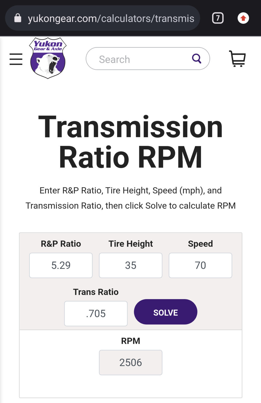

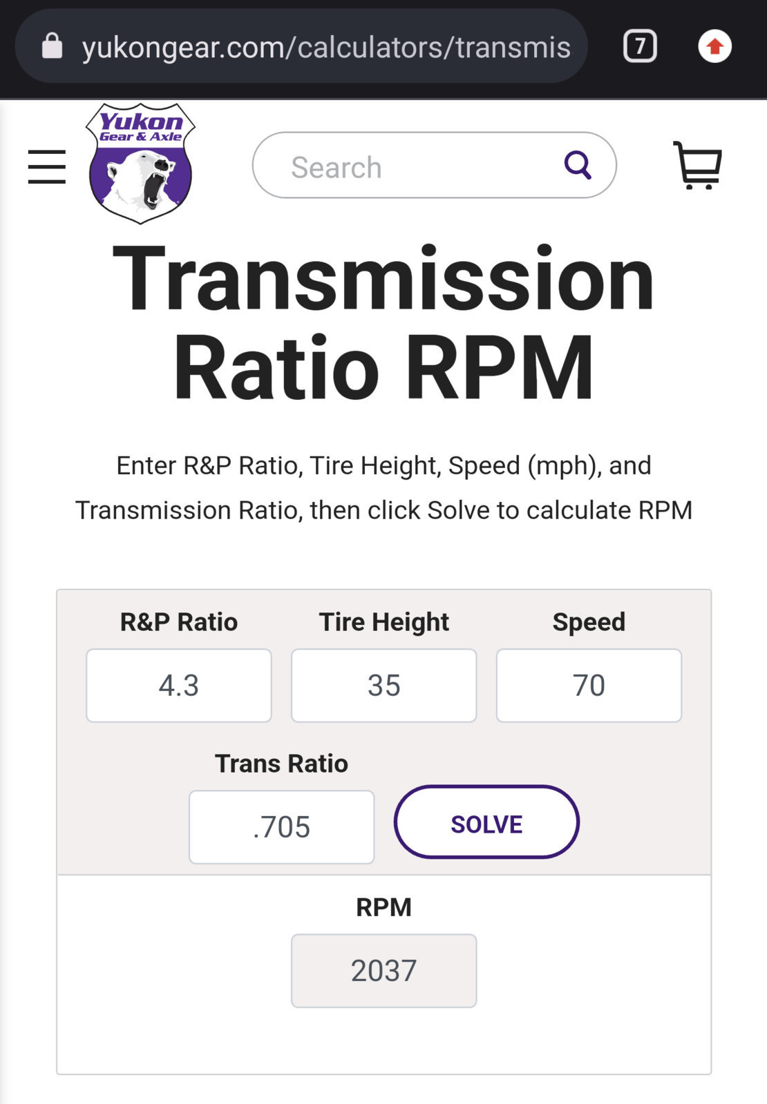

    GPS is the best bet for an accurate mph. Obd2 reader for true rpm. Measure tire height using a piece of 2x4 across top of the tire for actual diameter.
    Yes, they made lots of gear options for the 8/8.4". You can mix and match parts and make things work sometimes.
    Note: If it truly is a t100 rear diff you may need an adapter flange if you have new 3rd members to swap yourself. You'll have to check flange bolt pattern and spline size.
    Yes, the .705 is the o/d ratio for the 00-04 a430 4 speed trans. The 05-06 have a .716 ratio iirc.

    Have you tried this yet? It'll get you close to seeing what size gears you have. I was thinking 70 @2800 sounds a bit high, but with 35s you were probably closer to 80. Like @assassin10000 said, GPS will give you a better idea of your speed. A diff lock wouldn't be a bad idea, but only if you do moderate offroading, but the lunchbox locker for $600 is kinda iffy. Lastly, don't straight pipe your truck. It will sound like dog shit, be way too loud, and everyone around you, including your neighbors, will fucking hate you. Pretty sure Jesus would hate you too.
