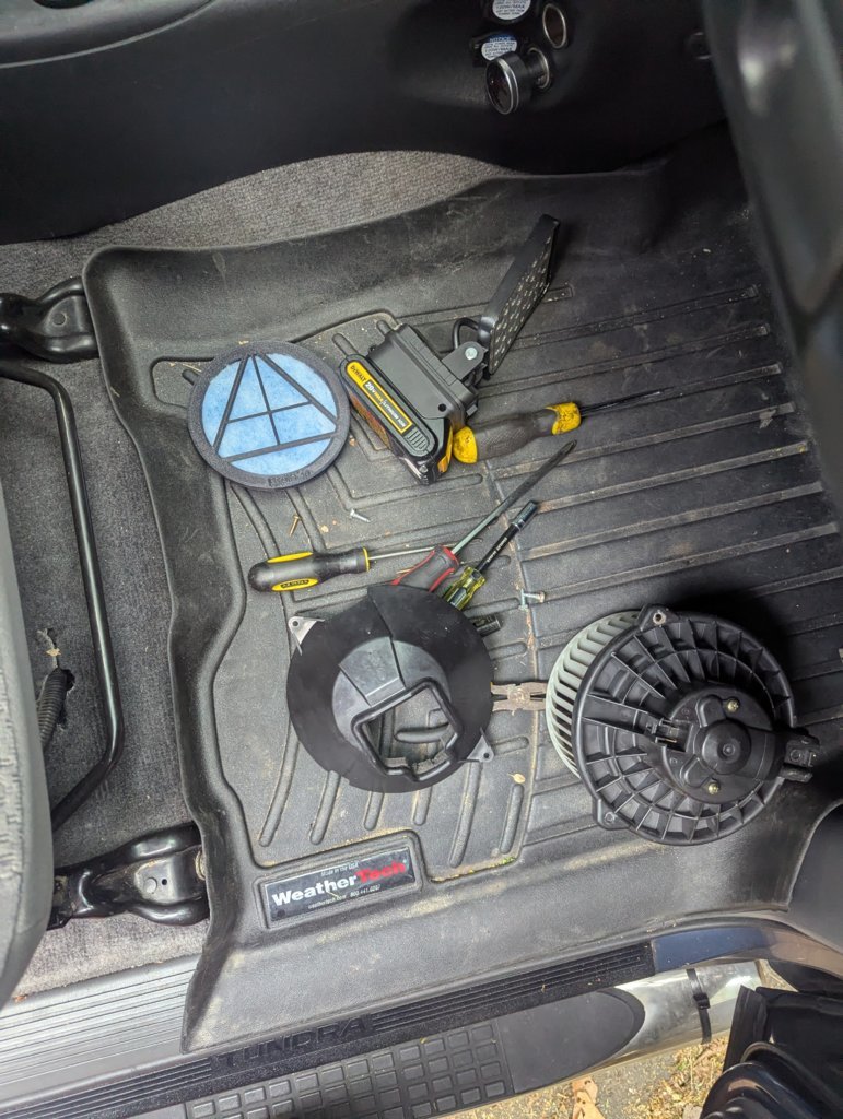

    I received the filter Thursday and I am getting on this right now. Will update. Thanks!

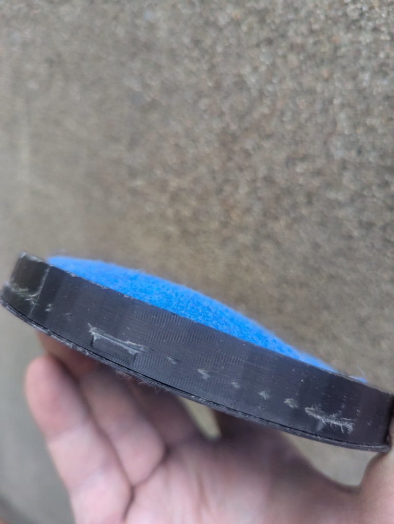

    It takes a bit of force to push it in and make it flush. Go around the lip with you fingers and make sure there's no gap Even the tiniest gap will make it rub the fan. Also Even if you hear it clip on the first push. Push around the entire perimeter until no more clipping sounds.

    I just sent a DM. I will give it another go tomorrow. No rush. It's probably just my own issue trying to get it to seat properly. Don't feel like you have to rush out.

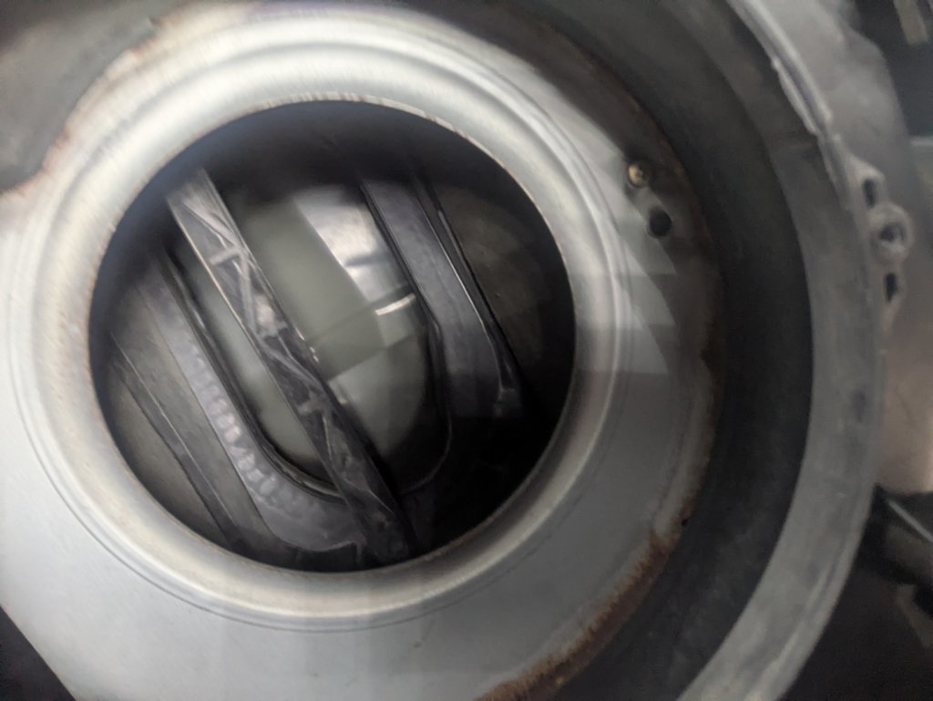

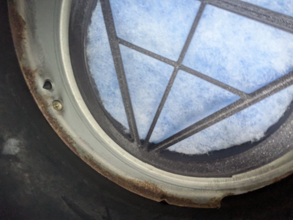

    I just reinstalled the cabin air filter and made certain that the printed holder "snapped" into the opening above the blower. When I tested the fan on my climate control, the blower is functioning well and the blades are obviously clearing the printed filter holder. Yesterday when I attempted to install, I didn't get the solid snap that I got today. It requires more force than I initially used, not an extreme amount but more than I initially thought was necessary. Thank you!
