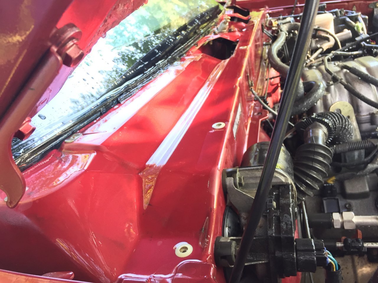

    Honestly, it may be easier to drop the blower motor than to get under the cowl. Getting in the cowl is sort of a PITA and you're destined to snap fasteners off. I'm not the only guy on here that had to replace multiple fasteners when fixing the cowl leak.

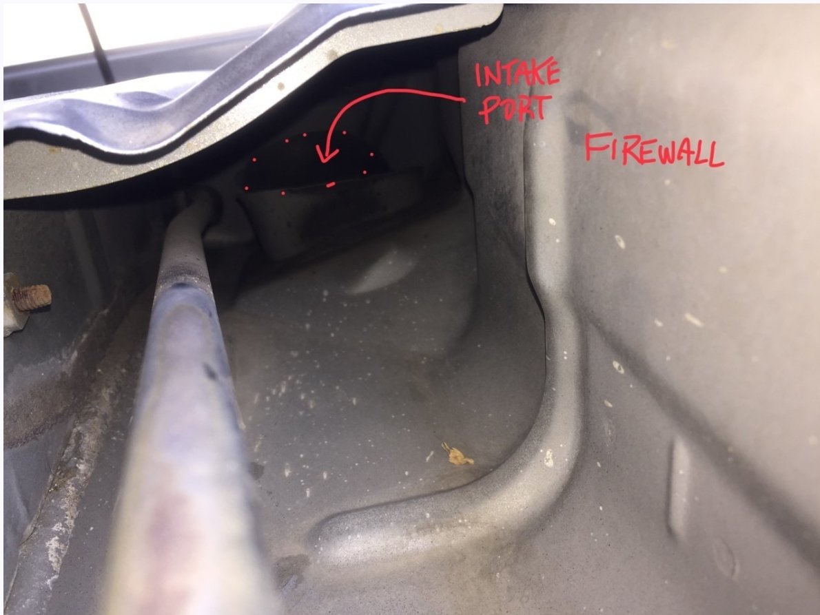

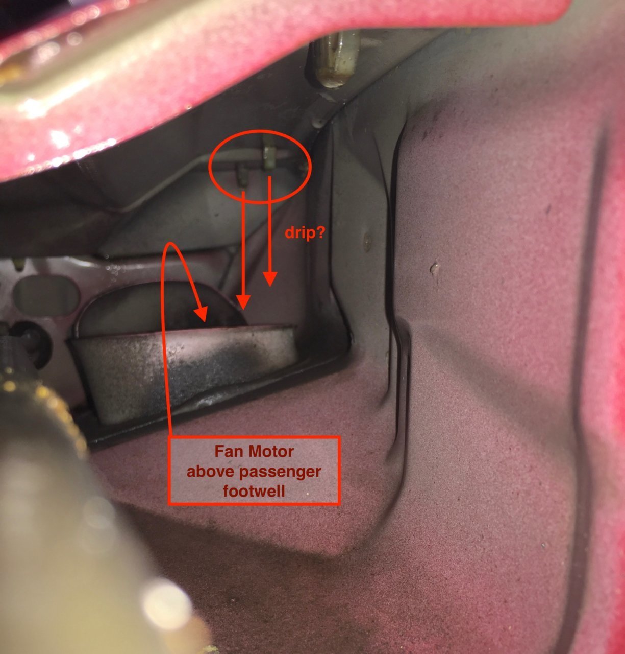

    That's something I was considering, but after taking a look inside the cowl there's the wiper motor arm to worry about. I suppose I could make a two-piece thing to go around it, or just have a small slot, but I think it would get wet and subsequently musty as shifty pointed out. Best option appears to be inside the blower motor area, probably, but again there's only less-worst options and lots of problems with each.
    Edit: image credit to a now-deleted account, "professional hand model"

    Yeah, the cowl would be last place I'd pick due to location of input air trough and access.
