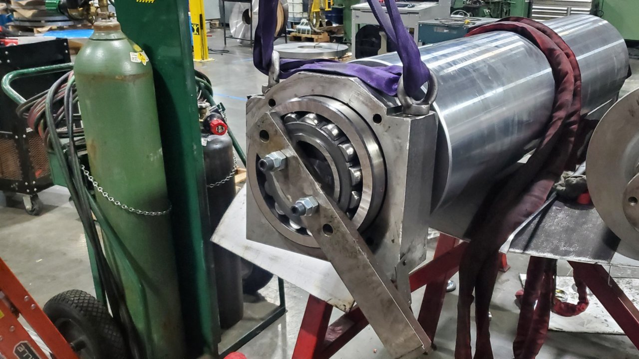

    Oh boy! Somebody didn't heat this bearing enough so it got cold before it was slid all the way on.
    So we get to take turn tightening the pusher bolts, and then beating the hell out of it. Too far on to take off, and reheat.
