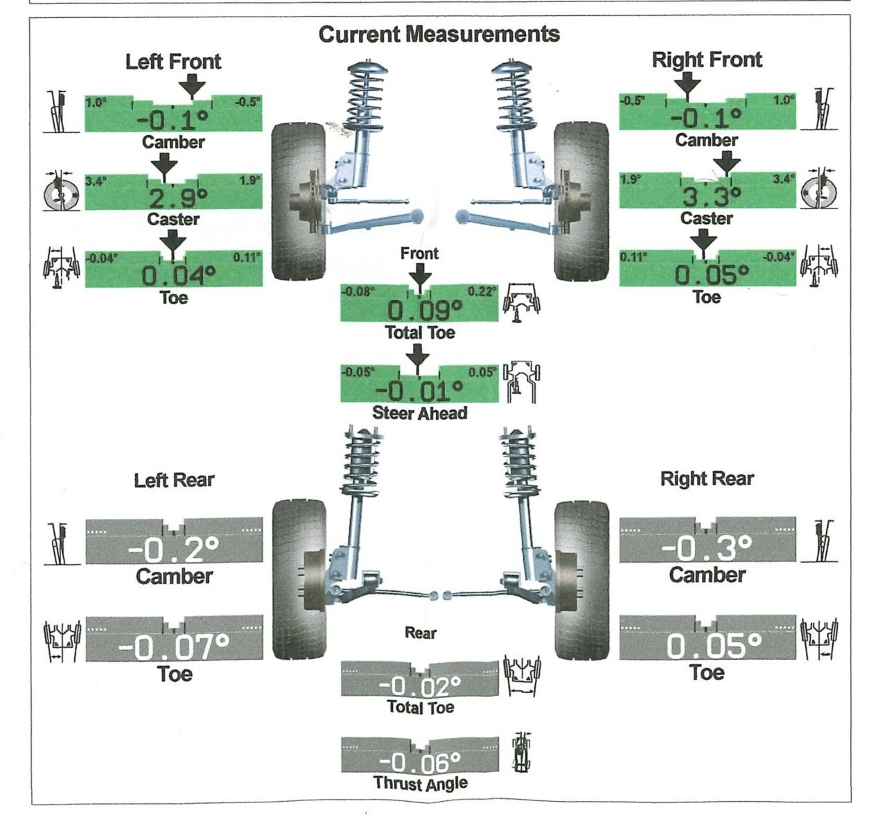

    Since we are on the subject of alignments, I've been fighting the handling on my Sequoia ever since I got it. I've replaced All UBJ, LBJ, UCA and LCA (ball joints are OEM, control arms are moog), front and rear shocks (eibach front on 2nd clip, Dobinson stock height shocks and coils), rear springs , drivers side inner and outer tie rod, passenger rear control arm and steering rack bushings.
    I think my cross caster is a little too high and the toe in the rear is off (not adjustable, but maybe means I need to replace the other control arm).
    The symptoms are it tends to wander a bit at freeway speed and has some bump steer. The big thing is on longer road trips it kicks down a gear it will pull to one side or the other.
    Any ideas of what to check next?

    The cross caster won’t help how it drives.

    Thanks! Do you mean the cross caster makes it worse or even if I fix the cross caster I'll still have my issues?

    Cross caster can cause all kinds of odd driving habbits
    The rear toe is nothing to worry about. They’re never perfectly 0.
