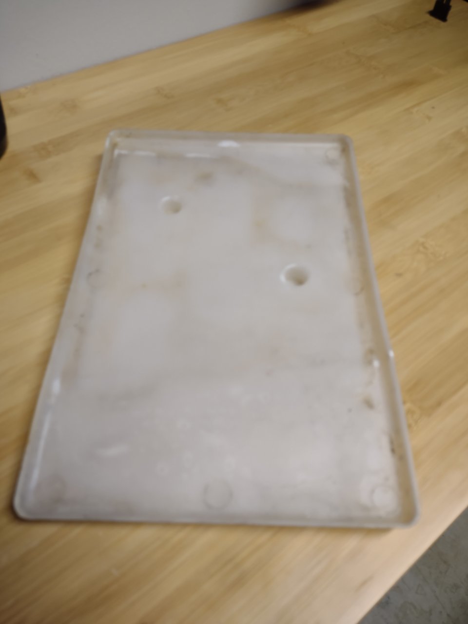

    Anyone want my old battery tray? It's for the smaller size. Pay for shipping and envelope.

    Whatcha end up replacing it with?

    An OEM tray for the larger 27F.

    Ah, I see. My OEM tray has a crack in it, but your smaller one won't fit my battery. Eventually I'd like to look into a full-on cage that's mounted.
