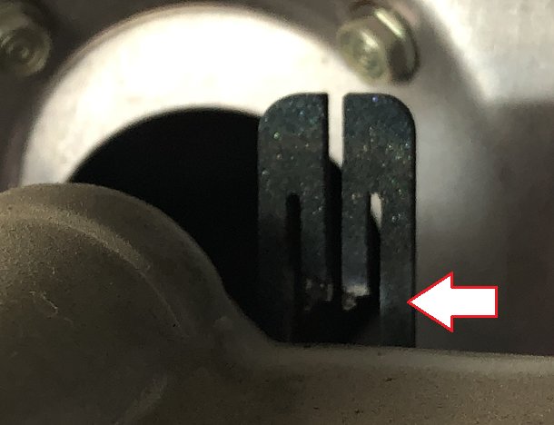

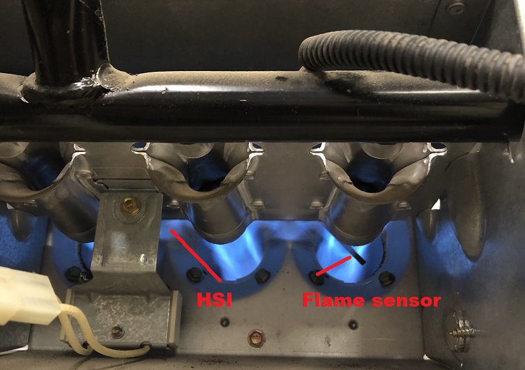

    I'm having the same intermittent error (33) or (34) on my upstairs unit - the ignitor isn't firing up. But on that one, if I cut its main power off, leave off for 30sec, then turn power back on, like 90% of the time, it fires right up. But visual inspection of the HSI in that case, it looks alright. So I'd planned to swap out the limiters based on the error. FTR, here are Payne's definition of those codes, I swear it's 34 but maybe it was 33, I can't remember:
    CODE: 33.
    RESULT: LIMIT CIRCUIT FAULT - Indicates a limit, or flame rollout is open. Blower will run for 4 minutes or until open switch remakes whichever is longer. If open longer than 3 minutes, code changes to lockout #13. If open less than 3 minutes status code #33 continues to flash until blower shuts of Flame rollout switch requires manual reset. Check for: - Restricted vent - Proper vent sizing - Loose blower wheel - Excessive wind - Dirty filter or restricted duct system. - Defective blower motor or capacitor. - Defective switch or connections. - Inadequate combustion air supply (Flame Roll-out Switch open).
    CODE: 34.
    RESULT: IGNITION PROVING FAILURE - Control will try three more times before lockout #14 occurs. If flame signal lost during blower on-delay period, blower will come on for the selected blower off-delay. Check for: - Control ground continuity - Flame sensor must not be grounded - Oxide buildup on flame sensor (clean with fine steel wool) - Proper flame sense microamps (.5 microamps D.C. min., 4.0 - 6.0 nominal). - Gas valve defective or gas valve turned off - Manual valve shut-off - Defective Hot Surface Ignitor - Low inlet gas pressure - Inadequate flame carryover or rough ignition - Green/Yellow wire MUST be connected to furnace sheet metal.

    So that one is probably the flame sensing rod, it’s just a ceramic coated rod with a bend on it and a terminal that faces you as it’s in the unit, I think a screw usually holds it in place, but pull it and use sand paper at the very tip and clean it up so fresh metal is shining, I bet that will cure it.

    Yup, know what you're talking about. I can give that a go. I wasn't sure how it worked, I assumed it was a thermocouple of some sort to ensure flame was rolling. I didn't think you could sand on those things.

    It’s similar to a thermocouple. I guess they can go bad over time, so if cleaning it doesn’t work, I’d replace the flame sense rod, it’s in the same extreme use category as the HSI

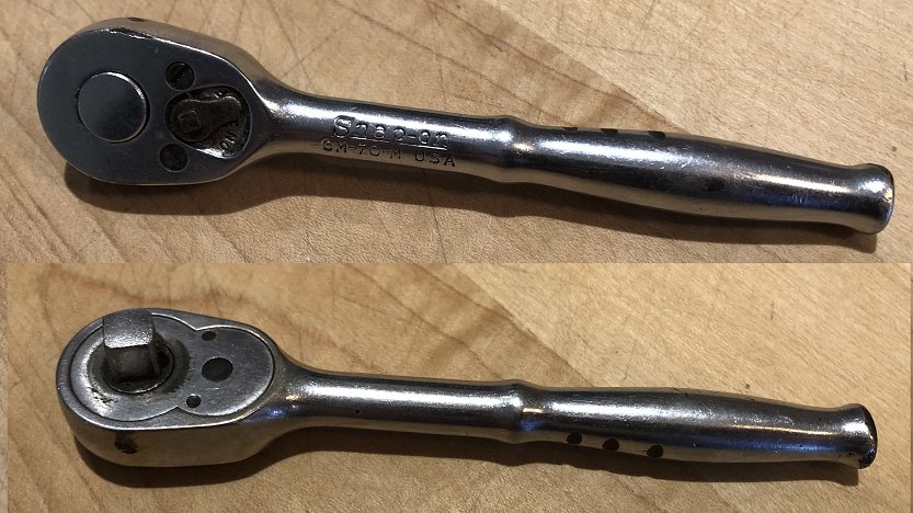

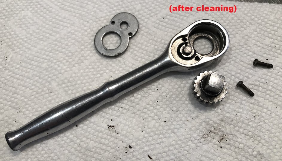

    Oh and in other off-topic news, I've had this little Snap-On ratchet, an awesome road score from the RR tracks by my house that have separated many a tool from its owner and landed it in my stash. It's never really worked right, kicking itself out into a neutral position if I'm cranking hard.
    I know there's rebuild kits out there and I found the kit for models like mine from Snap-On's documentation. But before dropping the $25 on the kit (RKRA930A for this GM70M), I went ahead and pulled it apart to see what I was up against. While the main gear (with the 1/4" end) definitely has some wear as you see in that last pic below, it turns out the interior was just gummed all to hell and I'm guessing that made the pawl stick or not fully seat.
    So I got some PB Blaster, scrubbed the hell out of it, blew it out, then threw some Super Lube in there and ... works like a champ! No more sticking while throwing torque on it. I thought Snap-On was lifetime warranty, I'd kinda hoped they'd just send a kit but whatever.

    find a snap on guy and they rebuild them for free

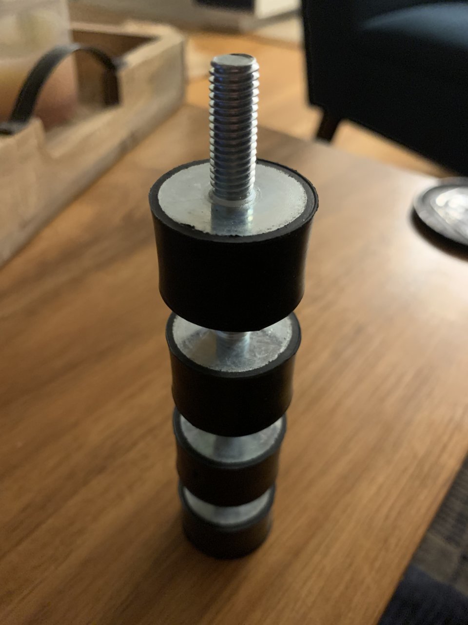

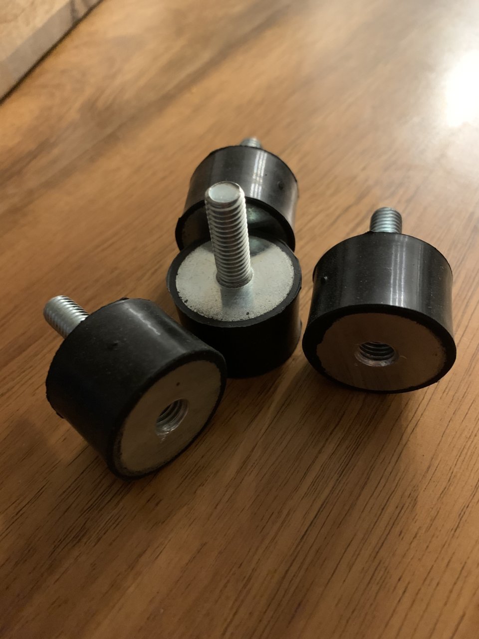

    First attempt at skid plate noise removal involves these isolators. These are the cheaper and fatter ones than I will use if they are promising.

    How bad could it be to need isolators? Is it warped or something? Personally, I'd just small rubber washers around the existing bolts.

    I ran some poly washers between the bolts. It was horrible. Sounds like a ball joint with no cup liner. As we speak, I'm looking at some cool bushings that are likely better than this style. They provide buffer for the bolts and between plates. But it's going to be trial and error. I've been running without the middle plate this week and Im not going back to that noise I had.

    I give my 1/2” ratchet this treatment about every 3 years or so. Seems to get sticky with crud and it starts doing the same thing. Pull the circlip, clean, lube, pop it back together and it’s good as new.
