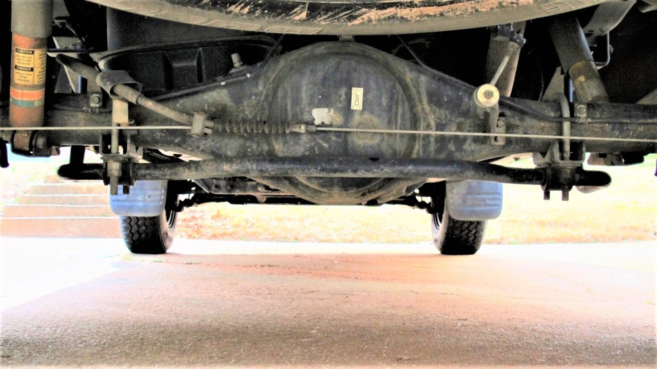

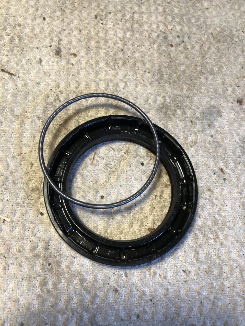

  5. May 28, 2020 at 12:46 PM
    #2765
    Professional Hand Model
    #14878
    14,993
    Fred
    Hand Protectors
    Never realised there was a spring behind the ‘Oil Seal’ on our rear axles. This is the crappy NAPA Seal (AKA Dorman) that came with the ‘kit’. Their NAPA website shows a picture of a different seal that looks OEM. I would have not put this NAPA part in based on feel alone but never saw the parts as they were delivered to the Stealer. Anyways the OEM Seal supposedly has a spring behind it, as well. Tech learned an expensive lesson.

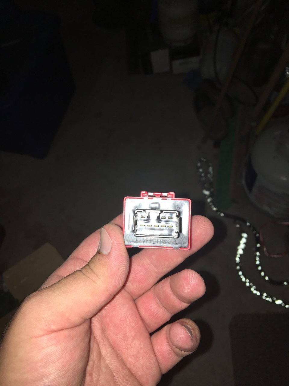

  7. May 28, 2020 at 2:49 PM
    #2767
    #14878
    14,993
    Fred
    Hand Protectors
    Spoke with Diode Dynamics today about their Relay and some of their bulbs. Their website states that their relay is for non-daytime running lights, but should work on our Tundras. Their Relay has 8 pins and the rep said if mine looks like theirs it should work. Do not want to wrestle this thing just to find out its not going to work.
    Does our OEM Relay on 2002 have 8 pins? @Tundra2 @FrenchToasty @empty_lord
  8. May 28, 2020 at 2:52 PM
    #2768
    FrenchToasty
    Sep 15, 2019
    #36156
    18,504
    Mo
    The SoAz….. big surprise
    Bone stock
    On my 06 it’s 8

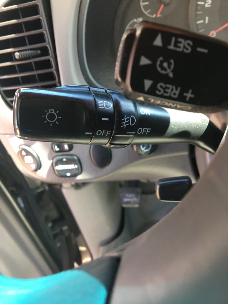

  9. May 28, 2020 at 2:54 PM
    #2769
    #14878
    14,993
    Fred
    Hand Protectors
    Do you have daytime running lights? Mine are on the actual headlights on 2002.
  10. May 28, 2020 at 3:07 PM
    #2770

  12. May 28, 2020 at 3:21 PM
    #2772
    FrenchToasty
    Sep 15, 2019
    #36156
    18,504
    Mo
    Bone stock
    I don’t have that option on my stalk

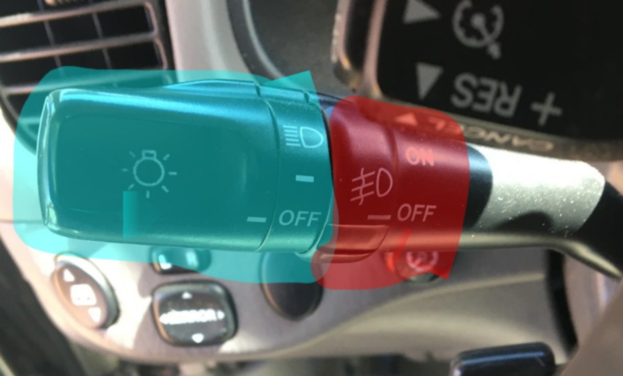

  15. May 28, 2020 at 3:36 PM
    #2775
    Tundra2
    Tundra2 Zoinked
    Feb 10, 2019
    #25875
    12,446
    Noah
    Western Kentucky
    Again with @FrenchToasty's photo.
    Highlighted blue is my option the stalk
    Highlighted in red is not an option on my stalk. Assuming that this is the foglights? Since I do not see it on the left side of dash in background.
    If thats the case then no, my truck does not have that option.

  18. May 28, 2020 at 3:57 PM
    #2778
    #14878
    14,993
    Fred
    Hand Protectors
    My stalk does not look like that. Thanks for the pic.
  19. May 28, 2020 at 3:59 PM
    #2779
    Tundra2
    Tundra2 Zoinked
    Feb 10, 2019
    #25875
    12,446
    Noah
    Western Kentucky
    Thank @FrenchToasty. It was his picture I borrowed for editing.
    Your stalk looks like that minus the fog switch?
    If so, mine is the same then. No DRL on my truck. Lights are off completely if the switch on stalk is off.
  20. May 28, 2020 at 4:09 PM
    #2780
    Rex Kramer
    Rex Kramer Vinyl Spinner
    Apr 9, 2017
    #7181
    6,612
    Georgia
    2002 4.7L RCLB 4X4 2007 5.7L RCSB 4X2
    The Hellwig rear anti-roll bar that I installed on my 2002 back in 2003 is installed with the end links mounted to the frame ahead of the axle, the new bars are mounted up similar to the TRD bar with the end links behind the axle. I asked Hellwig about this... here is their answer.
    From Hellwig: They just wanted to change it not sure why... they both work great it was about 8-10 years ago.

  21. May 28, 2020 at 4:12 PM
    #2781
    #14878
    14,993
    Fred
    Hand Protectors
    Ends up I won’t need to do this Relay change up after all. My OEM horns came in but only one works. There is a H and L horn. I was planning to do the H in conjunction with my 2 originals.
    Since it was broken, I put the Low horn on and the sound is slightly louder but not worth me buying $50 in LEDs and $60 in a Relay. Can’t say I didn’t try.

  27. May 28, 2020 at 5:45 PM
    #2787
    jImmegart
    jImmegart Second Youngest tundra owner in the west!
    Apr 8, 2019
    #28798
    930
    Jonah
    California
    2003 Tundra TRD Sport
    FN Counter steer type X w/ 285/70r17 Geolanders JBA y-pipe and pro street 6000 muffler 2.5 king coilovers w/ total chaos uca and custom 2.0 king rears Skidrow front plate TRD Sport package W/ Factory rear swaybar and LSD
    weird. i have a factory rear sway bar and I was always curious if other trucks had the same mounting I have on my axle but Maybe they welded them on just for sports
  28. May 28, 2020 at 5:48 PM
    #2788
    Rex Kramer
    Apr 9, 2017
    #7181
    6,612
    Georgia
    The factory Sport bars have a mounting system that is unique to 1st gen Tundra... mine is a Hellwig bar.
  29. May 28, 2020 at 6:15 PM
    #2789
    jImmegart
    Apr 8, 2019
    #28798
    930
    Jonah
    California
    Im familiar with hellwigs but not yours. I was more referencing mine because I was looking at your axel for the mounting points.
  30. May 28, 2020 at 6:26 PM
    #2790
    Rex Kramer
    Apr 9, 2017
    #7181
    6,612
    Georgia
    Interesting... Can you post a wider shot that shows most, if not all of your bar and end links?
