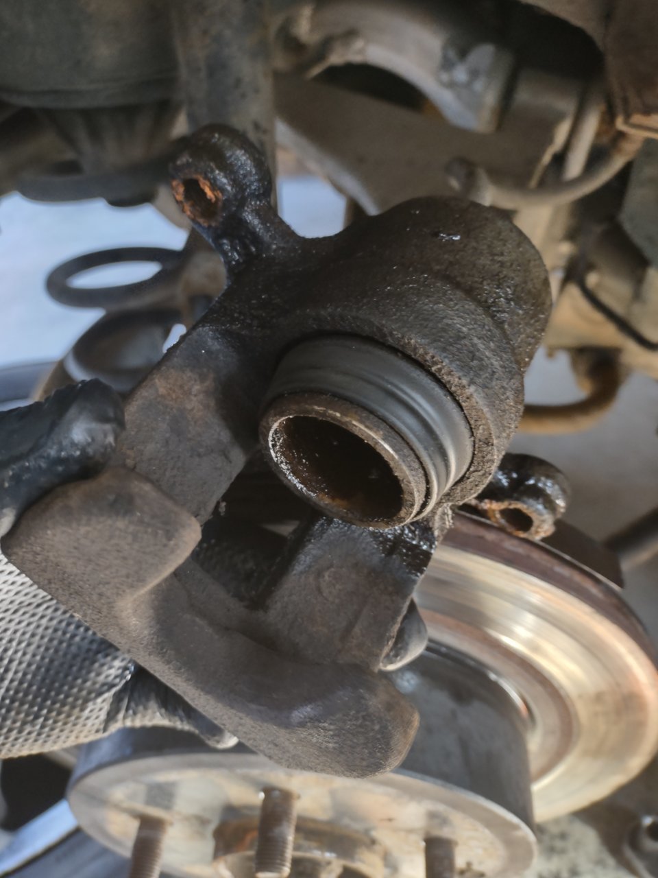

    My buddy is stopping by so we can look at the rear brakes on his Infinity G35. Good call since I'm clearly the Brake Guru :D
    Anyways, it sounds like he has a caliper sticking. Is there a way to fix without replacing so he can at least get home? He's 100 miles from his house.
  13. Feb 6, 2022 at 7:53 AM
    des2mtn
    Jul 1, 2020
    #48721
    4,429
    SW
    2004 Black DC Limited 4x4
    Tonto cover
    Put a c-clamp on the piston and push it back in. Cut the squealer off on the brake pad. Not going to fix the sticking but it'll get them home.

    As soon as he hits the brakes, won't the piston expand again?

    If it's sticking bad enough to notice I'd slap a new one on there if it's easily available. 100 miles that puppy will be hot enough to cook the bearing if it's dragging bad.

    Yes. You could try greasing the slide pins but that's not going to help it if the piston is sticking.

    I dont know about g35’s, but find a manual. Nissan (maybe 240sx) had a funky screw in caliper piston back in the day.
    but yea, pull it apart, clean the piston and bore, and hope for the best.

    Try cycling the piston a few times to see if it sticks again. If you see rust and crap on the outside of the piston where it enters the caliper, clean that up.

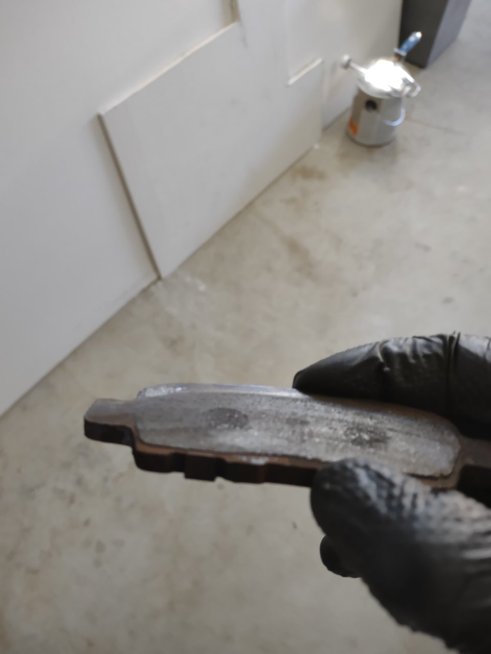

    His outer pad is gone. His inner pad has a lot of life left. I suspect these are the original pads on this 2003 with 150k.

    Wow, he must not be big on maintenance then?
    So, the piston side pad has plenty of life left? Odd

    We can't get the piston to collapse at all so we're off to buy new pads and caliper.
