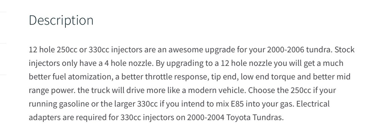

    The missing piece of understanding for me is which Specific Vehicle are these Injectors made for?
    I’ve searched the part number given off that site the other night and it goes nowhere. My injectors had no part numbers on them. They say Denso, but no id.
    For everyone else: They do not add horsepower, unless you add the Exhaust System per the experts. But why do the injectors if the exhaust is the key to HP?
    Going into these injectors:
    1) I knew per the seller I wasn’t gaining HP (unless adding exhaust).
    2) It would make the truck shift in a more modern way. That lazy transmission feel is gone when it should downshift coming to a slower speed. You can feel the downshift with the 12 hole injectors. Throttle response is better (very slightly).
    3) I wanted to clean my existing 4 hole injectors, but the 12 holes were the same cost.
    Didn’t realize until the other night these 12 hole injectors have a better design/build quality. I’d love to find these on the Denso site. Its a hard find.
    bmf4069 and NUDRAT[OP] like this.

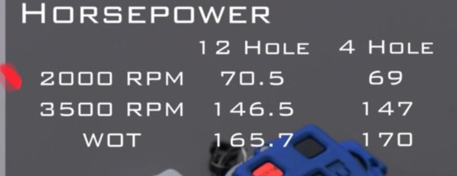

    The shocking part of that video for me was the fact that the 12 holes actually performed worse. I wasn't going to be surprised if the 12 holes only offered a very slight advantage but seeing them actually perform worse makes me want to avoid them. I wonder how much new OEM injectors are.

    How worse? At 2000RPM they are slightly better. This is where most of your driving is taking place.
    At 3500 they are slightly worse. Not much driving goes on in that range (for very long). Same with WOT.
    The video does not take into account:
    1) The tuning memory of the ECU on the vehicle. Was the vehicles battery disabled and reset?
    2) The tuning of our trucks ECU vs. their test vehicle ECU.
    I am not arguing against their HP test, but its an incomplete picture. The 12s offer a big advantage in modern drivability feel.
    New Injector costs are through the roof!

    I wonder if the advantage you are feeling is because you went from 17 year old(possibly clogged) injectors to new ones? I bet that's why a lot of people feel like they are gaining something. Good point about 2,000 RPM. I had forgotten that.
    I'm going to bet they had the battery disconnected for over 30 minutes while they swapped injectors, but anything is possible.

    You can buy 12 hole blue injectors from an online Denso store that ‘fit’ our trucks for about $110 each last I checked.

    Those questions I can’t answer. I’ve Guinea Pig’d plenty of stuff and try to help people save money. Maybe someone can step up and buy or find these 12 holes source? Oside Tiger?
    The 12’s injectors aren’t recco’d for ‘gains in HP’. They are for drivability. The video proves a false negative premise and is incomplete. Yes there are no HP gains, but the drivability is changed.
    Flow rates are the same hence why I have said do not do these for MPG. Go back and look at our MPG thread. Over time its the same MPG for me.
    From Dirty Deeds. This is his description. All the boxes are ticked and confirmed true by me after install. Amazing how that video only provides a narrow slice of the bigger picture.
