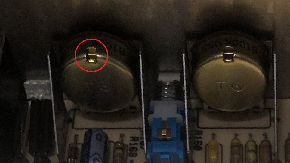

    If you can do any of the shit you do on your truck, you can handle basic electronics refurbishment.
    Doesn't matter if it's a guitar tone knob, switching selector knob on a head unit, potentiometer for pitch control on a turntable. If it's audibly creating scratchy or poppy sounds when you turn it, or doesn't seem to make solid contact, Deoxit D5 is king. You don't need to understand how the electronics work to use it, just a quick millisecond-shot into the spot where the metal in that dial/switch makes contact, then 5-10 full-sweep turns of the knob will fully clean it out and restore service for another 5-10 years. 75% of the time, any vintage hardware I get, I get it cheap because a fuse is blown and/or the knobs simply needed a contact cleanout after decades of use.
    Don't get me wrong, CRC's contact cleaner is great too. But Deoxit has a full suite of products (D5, F5, G5) I feel like everyone needs.
    For potentiometers ("pots"), they're often sealed but there's an access port to squirt into. Deoxit actually has a video to explain the process (link below) and do a variety of other things. It's so freaking easy, and you can get the products at your local Guitar shop, electronics shop, or buy online. D5 is generally for metal-on-metal. G5 and F5 are a bit more specialized, F5 is for crossfaders and slides, to clean and lubricate, and G5 is supposed to e for gold contacts IIRC. If you're going to get any of the trio, D5 is essential, and if you use anything with a slide, whether a crossfader on a mixer, a pitch slide on a turntable, or similar, get a can of F5 also.
    Deoxit's video collection: https://caig.com/deoxit-d5-instructional-video-1-cleaning-pots/
    I always feel like this guy does a great job of showing my typical method:
    https://www.youtube.com/watch?v=Ke1Whqzw13Q
    A lot of pots I deal with look like this from behind, and you'll just need to put a quick shot into this divot/hole, then turn the knob lock-to-lock several times:
    chrisb[QUOTED] likes this.

    That's pretty close to what the selector looks like from behind. I'll order up a DeOxit (probably from big gurrl) and give 'er a shot.
    Queuing up that video right now.

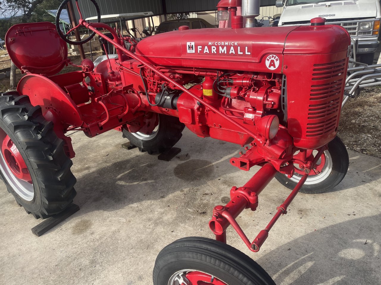

    Tractor cleaned up nice. Got a couple fresh tubes of grease, and some 30wt and 90wt.
    think im gonna pull the oilpan and have a look before i change oil. Just to be safe. I know this thing hasnt run in 10 years.
    anyone have any experience in coating the innards of gas tanks?

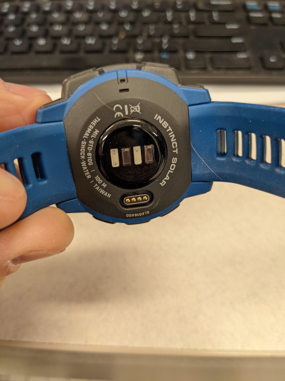

    I've opened one garmin (watch, not sure if you're talking an older nav device?) and tried my best to re-seal but ended up with water intrusion. It was a cheap way to get a new battery but in the end, I wound up buying new anyway.

    The Garmin has four little contacts on the back that are basically in constant contact with your wrist when you wear it. Then those same four contacts are expected to not oxidize and make great contact with the charging/data cable. I can assure you they don't make as great a connection now as they did when it was new several years ago.

    @chrisb maybe a photo of what you're talking about? We're not discussing the IR LED for HR are we? That's just light as far as I know, but since I own the plastic poor man's fenix maybe I'm short some cool tech. Curious...

    And we're talking the bottom 4 metal contacts? Those are for charging, yes? Not for use on the skin as a sensor? The led emitters and receivers in the center I assume are for HR like my 935 just probably better.

    What I have observed on my 935 is that the charging cable has spring loaded pins and they get stuck/gummed up with time. Replacing with a new charging cable resolves that. Wiggling it till they spring loose works OK sometimes. At least the charging cables are relatively inexpensive compared to other designs. I've burned through one already, have 2 in rotation right now between different charging spots.

    Correct for charging. Not sure what yours uses, these ones kind of snap into the watch so we may be talking the same thing from different directions.
    Looks like this.

    yes, that's mine as well. I'd recommend a new charging cable as a first step, unless they have increased in price significantly. You can also look inside the smaller end and see if a pin is depressed. Prying it out works once but then it tends to get stuck again later. Could try some D5 on that part specifically if it helps? Maybe that was the idea, rather than the pin on the watch? If so that could make sense as the charge cable doesn't get exposed to water like the watch part does.

    Mine is just like that except black and the lasers are in a differently shaped array.
    All correct.
    Mine is the same.
    My watch still works a-ok. I wear it almost every day. I'm sure I'm just irradiating my blood with the lasers. :D
