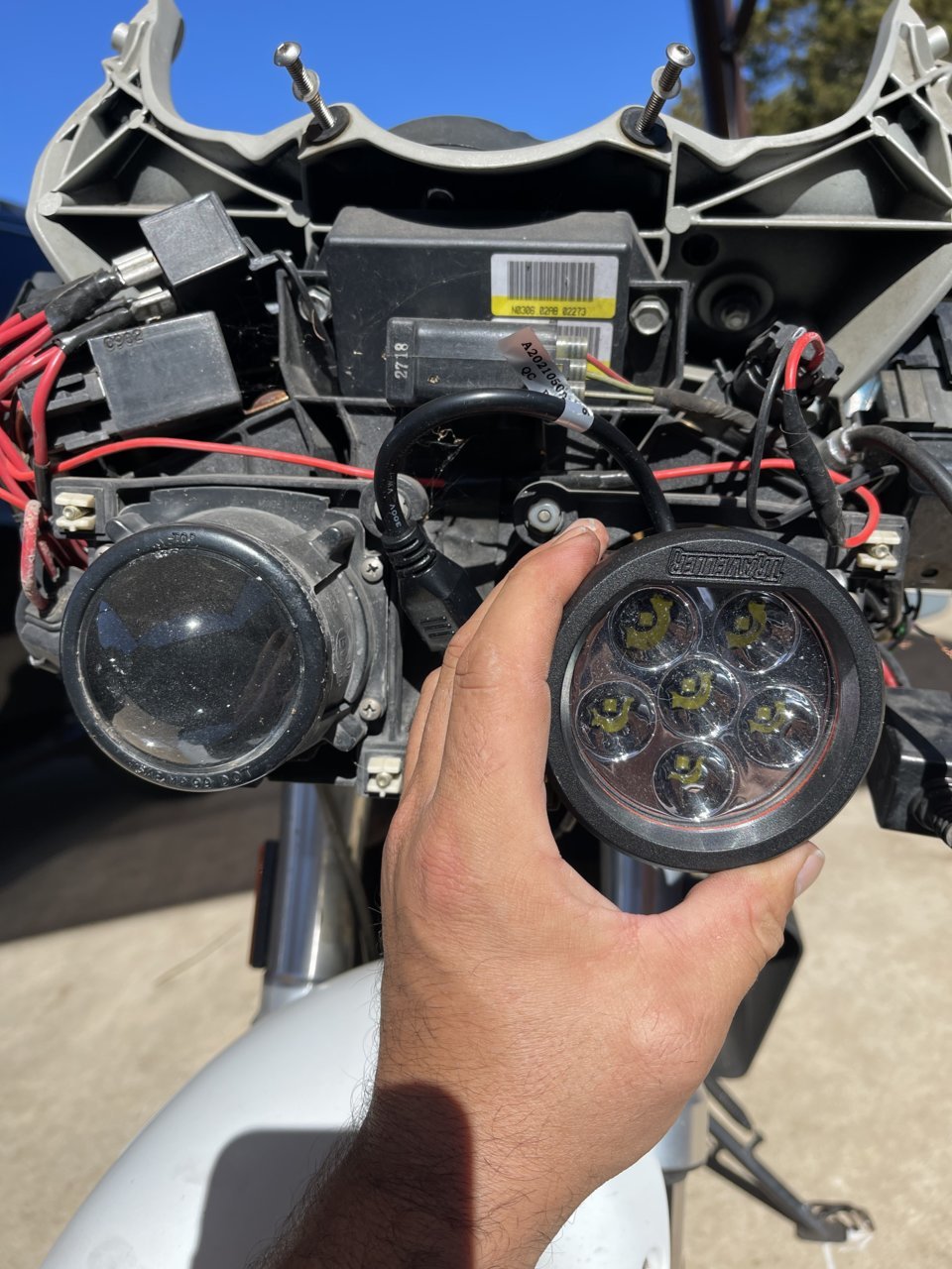

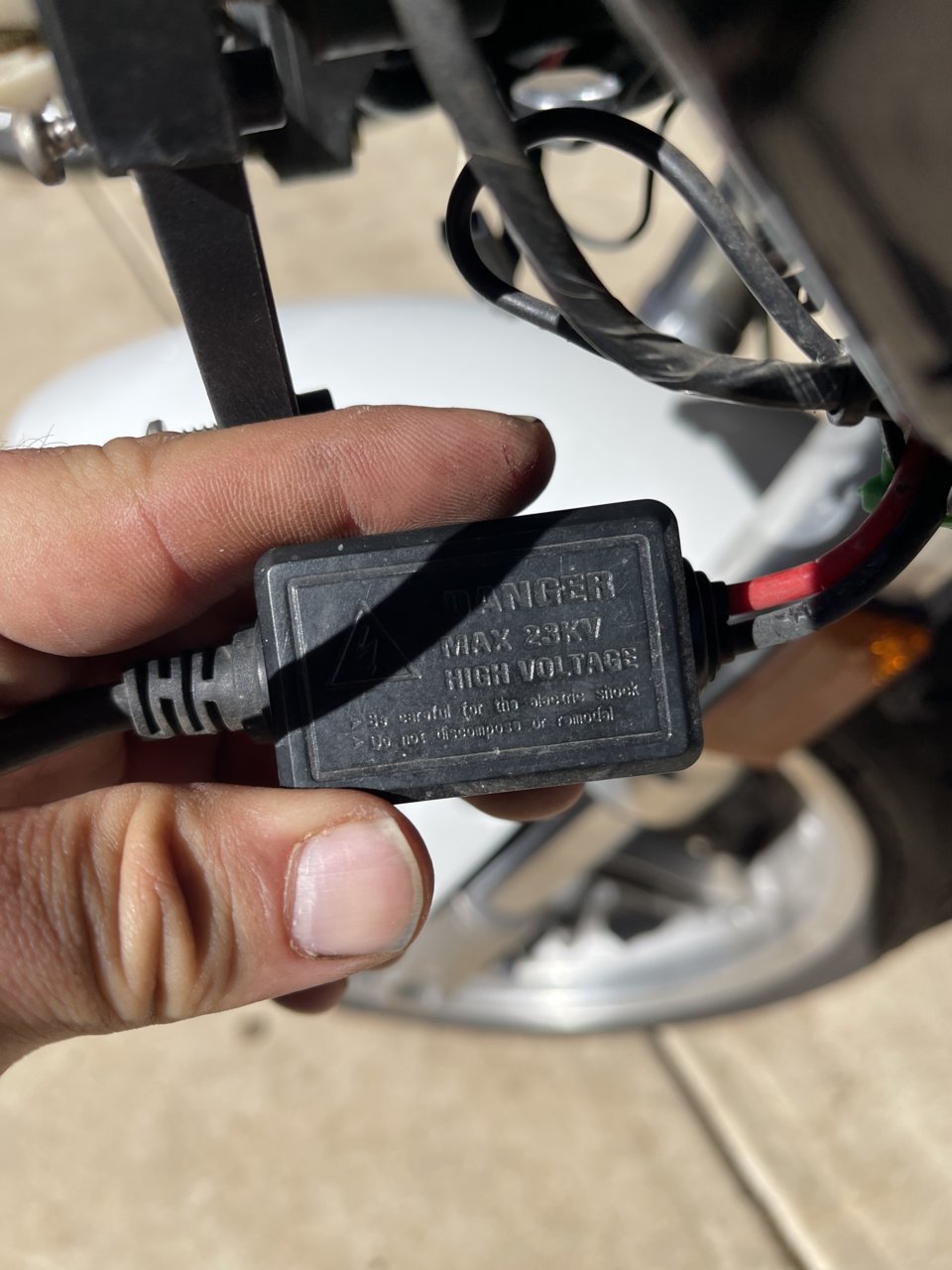

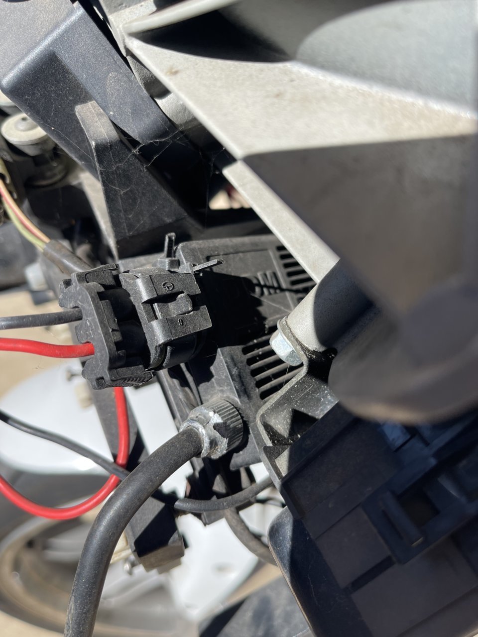

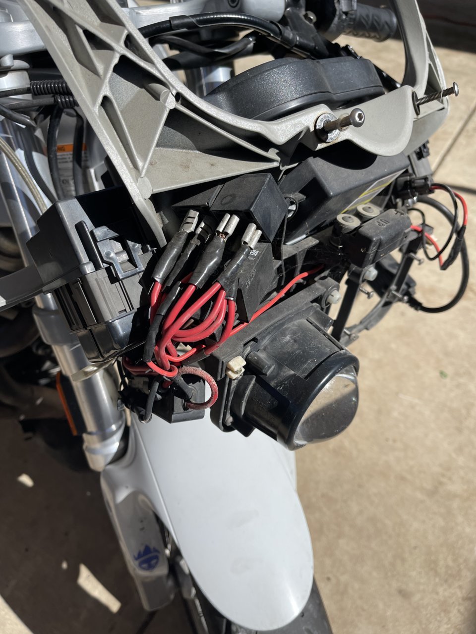

    Ok moderate sized eff going on over here. To anyone who’s done HID’s what am i looking at here?
    i ve got a pair of boxes for each light, if i remove em, the fuses and relays should be running 12v?
    80DB5B97-F26C-4BCD-A36A-664ABDFFE619.jpg 998B0A3B-D16C-4952-9839-792D97342E09.jpg

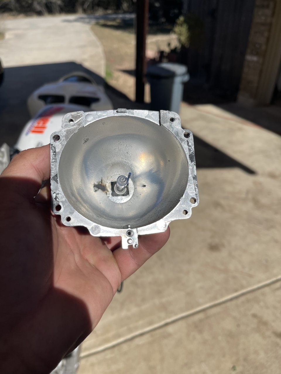

    Im wanting to replace the factory hid’s with led’s. But whoever messed with these lights before changed all the wires to red wires.
    my brain just glazed over when i saw this. And i should give my finger more time to heal, cause fingertips and needlenose are the name of the game in here.
    gonna try to salvage the HID lens housing. If i can melt the e6000 i’ll just put the lens back in (now that i trust the glue), maybe touch up the inside reflector with chrome paint…
    but would be cooler, right?
    I dont ride this bike at night. Ever. I will sleep in a parking lot, but preferably hidden in some woods. Headlights are for inspection purposes only.
    they take forever to ‘warm up’ so i cant really use em as flashers, and were dim as hell.

    The rectangular boxes with multiple wires going in/out look like relays. They open/close a circuit when power is applied/removed. Normally people will direct-wire power to those (or sometimes to the device being powered) and use a switch to open/close the power flow to said device.
    If you take more pictures, I may be able to figure out. @daveeasa may be able to help too. Need to see where the wires go back to.

    Yeah, I saw those photos and I'm thinking go upstream to an H4 connector and yank everything downstream?

    Yessir. Is The flat ddm box with the co-ax looking cable above the light bracket or the 23 kv box im holding is the ?ballast?
    i can ditch all that and should be down to 12v coming out of those relays? I’ll measure with my meter before attaching, just trying to understand whats happening.
    is the 55w stuff or whatever fed the stock system gonna blow through these 30w leds? Should i add a fuse?

    Yep. That would be the general M.O. of a ballast/transformer.

    You edited after I replied, so going back here.
    Do this: Pull the relays down. Look at the wiring. Black should be going to ground, one red should be supplying 12v constant (maybe from battery), one pin will likely read nothing, one should lead to the ballast. One wire should trace back to a switch somewhere, and that switch will have 12v going into it somehow.
    Trace back where the 12v constant is sourced from, it'll be the pin that reads 12v even when the key is out, vehicle off.
    Next, unplug the red wire going from the relay out to the ballast. Test that newly exposed pin on the relay with the IGN off and on, and with light switch on/off if present. Should only register 12v. Correct?
    If yes, that's the wire you want to run to your LED and we can talk about how to surgically remove the ballast.
