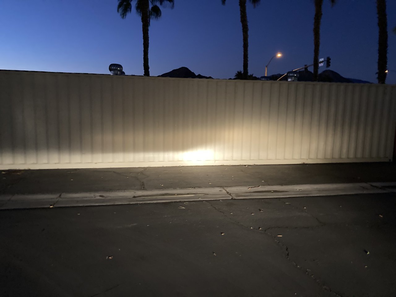

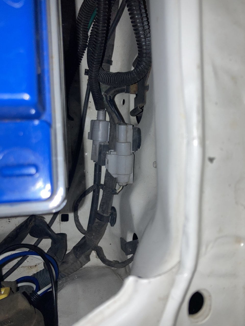

    Did some aiming this morning. Hard to really see the other side for a reference but I adjusted up a bit. Not sure if there is any left - right adjustment on these OEM units. Definitely brighter with the fancier bulb and harness.
    One surprise for me was that my DRL’s fire the low beams rather than high beams. I thought they would run the highs. So stock side you can tell a difference with low beams vs parking light as it’s perhaps 9V vs 12? But with the relay side there is no difference, low beam is always on.
    C82234DE-0289-4B20-A216-A8F3D08F8ED3.jpg B6CA065D-0874-49C1-B874-2DADC4393F49.jpg

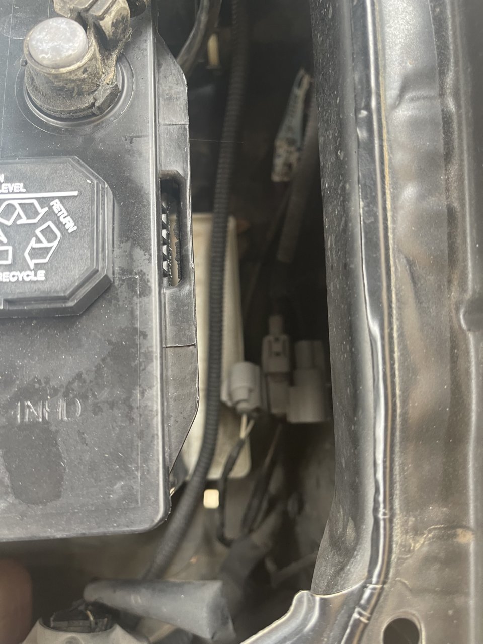

    Did someone say one of these connectors might be the DRL and could be unplugged?

    i dont like leaving my lights on while sitting in a drive through, or idling in a parking lot.

    Thanks, I’ll give that a shot.
    Planning the DRL signal to VLED switchbacks in the corner spots. So that will be great if I can kill two birds with one stone on that. I’ll try to find these specific connectors for my own T harness and for others to have waterproof caps.

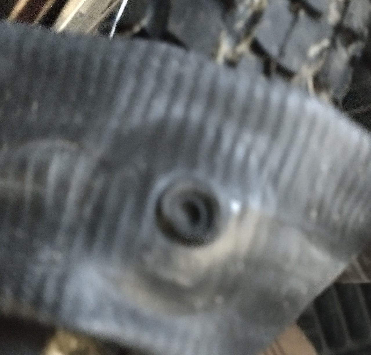

    Bicycle help - because I know we have bicycle snobs on here ;-)
    I was given my 1st mtn bike, nothing fancy but I don't need fancy.
    I do need air in the front tire however & came across something new & unfamiliar technology to me. There is no valve stem?
    It looks like it pulled out & the stem could be replaced? I only know of valve stem is part of the inner tube.
    What black magic is this & what do I need to know when I shop online (any preferred sites?) or go to local bicycle store?
    yeah - sorry, not such a fancy photo as Noah @Tundra2

    Can’t see too well but many mountain bikes are tubeless nowadays. That photo looks like a tube to me though. Tubeless MTB is just like a car only typically sealant is used to handle punctures.
    I mail order everything, even cables and housing. Bike shops are totally OOS and many have weeks of backlog on work. It’s nuts. For most stuff, eBay is a good option. Just make sure you know your wheel size. It’s printed on the tires.

    That just looks like a bad tube where someone tore the stem off.
    Unless you have bought a rather expensive bike from the last ~5 years or so, tube tech hasn’t really changed. Bikes now are running tubeless just like vehicles.

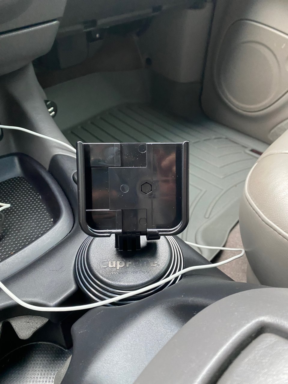

    Installed the CupFone as well that I picked up Friday. A lot better than just putting the phone it in the cup holder. Added another Knipex tool to my collection (the 8" needle nose).

    yes, it's a tube I pulled out of the tire. So maybe I just need a new tube - a simple/odd stem failure. It's nothing fancy, a Raleigh.

    The rim determines if you can run tubeless. You can always stuff in tubes. I always replace any Schrader with presto. Just confirm diameter and tire width. Printed on the sidewall.

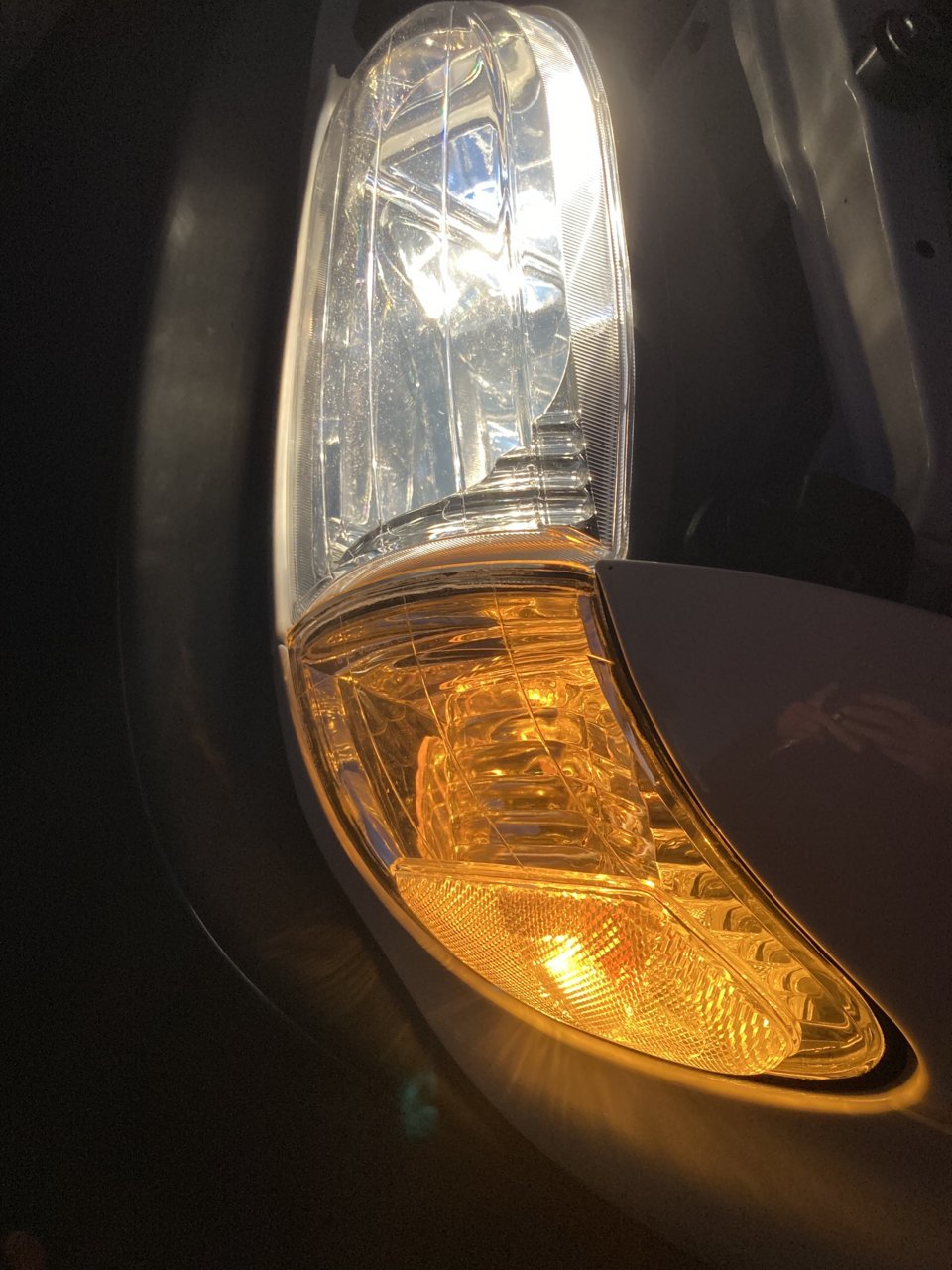

    Ok so this seems to be effective at killing the DRL but also may disable my parking lights? Either that or I blew a fuse.

    Ok definitely screwed on parking lights. Rats. Also out a brake light. Looking up parking light fuse location.

    Figured it out. Depo bulbs shorting power to ground on my parking light circuit. Swapped to OG front bulbs. Snapped a tab on the depo corners and blew two fuses figuring it out.
