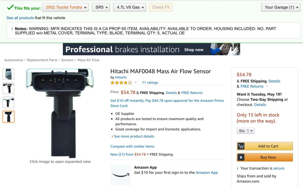

    Found the OEM MAF Sensor by Hitachi on Big Gurrll. For future reference.

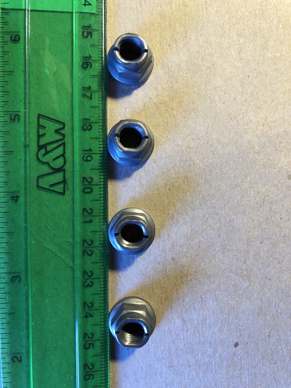

    Spend big bucks on these today. Anyone who guesses what they are will win The Professional Hand Model POTB (Pat on the Back) Award of the Week!

    Split beam nuts

    I meant to say what are they are for (as in what part they secure on our trucks)?

    They look like the nuts holding my headers in place

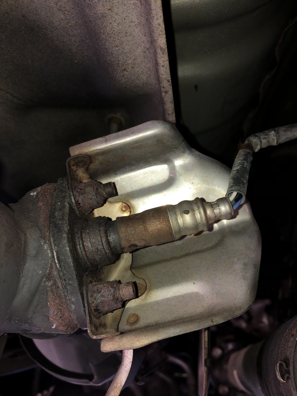

    They might actually be the same ones, but I got them for the rear o2 sensors which are held in place with 2 bolts each. Not sure how old the sensors are but inner gaskets look to be corroding between the sensor and bung mount. Gonna replace both rears and clean things up.

    Gonna replace the front o2 sensors, as well. They have about 30-50k miles on them and are aftermarkets installed by others. The rears may be the originals?
    Big Gurrll has the Denso fronts for $43 each. Rears are $47 each (Denso). Gonna get all 4 talking the same language.

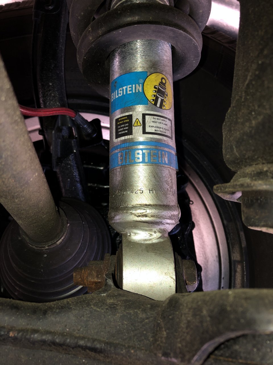

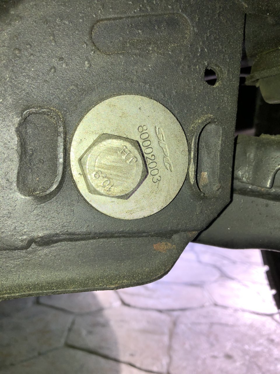

    Confirmed my Cams Bolts are SPC. Also, snapped a pic of the Billy Bob part number for @revtune to confirm newer shock?

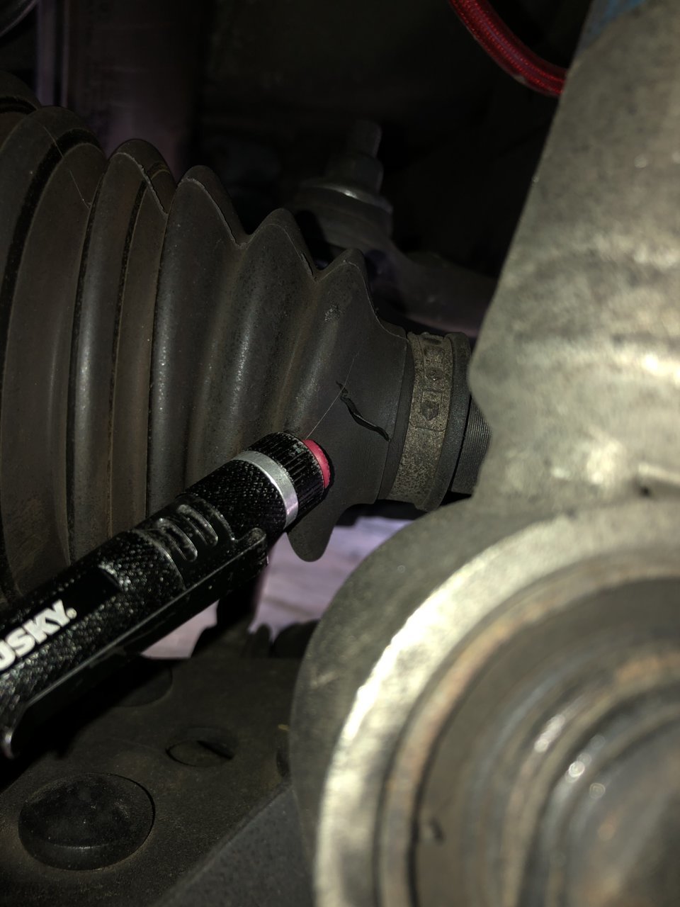

    My almost two year old aftermarket front axles has a tear on the pass side. You guys were right about these shit products.

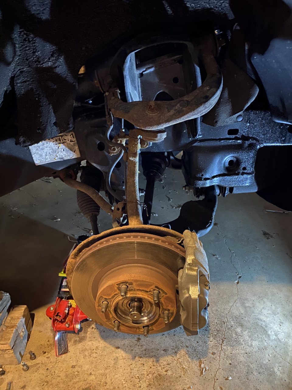

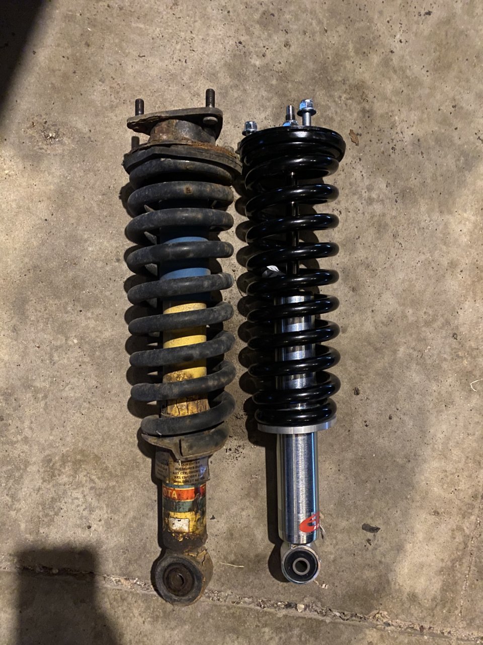

    Working on the shock install today. This thing has just fought me left and right. The right side bolt wouldn’t come out so I had to unbolt the axle and LBJ, the drivers side, I can’t get out all the way because one of the studs on top is stripped out so it just spins inside the spacer. Gonna have to dremel it out since it’s too tight to get anything else in there.

    That's frustrating. You just installed those in 2018 right? Probably don't even have 20k on them? Time to replace with something better.

    Just about 20ishK on them. They are making a ‘scrubbing squeaking’ sound. When I drive with the windows down a slow speeds and pass some parked cars or a fence, the sound reflects back. I first noticed it last fall when the Valet was grabbing the truck.
    Sounded like poop. I also heard a tinkle sound which ended up being a loose cotter ping on the axle hub. The pin was tinkling on the loose nut cover which I corrected when doing the front brakes upgrades. I spun the axles without the calipers on and know for a fact this ‘scrubbing’ sound is coming from the axles.
    In retrospect: I should have had some quality axles ready for the front end rebuild guys ahead of time, but didn’t plan it properly and got what I paid for. :rofl:

    were they reman axles or brand new ones? the aftermarkets use shitty boots. if theyre Remans you can replace the boots yourself with quality parts from Toyota

    Grab a case of patience from Big Gurrll if your 02 fronts are located where 04's are. There were a LOT of MF's(muthafuggars) floating in the air when doing my fronts....Rears were easypeazy !

    I hope this isn’t the case, but most likely will be. These are the 3rd sets as the first were a factory recalled and the seconds went bad. These thirds are maybe 4-6 years old. Soaked them 3 times yesterday. Will soak again today.
    Did you use that offset crows foot socket on both? I bought one just in case.
    Plan B is cutting off socket tip and running a standard socket up with extensions and wobble bit and laying down the law with my 1/2” Milwaukee Impact. Anyone recco not going this way if it comes down to it?
