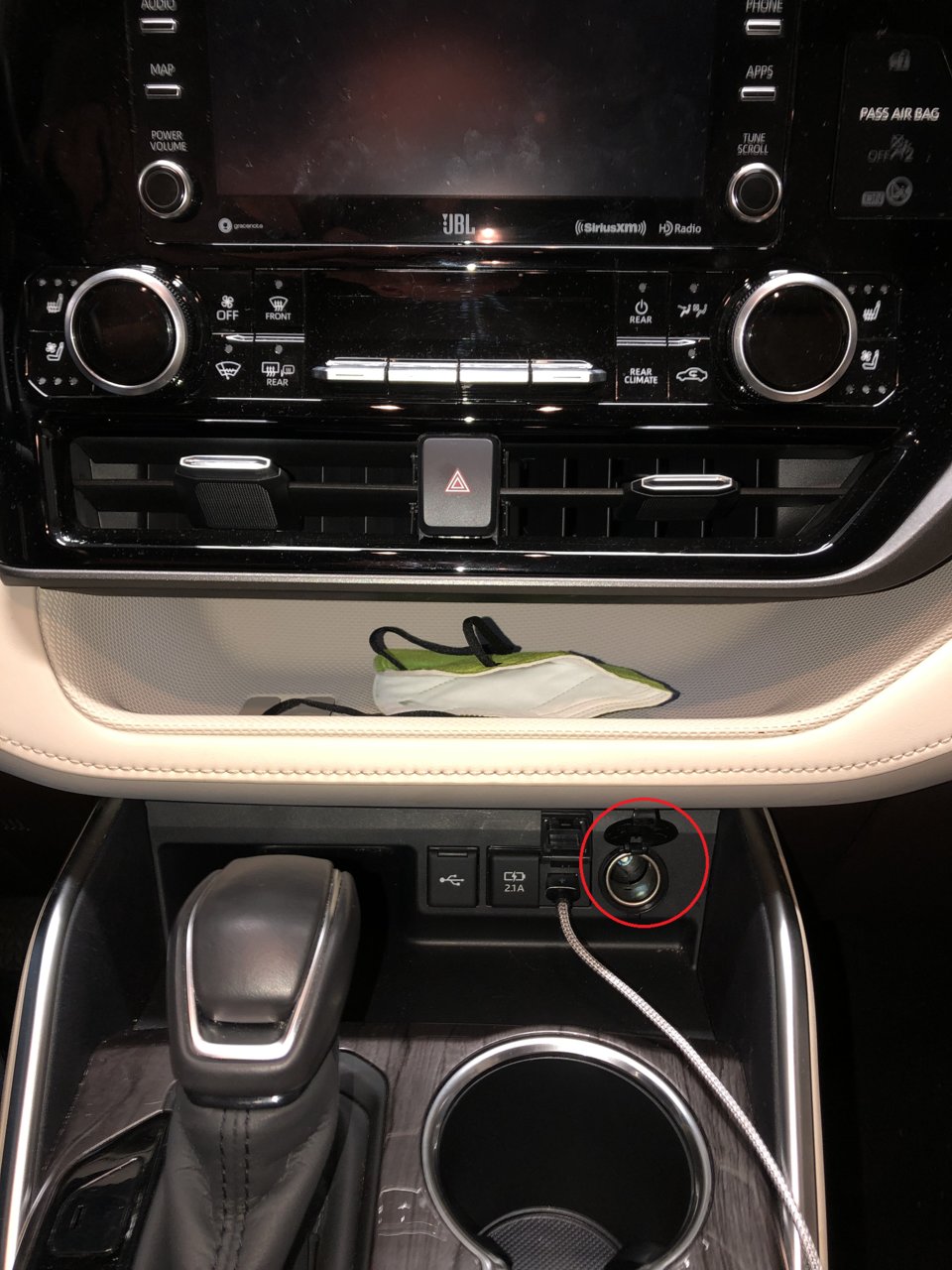

    2020 Highlander Hybrid. Front tire was low and I was showing my wife how to use the tiny Viair inflation pump to power up. Didn't realize pump was ON. Plugged into front 12v cig lighter in the dash/center console. Pump turned ON for less than 1s, then OFF. I know the cig lighter outlet was working before, we were charging phones. Now it's dead.
    I checked the fuse bank under the dash. There's only one power outlet shown - a 15A - tested the microfuse for continuity, it's fine. Not sure if that is even the source for that specific power outlet, but there's no other PWR fuse in that bank of 30ish fuses. I can't seem to find FSM for this vehicle. Owner's manual didn't even show the cabin fusebox location.
    The USB outlets right next to the cig lighter are working fine. I'm assuming they're on a diff circuit. Anyway, any thoughts if you have them are appreciated. I'ma keep hunting in the meantime.

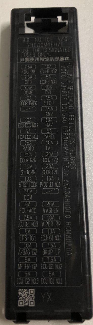

    Ok, I'll go back and check in a sec. Let me snap a pic of the fuse cover, maybe the name will jump out. There's about 50 ECU fuses in the list IIRC.
    I have literally zero microfuses, need to go to LAPS to get more tomorrow.

    Ok @empty_lord here it is.
    I checked P/OUTLET NO1 fuse, 15A, it's good.

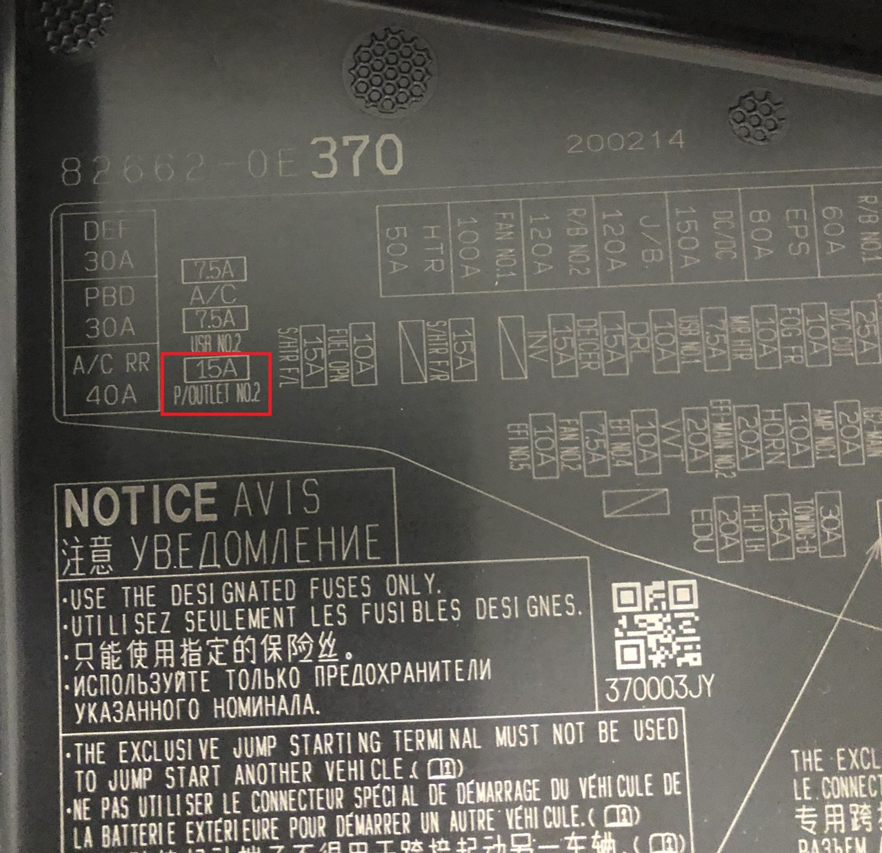

    Assuming you used the outlet on the passenger side of the dash center stack, p/outlet number two feeds the number one outlet. (I can’t make that up…. Number doesn’t matter I guess?) the p outlet #2 is under the hood

    Engine bay fusebox only has three fuses. Those are all for various headers (spray nozzles etc.)
    The outlet that's not working is circled:

    Yea it’s under the hood. There’s a couple fuse blocks. The fuse your looking for is next to the alt wire inside the main fuse block on the driver side, by then brake fluid

    Thanks - I only expected one fuse/relay box under the hood - totally overlooked the other box thinking it was related to the air intake/filter box. Duh. Got distracted by that crazy MC and - maybe that's the power steering reservoir under/behind it?
    Anyway, you're right. 15A listed as P/OUTLET NO2, 15A also, and it was definitely blown. Thankfully two microfuse spares, but only 20A. Off to LAPS tomorrow to get a mix.
    Swapped in a 20A temporarily just to test - all good. Thanks again!
