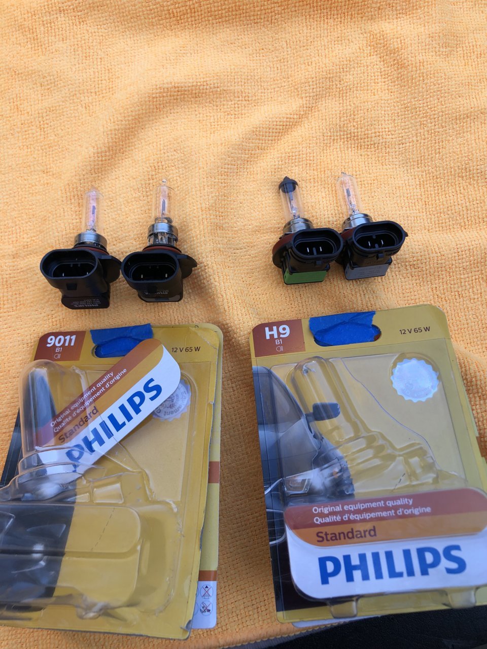

    getting ready to upgrade lighting in two honda vehicles doing the H11 to H9 and the 9005 to 9011 hir. unsure how the upgrade will go on the factory projectors? on the one but the other honda has not projctors and should go well having already done one in the past. makes a huge difference.

    the one h11 to h9 (low beam) conversion i did was significant. just trim a tab(s) off the the new bulb to fit.
    h11= 1350 lumens at 55 watts
    h9= 2100 lumens at 65 watts (yes 10 watts higher but no worries on burnings the house down)
    i’ll be using philips bulbs on amazom
    the hir bulb (high beams) is same wattage but the special coating disburses more light with same watts.

    gots the bulbs all trimmed up and all dry fit an such.. waiting for night fall. will post pics because you like them..
    correcting an error i mentioned above the conversion i did a few months back was 9006 to 9012 hir (low beams).. a very nice light upgrade!!
    tonight is the h11 to h9 (low) and 9005 to 9011 hir (high)

    Eh only slight improvement. worth $80 in bulbs.? neg. no pics due to not much there there.
