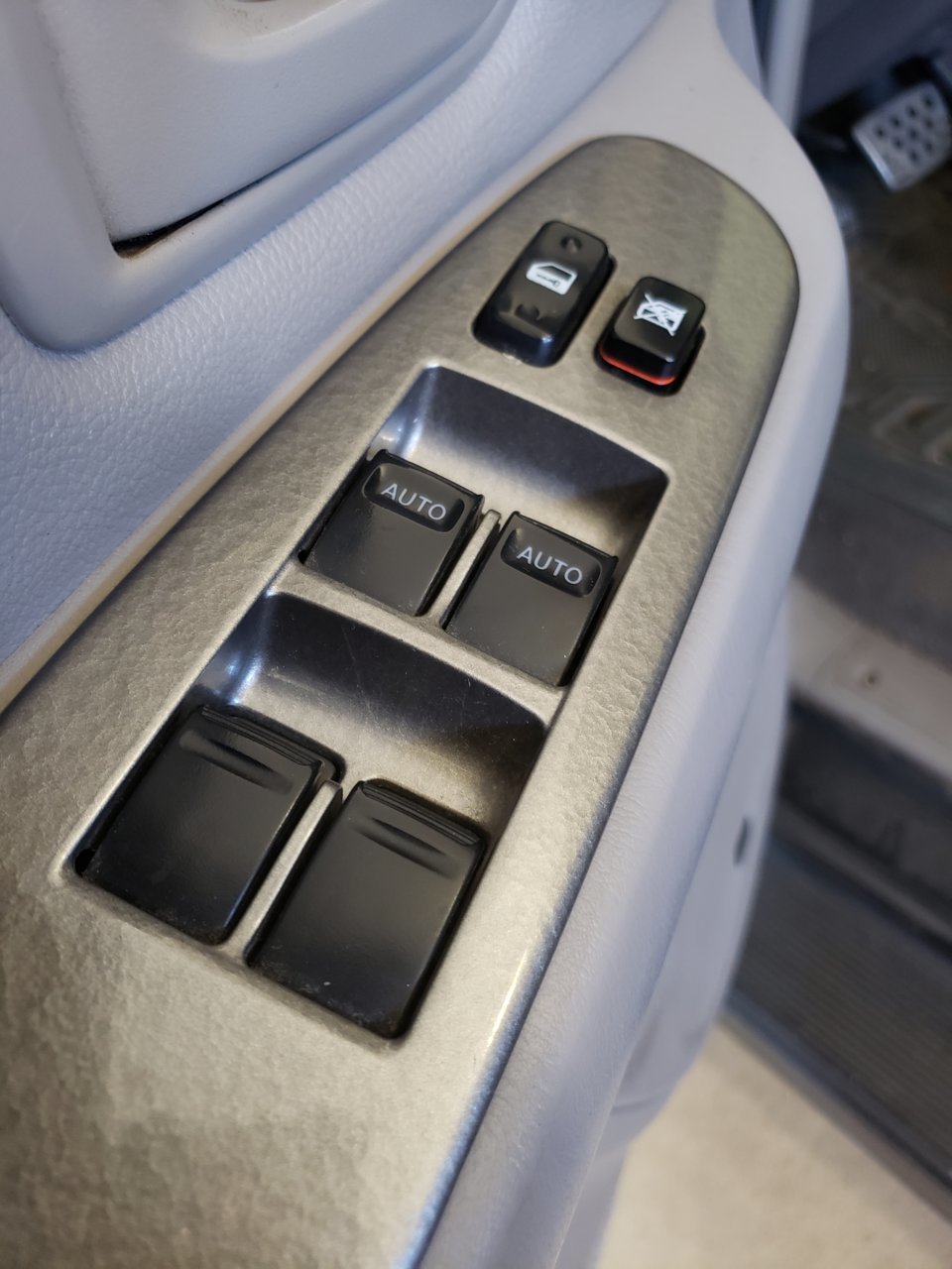

    Lol, It doesn't have the auto up/down or it doesn't have the lighted switches?
  9. Nov 29, 2021 at 11:53 AM
    des2mtn
    Jul 1, 2020
    #48721
    4,663
    SW
    2004 Black DC Limited 4x4
    Tonto cover
    Automatic passenger window (and rear window) switch. Driver's window is the only automatic one for down. My switches are backlit I'm pretty sure.

    Mine is auto-up, manual down on Driver. Passenger is manual-up/down. Our 2012 Highlander was same, driver auto-up only, all other windows were no-auto. This has been a constant for most vehicles I've owned.
    Imagine my joy when we picked up the 2020 Highlander and all 4 windows were auto-up/auto-down. I really enjoy that.
    I assume the motors are the same in our passenger and driver doors, so auto-up surely must be supported, and it'd be as easy as cannibalizing a few auto-up/down switches and swapping them out on the plate?

    I wonder if getting parts from a Sequoia would work. Are the rear windows on them automatic as well?

    The sequoia will for sure work for the DC and add auto up/down to passenger window, but not rear windows.

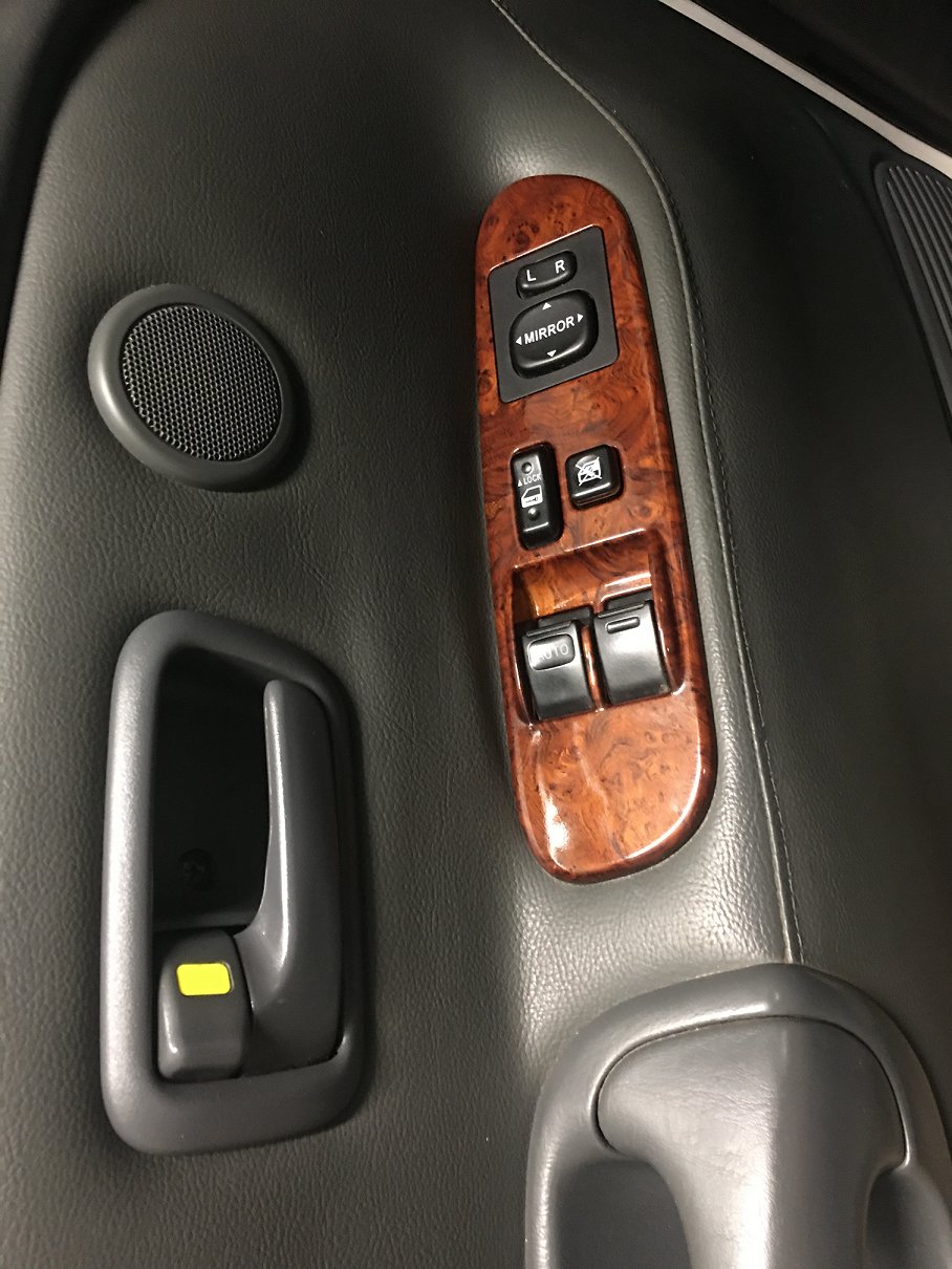

    Here's my AC switch plate, just to complement that. Now I'm really curious how tough it'd be to swap over controls from a squaw or DC....

    You guys think it's just the controls which enable auto? Or more to it than that?
    Also, I got a mirror heater switch, though I only have 2 spots so now I have to decide if I'm maybe doing a single seat heater switch and a mirror heater switch or two seat heater switches. And this all hinges on getting my fog lights to the stalk (or maybe switch-pros is just f'ing easier for fog lights)
    I wish that dude could 3d print us a few more oval blanks into the panel, it's got room for them if it were spaced a bit tighter.

    That's good to know. The 100 series LC has all 4 auto window switches. I plan to try to see if this will fit/work soon in my DC.

    The sequoia and DC have 4 switches so I don't think it would fit and from what I remember, it's all one piece.
    A while ago I swapped from the sequoia to the DC to trouble shoot the switch and with the sequoia switch in the DC, the passenger window did auto up and down.
